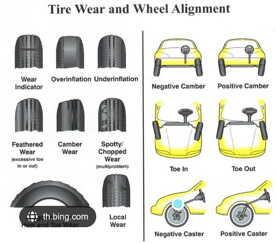

Can you monitor all of the wheel speed sensors and drive in a straight line and see if there is any one of them are off? Any erratic readings?
Also, this may sound obvious but are your tire pressures all the same, and correct according to the manufacturer spec on the door jamb? Also how is your tire wear? Anything abnormal or a tire that has more tread than the other?
A worn bearing or tire as well as a bad wheel speed sensor either from age or excessive resistance in the harness could give the computer mixed information and maybe why it's doing that. Inspect each wheel speed sensor harness for any damage like blistering or it is rubbing through. Also, a tire with too much tread on it compared to the rest could cause an issue.
Just a thought. Want to rule out these things then we can move on from there.
I am adding some images of what to look for in tire wear.
Take a look and tell me what you see. I will be here.

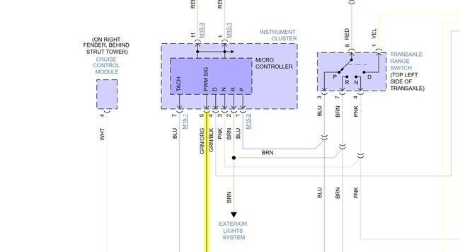

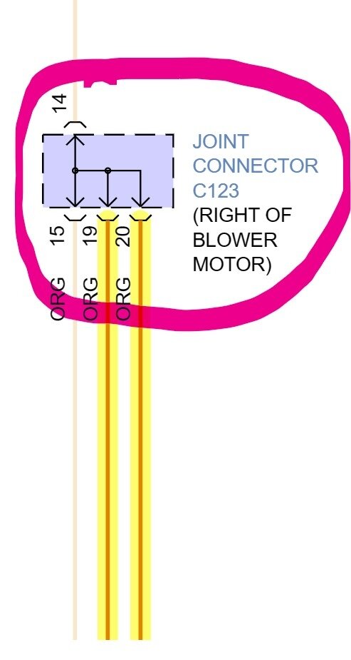

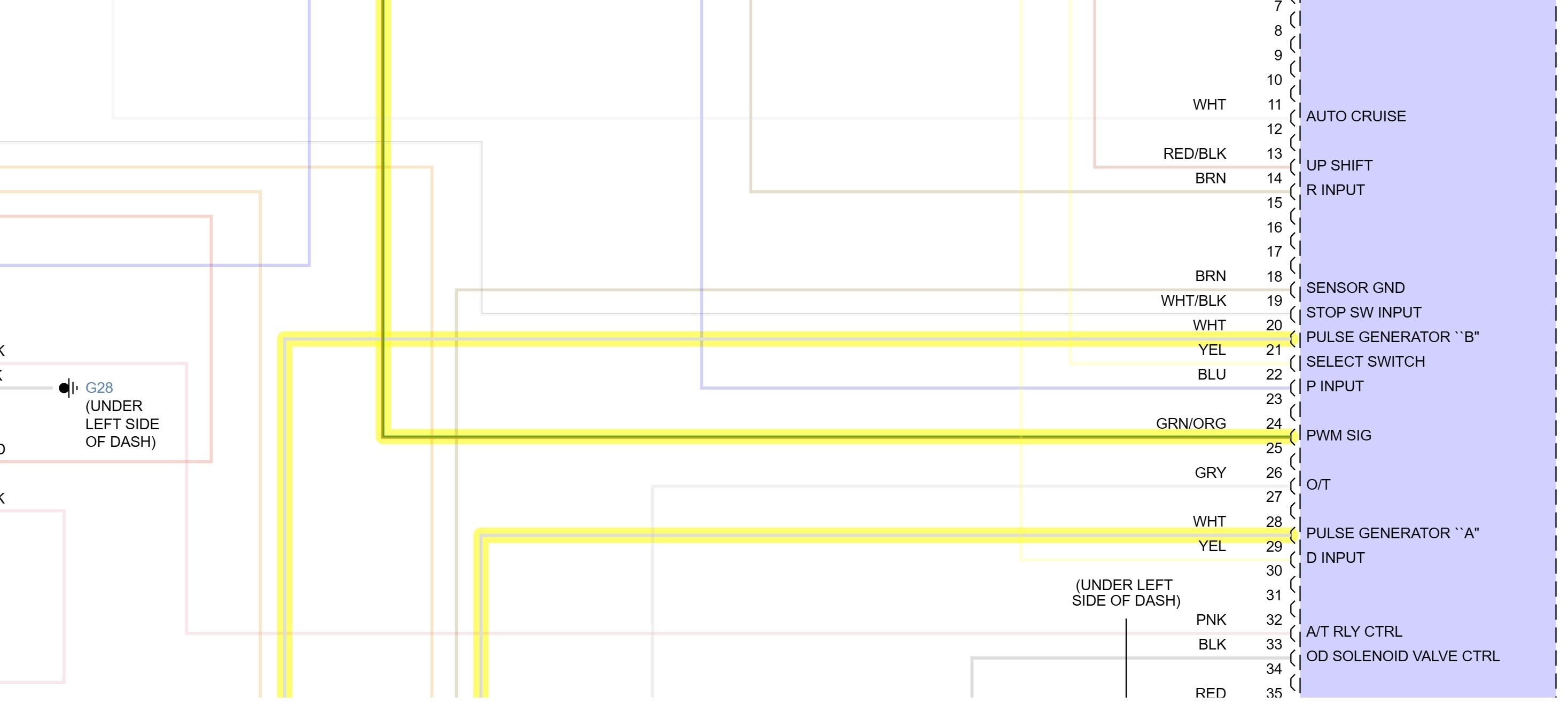

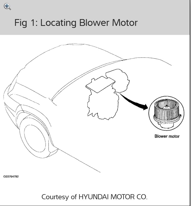

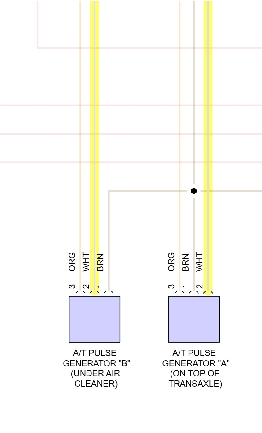

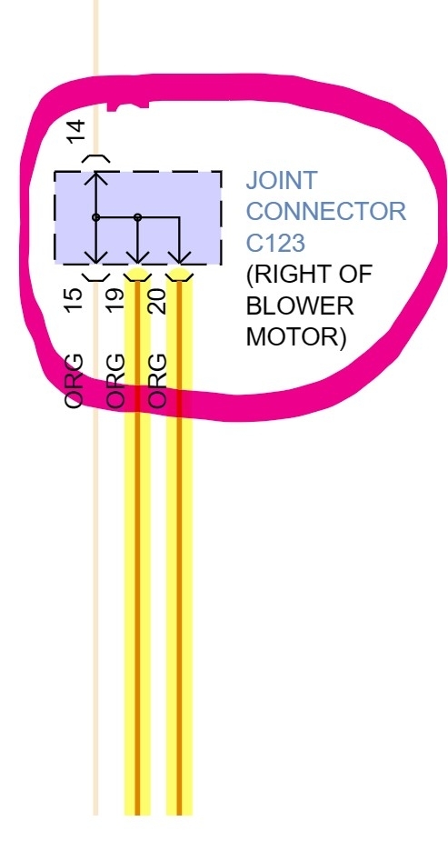

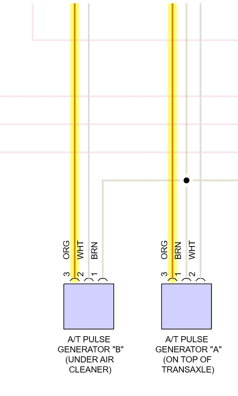

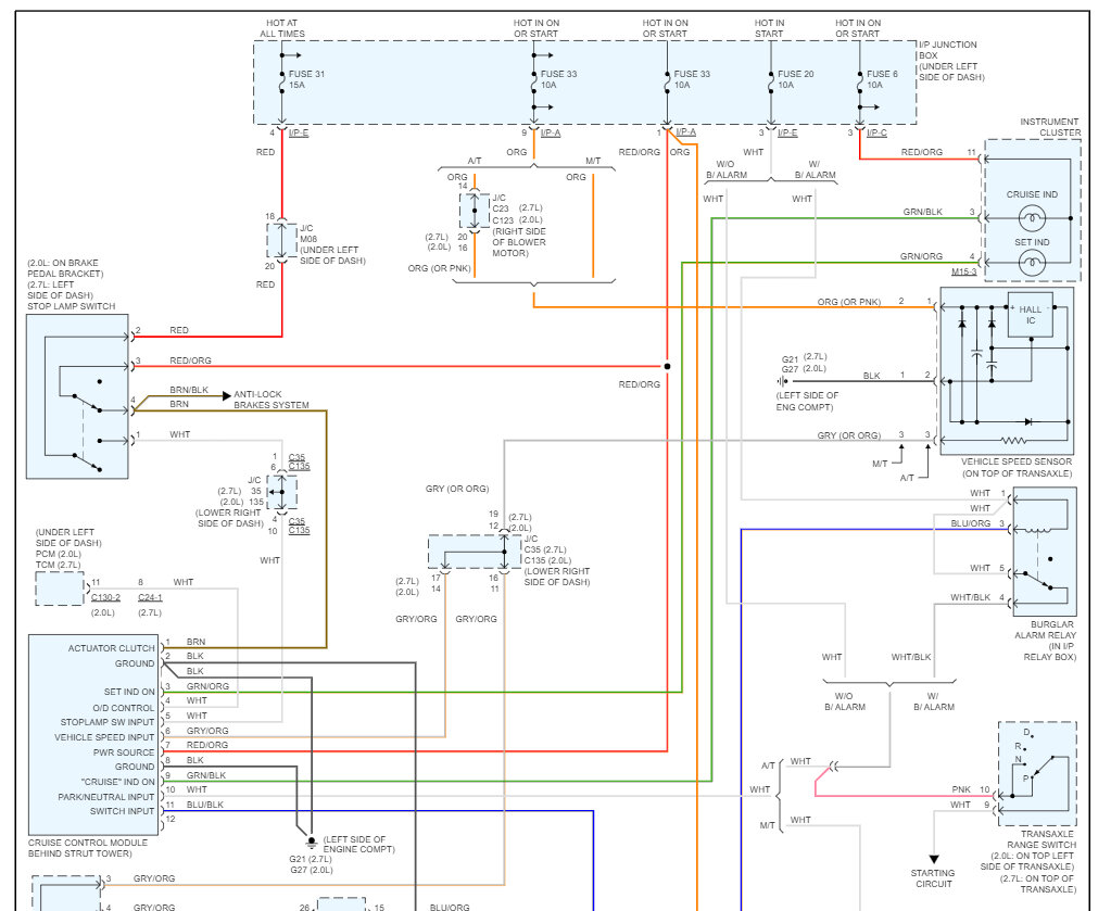

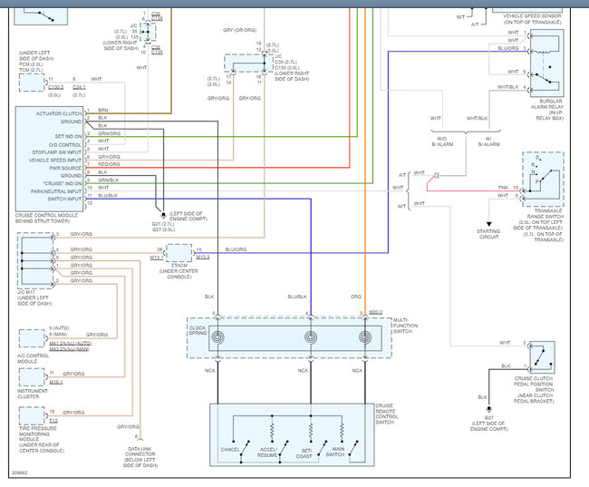

I am adding some wiring diagrams and have highlighted the areas you should check.
First image is a diagram of how the power is sent to the sensors called-Joint Connector C123 (right of blower motor). I would locate this and see if there is any damage or corrosion. Since it is an intermittent issue sometimes shaking the harness can get it to work or act up. Figure one shows you the location of the blower motor. These wires should be orange and send power directly to both A/T Pulse generators or VSS.

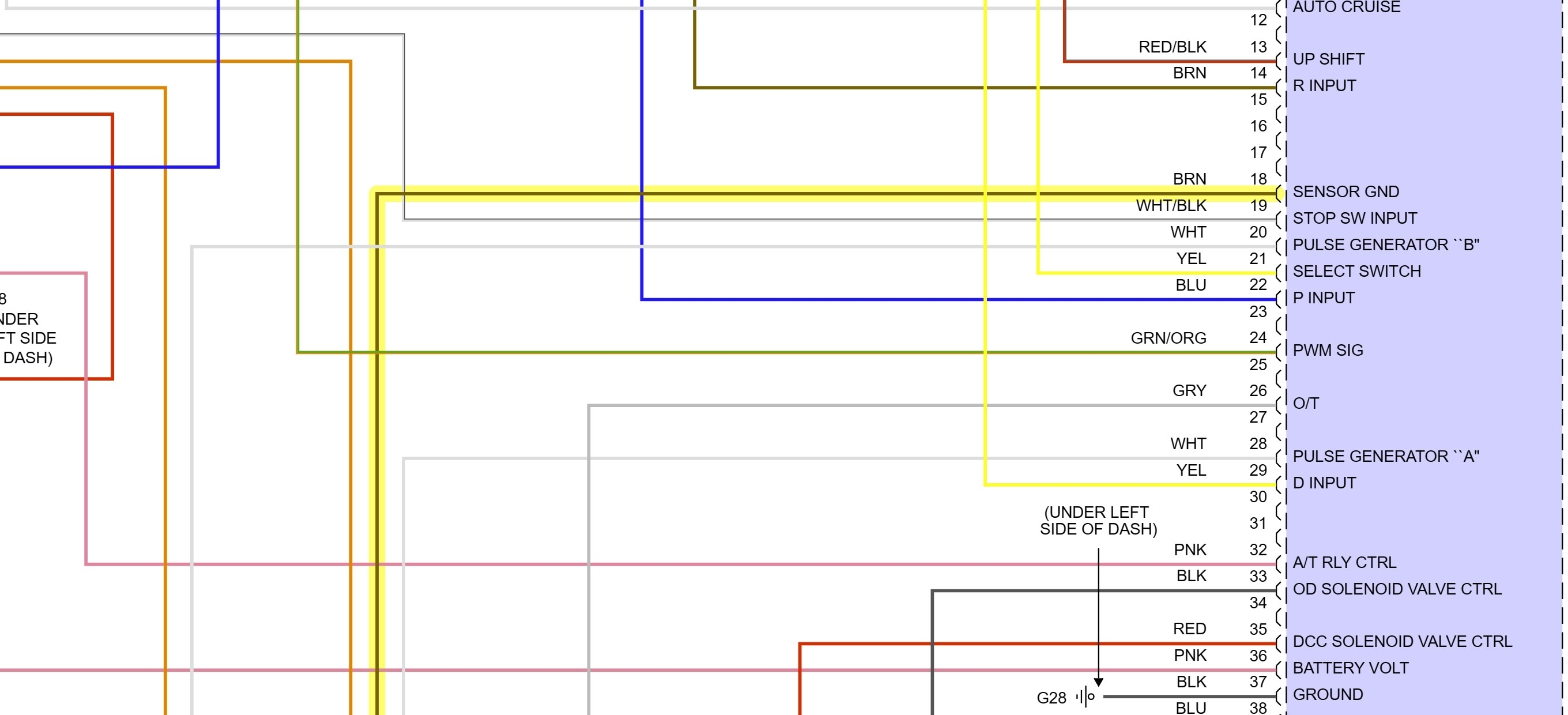

Second, there is a white wire coming from each sensor going into the PCM (Under the left side of dash). Number 20 and 28. I have faded out other wires and highlighted the ones I am talking about to make it easier to see. Check these wires for any damage or rubbing through as well as any corrosion.
Third, pin 24 is a green wire with an orange stripe, also referred to as a tracer. This wire runs to the instrument cluster and supplies the signal from the vehicle speed sensors from the PCM. Check this wire for any damage or rubbing through as well as any corrosion. wiggle the connector while watching the dash and see if anything changes. Unplug the connector and inspect both male and female ends for damage.
Finally, the sensors get ground through the PCM on pin 18 using a brown wire. Check this wire as well.
Make sure to check all connector ends for anything loose and be very thorough. You may have to open the entire harness.
I would especially check for a loose connection at the sensor and at the back of the instrument cluster. A female connector that is opened a little more than it should be might not be noticeable but will cause an issue like this. Also, the harness on top of the transmission and behind the cluster are probably more likely to be damaged from movement of the vehicle as it travels down the road over time.
It's possible only on of the sensor harnesses are damaged causing it to connect and reconnect making the gauge go up and down. Just a thought.
Check out this stuff and let me know if you find anything.
Thank you,
Brendon

Thank you so much for the wiring diagrams. I will try and trace them all and see if I can identify any issues. As for the test I performed. I hooked up my scan tool via OBD2 port. Checked live data while driving the vehicle. The speed showed up accurately and steady on the scan tool. It stayed at 0 on the speedometer. This told me the issue is likely between the computer and the cluster. I assume the wire travels from VSS to ECU than to the cluster. Or does the signal split and go directly to both? I will check the wiring diagram you provided and get back with you. Thanks again

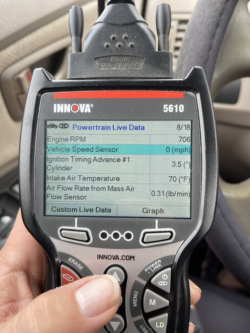

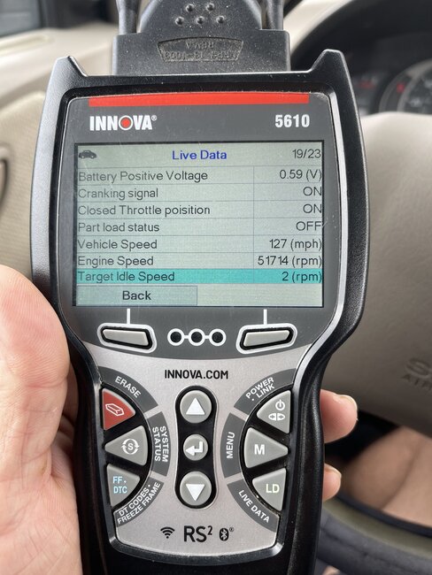

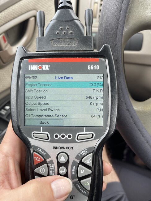

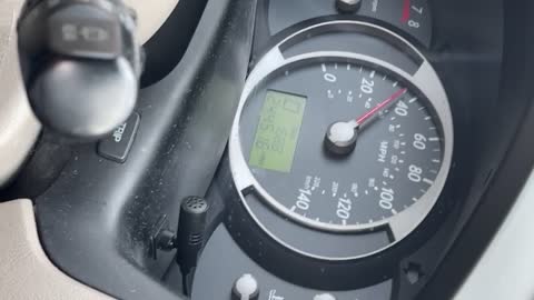

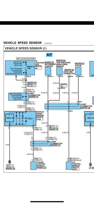

Okay so I did some more monitoring with my scan tool, and I don’t understand something strange. When I go into "Global OBD2" live data it shows engine RPM and VSS accurately. When I go into Hyundai OEM enhanced live data powertrain vehicle speed and engine speed are high. Transmission live data input and output speed sensors are correct. I took some photos for you. This is at idle and not driving. I pulled the fuse to ECU and waited 30min to see if a reset would fix it. It had no effect. The oil temperature sensor stays consistent. Any ideas as to why the live data when in OEM enhanced would be so different compared to OBD2 Live data? Could this have something to do with my issue?

What kind of scan tool do you have? Can you give me the name and model number? I want to try and see what test you can perform with it.
The VSS sends a signal that goes between 5.0v and 0.3v but it happens very quickly. Too quickly to see with a multimeter and possibly a scan tool. You need something called a lab scope or is also called an oscilloscope to see if the signal is dropping out.
So, I am wondering if there is a problem with either the signal the PCM is receiving or the PCM is calculating it incorrectly.
I would check the signal wires from the sensors to the PCM for any damage. If the PCM is getting fluctuating or conflicting signals that would make it unable to make the correct calculations. But if all the inputs are indeed correct and the calculations are wrong it could be an issue with the PCM itself.
It might not have any codes because it keeps resetting itself.
This is all that I can think of for now. I am going to keep thinking from my end and see what else I can come up. Considering the vehicles age and mileage and that most electrical issues are a wire or a connector I would continue looking at the wiring for now.

No, that doesn't make much sense except maybe what Hyundai is using is different than the global parameters. I would have to look into that to be honest. I am thinking that Hyundai is going to be more accurate than global.
When you have a chance send over those pics so I can see what you are looking at.

This was taken when idling. The VSS and engine RPMS seem normal under OBD2 live data. The VSS changes accurately when driving. Same goes with the input and output transmission speed sensors. Under ABS live data it shows all 4 wheel speed sensors and they are accurate as well. However, when I go to OEM enhanced live data it shows my vehicle speed at 127mph and engine RPMS around 50,000rpms. This is at idle. I don’t understand why data is so different.
Mar 11, 2023 at 2:55 AM
BRENDON S
  • 653 POSTS
Hello BDAB68,
Wow that thing is pretty sweet!
I am not sure why it is doing that and found an article I thought you would be interested in:
https://www.vehicleservicepros.com/service-repair/diagnostics-and-drivability/article/21223723/generic-vs-enhanced-data
I am thinking the enhanced OEM is actually catching the issue but the global for some reason isn't.

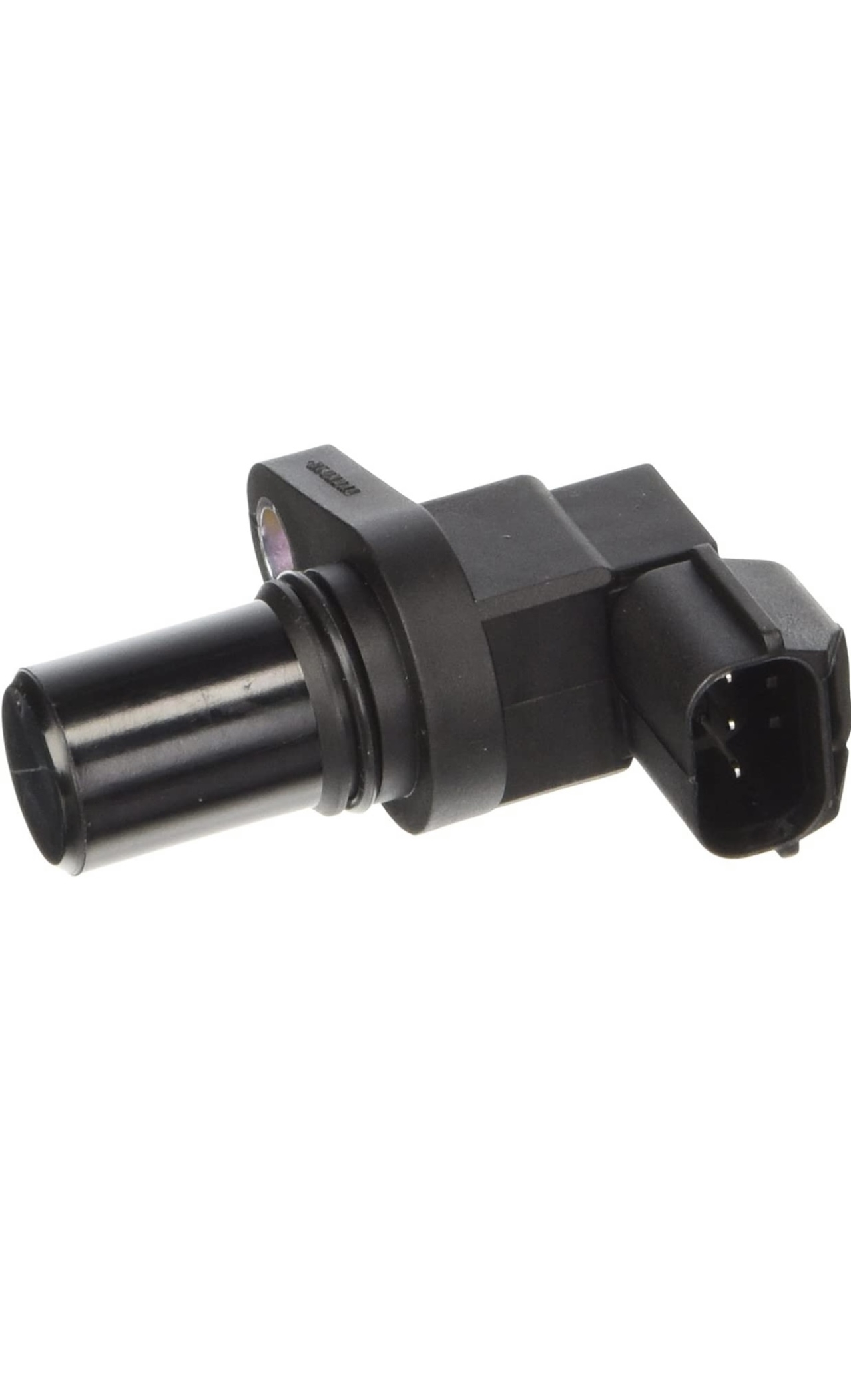

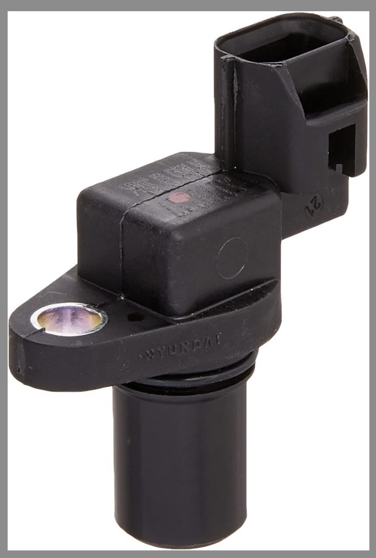

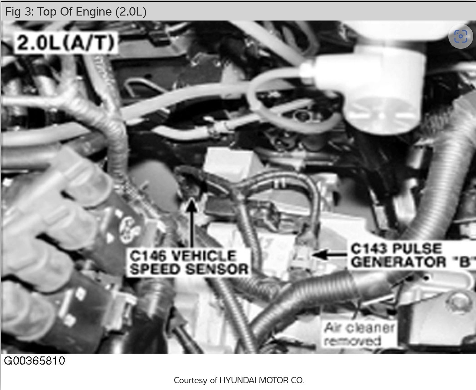

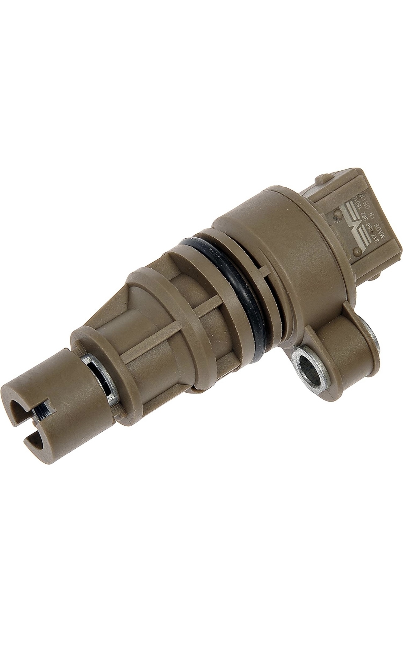

I added an image. Are these the 2 sensors you replaced?
Thank you,
Brendon
Mar 11, 2023 at 4:17 AM
BDAB68
  • 36 POSTS
Yes. Actually, I replaced 3. The VSS that is shown in the picture along with a new driven gear. Also, both input and output transmission speed sensors. Here are pictures of what I replaced. I used all Hyundai parts ordered from Hyundai OEM parts.
Mar 11, 2023 at 4:35 AM
BRENDON S
  • 653 POSTS
Hello BDAB68,
Okay. That's good you used OEM sensors. I always do the same for sensors and plugs. I am going to continue to look through my information and see what we can come up with here. In the meantime, if you find bad wires or any new symptoms let me know. I'm going to study these diagrams and see if I am missing anything.
At least we know the sensors are good.
Thank you,
Brendon

Okay, so more interesting info. Apparently, the scan tool doesn’t pull speed info from the VSS like it says it does. I disconnected the speed sensor and sure enough it still showed the speed on the scan tool. So, I’m back to square 1. I tested the VSS connector and my results I believe show an issue. I’m not good at this so hopefully you can help. First off, I tested the ground. With black probe of multimeter in negative terminal of connector and red probe on positive battery terminal I get 3.5V. With black probe still in negative wire terminal and red probe on what I believe is the signal wire I get 2.5V. On the power supply terminal, I’m only getting 2.78v and I believe that should be 12v. Where do I go from here?

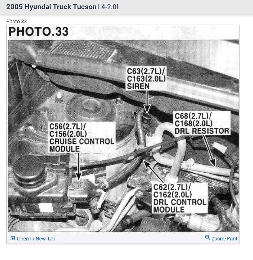

Mar 13, 2023 at 12:52 AM
  • 55,433 POSTS

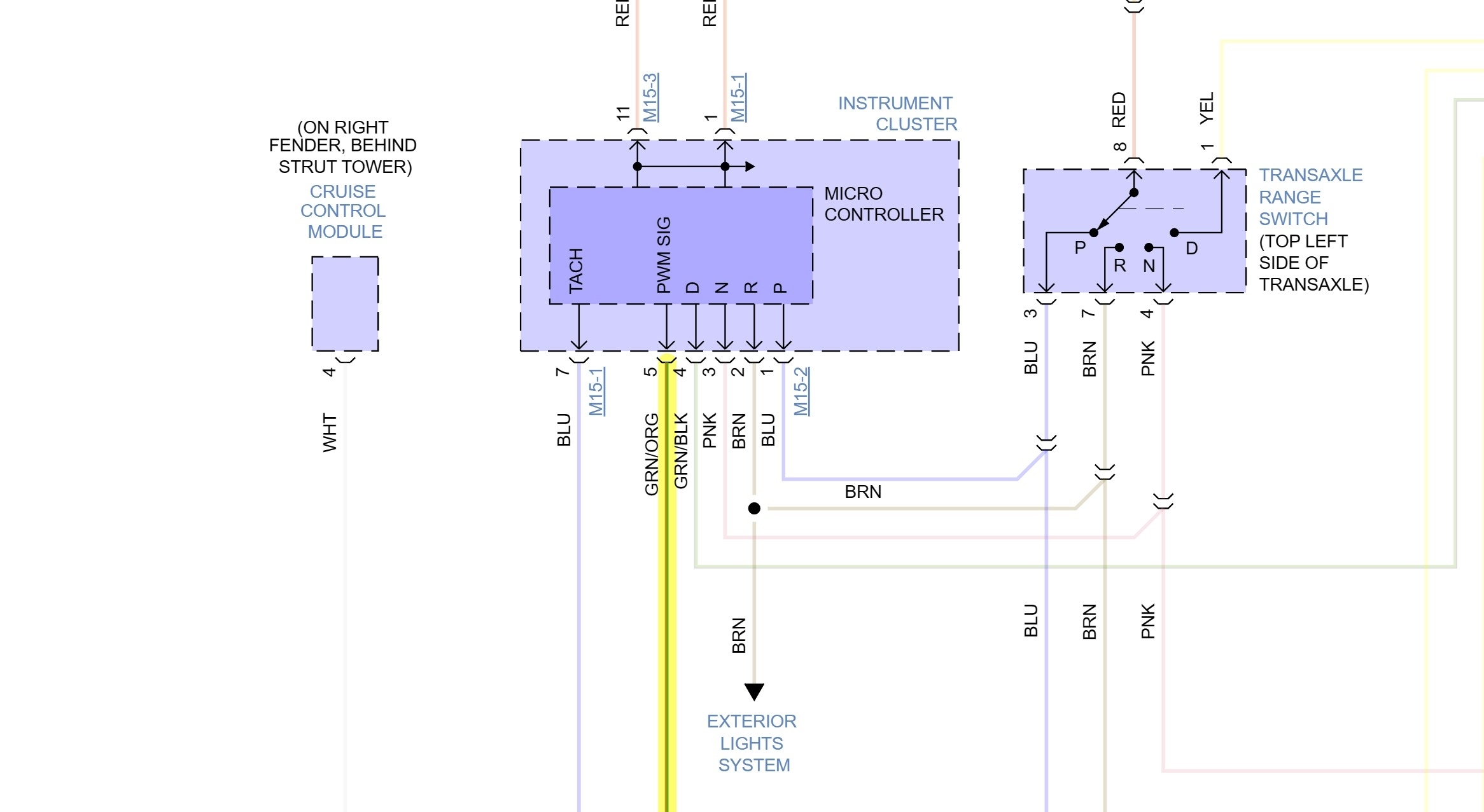

I wanted to jump in here if I could, the speedometer signal is generated form the cruise control module via the VSS, I would swap out the module to see what happens, here is the wiring diagrams so you can see how the system works and the location of the module in the images below. Please let us know what happens. I also see the spiral spring behind the steering wheel could cause the problem as well. A questionable connection through the spring would produce the same effect.
Mar 13, 2023 at 1:22 AM
BDAB68
  • 36 POSTS
Thank you, Ken. I think my issue is the ground on the sensor. The reason being is using my multimeter when I use battery negative than touch the power source connector on VSS harness I get 12v. The signal wire gives me 10v. However, if I move my negative probe to the ground terminal on the connector, I get a big voltage drop. Only reading 2.7v on supply and 2.5v on signal. From your diagram it looks like the ground for the sensor is at the body in engine bay. So, splicing in a new ground should hopefully fix it. If it doesn’t then I will go into looking more at the cruise control module. I really appreciate all the help I’m getting with fixing this problem. I’ve learned so much and keep learning more thanks to you all.

So, I ordered a new replacement VSS connector. I have a theory that might let me test if it is in fact the ground before I go splicing wires. My unorthodox thought is to hook up the new connector to the VSS then take the leads and place them in the original connector routing the ground to a new ground. See if the speedometer works. If it does, I’ll install the new connector and ground. If it doesn’t then I need to do some more digging. Perhaps like Ken said my problem lies in the cruise control module. I’m however feeling confident it’s a ground issue. It just surprises me that no codes are popping up. Usually, a bad ground would throw a code. Maybe that system isn’t monitored by the computer.
Mar 13, 2023 at 2:48 AM
  • 55,433 POSTS
Yep, it should, that is why I thought it would be the cruise module shunting the signal.

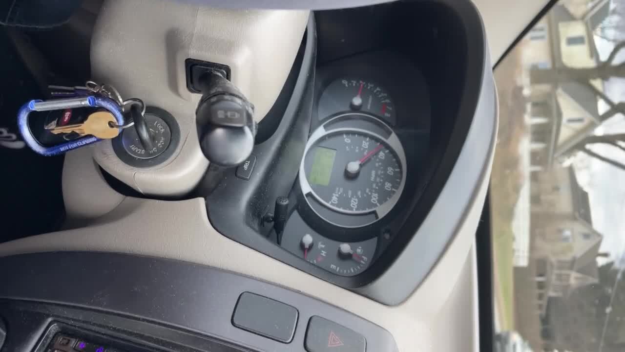

During winter the speedometer stopped working. After diagnosing a faulty ground wire, I ran a new ground from the VSS to the chassis. This fixed the speedometer, but I never did figure out if any other sensors shared the same ground as the vehicle speed sensor. So, I’m wondering if the engine coolant temperature sensor shared the same ground wire as the VSS. They are located close to each other and join together into 1 big wire harness. My only thought though is, I assume if the sensor wasn’t working then the temperature gauge would not be either. Looking at my vehicle it appears the sensor is also the sender to the dash. If it’s not and the dash actually gets the temperature from something else, then my issue could very well be the engine coolant temperature sensor. I don’t have any schematics or diagrams to go by. So, I’m hoping with your knowledge and resources you can help me out in diagnosing this issue.
