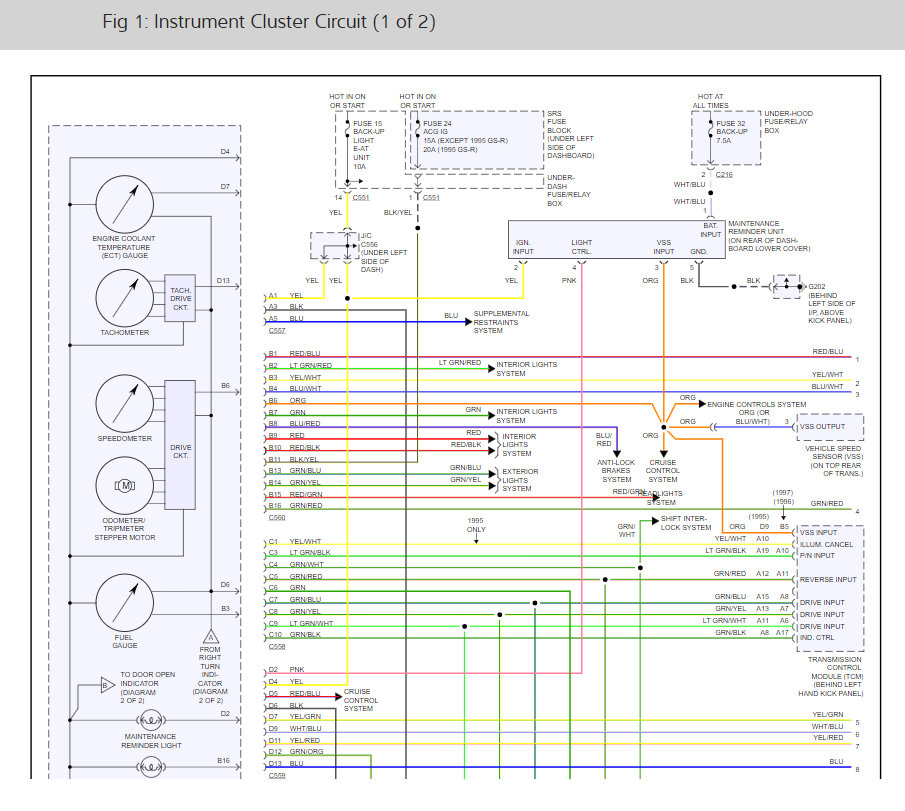

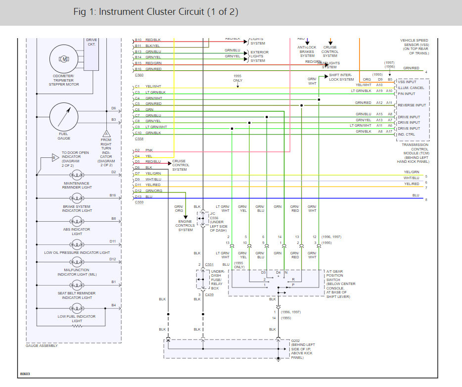

My VSS is reading 9.4v on the pulse wire, 12.44v on center wire, .02v on ground.
I get the 9.4v reading at the ecu, gauge cluster, and VSS itself. No blown fuses. It is a chipped p28, 94 integra GSR B18C1
Any information would be helpful as I have read what seems like a book of threads from different forums and no one has had this issue.
I've used 2 different clusters, 2 different VSS.
Cleaned all grounds and in some cases moved to new locations. TPS reads fine.
also no check engine light.

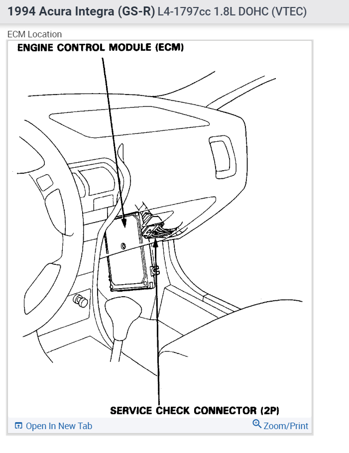

This sounds like the ECU is bad causing the speedometer operation you have described. Here is the location I would try a used unit or rebuilt. Check out the diagrams (below). Please let us know what happens.
Wednesday, September 4th, 2019 AT 10:43 AM
MRMARKD
  • 6 POSTS
I was thinking that too, I'll see if I can find my p72-a01.

Tried a different ECU no change in speedometer working. It did throw a check engine light, but when I turned the car off and then to koeo no codes flashed.
Yes, I had a clip in the blue code plug passenger side.
I've also checked the harness and have continuity with all 3 wires.
Thursday, September 5th, 2019 AT 2:24 PM

It could be an ignition feedback issue. do you have good quality (new) ignition parts? Here is a guide to help us check the wiring and the cluster wiring diagrams below:
Saturday, September 7th, 2019 AT 12:12 PM
MRMARKD
  • 6 POSTS
Thanks for the diagrams and sorry I didn't write yesterday, but I have already found the problem and have corrected the situation Friday afternoon. It was in the harness itself. The plug had actually shorted even though I was getting continuity; it was shorting when energized.
Saturday, September 7th, 2019 AT 6:39 PM
