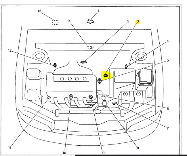

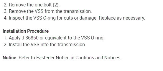

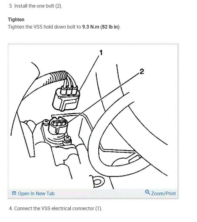

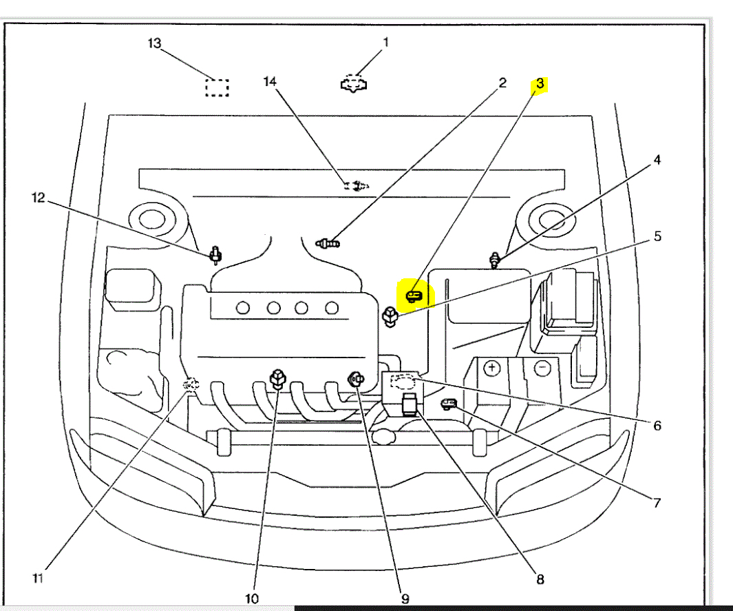

It should be on the driver's side, mounted on the top of the transmission closest to the firewall.

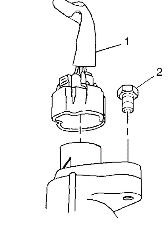

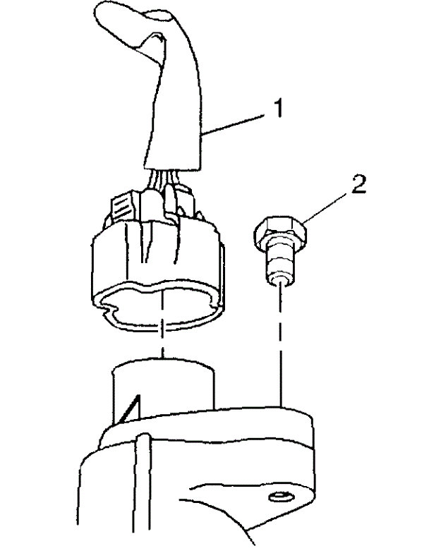

Take a look at the pic below and let me know if you find it. If you do, the remaining pictures are the directions for replacing it.
Let me know if this helps.

  • 21 POSTS
Following your diagram, I looked down and I think I may have found it. Does the top radiator hose go over the top of its location? I see wires and a plug, but I don't see a bolt. I see an Allen head bolt next to it but it doesn't appear to be connected to what I'm seeing. I also see a ground wire near it. What I'm looking at is under the air cleaner box. Thanks for your help, as you can tell I'm no mechanic. It looks like I could replace it, if I found it. Respectfully submitted Joe Biscanti.
Apr 3, 2022 at 12:27 AM
  • 110,248 POSTS
It is likely under the air induction tube or the air filter box. It will have a three-wire connector. Is that what you are seeing? If it is, that is the likely part.
Let me know. Also, if you are questioning if you are correct, take a pic of it and upload it for me to see.

  • 110,248 POSTS

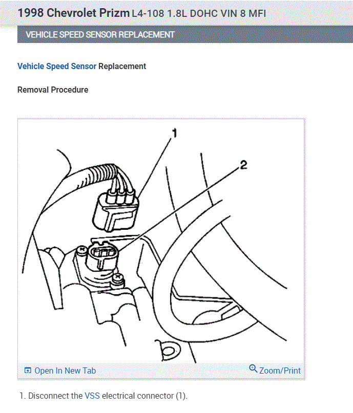

The VSS should be bolted in place. Take a look at the attached picture. That is what you should be looking for.
Apr 4, 2022 at 7:08 AM
JOE BISCANTI
  • 21 POSTS
It doesn't look like that. It looks like a two-wire sending unit, that if you disconnected the wires, you could get a socket on it. I sprayed it with CRC electronic cleaner, and it started working again. Then I put some dielectric grease on the connections, and it stopped working. I sprayed it really good, and I think I got rid of the grease. I will let it sit overnight and see what happens. Maybe that spray cleaning was just a fluke. In any case it doesn't look like the picture you sent me. I will look around again (weather permitting tomorrow). I really do appreciate your help and patience. Maybe I need to take off the air cleaner box to get a better look. Respectfully submitted, Joe Biscanti.

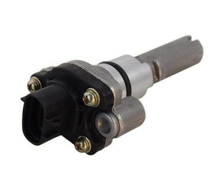

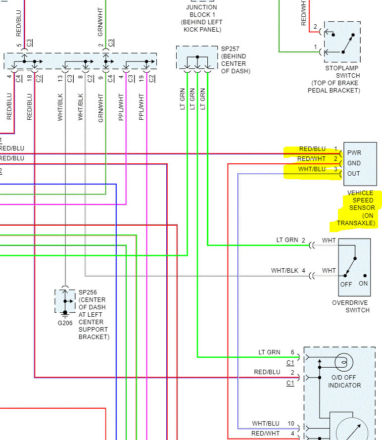

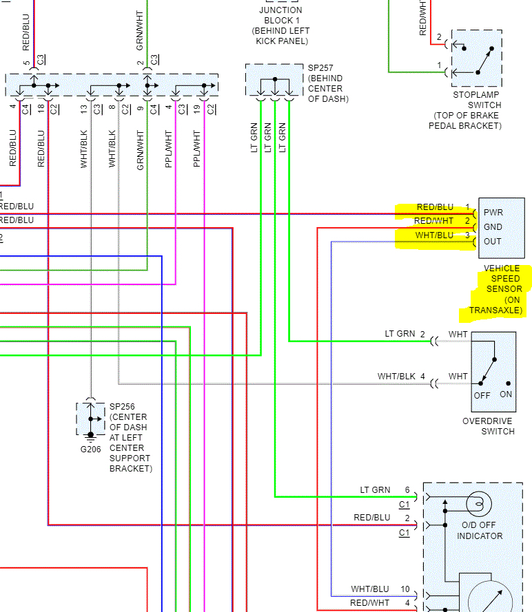

There are two transmissions used on this model, but both take the same sensor.
Let's try this a different way. I attached the wiring colors from the sensor. See if you can locate those three colors going to the same sensor.
Let me know what you find or if you have questions. Also, if possible, take a picture of what you are seeing.
See pic below.

Cancel that last reply please. I found the speed sensor. It was right near the fire wall where you said it was. I can access the bolt. I loosened it and retightened it. I 'm not sure how to unplug the speed sensor electrical connector which I need to do to pull the speed sensor out. I will wait for your reply before I order a speed sensor from Rock Auto. Never give up. Respectfully submitted, Joe Biscanti

Attn: Joe F. Expert. I was reading your installation procedures, what is J 36850 lubricant or equivalent ? I ordered a speed sensor today from Rock Auto. Walker products 2401037 speed sensor. 1998 Chevy Prism 1.8 liter 5 speed manual transmission. Looking forward to your reply. Respectfully submitted, Joe Biscanti
Apr 6, 2022 at 8:56 AM
  • 110,248 POSTS
That is what is typically called assembly lubricant. The directions most likely indicate to lubricate the o-ring on the part and where it attaches. You can use the gear oil for the transmission or even engine oil. I've even used Vaseline. LOL, the goal is to prevent damage to the rubber component during installation.

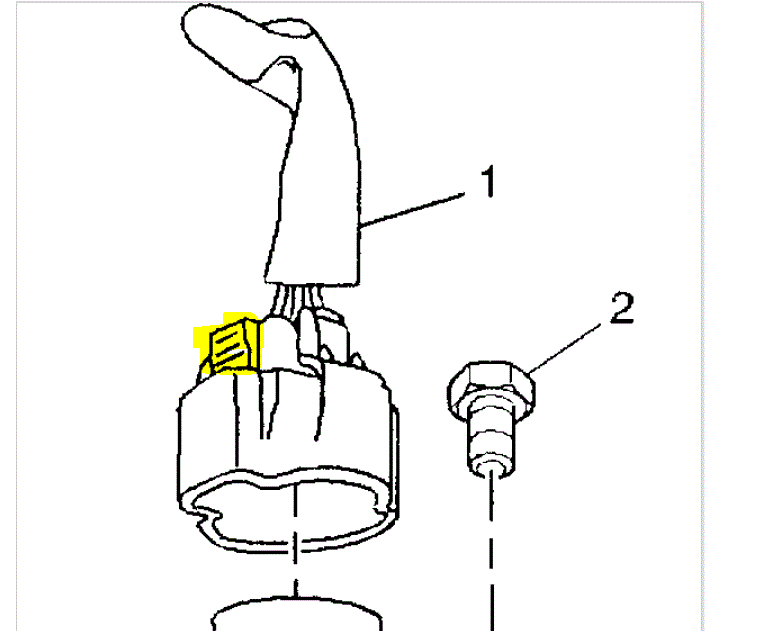

Great advice, thank you. I'm not sure how to unplug the speed sensor electrical connector. I don't want to break it. I could use some instructions on how to unplug it without damaging it. Thanks in advance for your help. Respectfully submitted, Joe Biscanti
Apr 6, 2022 at 2:21 PM
  • 110,248 POSTS
Joe,
By chance, could you upload a pic of what you have? There are so many different types that have been used.
If I had to guess, there will be a release on the one side that you press with your thumb to release it. I attached a pic below and highlighted the release on the pic. See if that is what you have.
See pic below.

I don't know how to upload and send pictures. I'm 71 years old and not too computer savvy. My eyes aren't so good either. I think that might be what it looks like. I'll have to use a magnifying glass to see it better. I will check it whenever it stops raining here. Rock Auto says the sensor might get here on or after 12 APR 2022. I will let you know about the connector. Thanks so much for your help. Respectfully submitted, Joe Biscanti

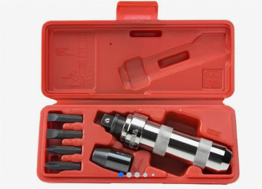

  • 110,248 POSTS
Joe,
You aren't having much luck. LOL
What would likely remove it is called an impact screwdriver. I attached a pic of one below.
It is designed to loosen screws like you are dealing with. How it works is this. You secure the head needed into the screw as best as you can and then you smack the back of the tool with a hammer. When that happens, you have all the inward impact of the hammer hitting it, and the tool is designed to turn a little at the same time to break the screw loose. I've had to use one a thousand times. And yes, they work well.
If you don't have one, check the parts store and see if they have one, they will lend you. Other than that, they are not too expensive online. I've seen them for under ten dollars.
