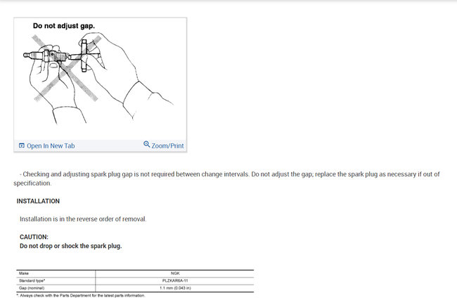

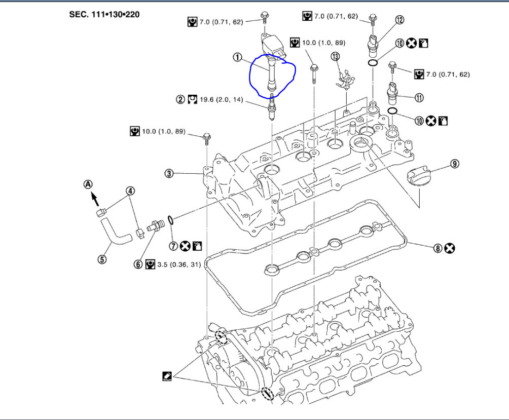

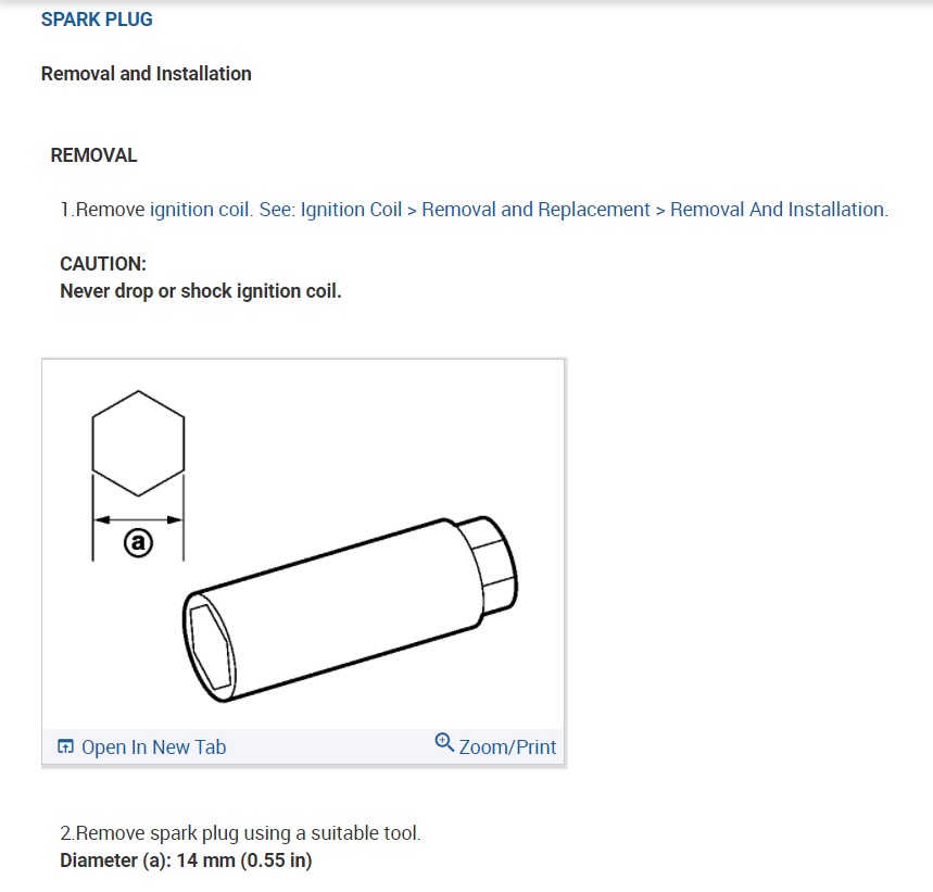

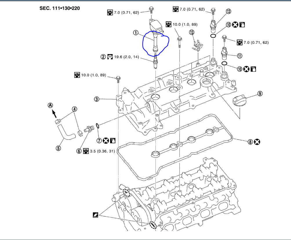

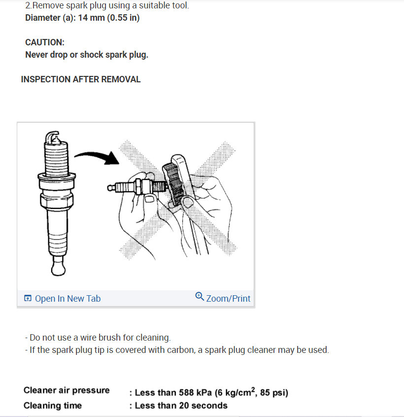

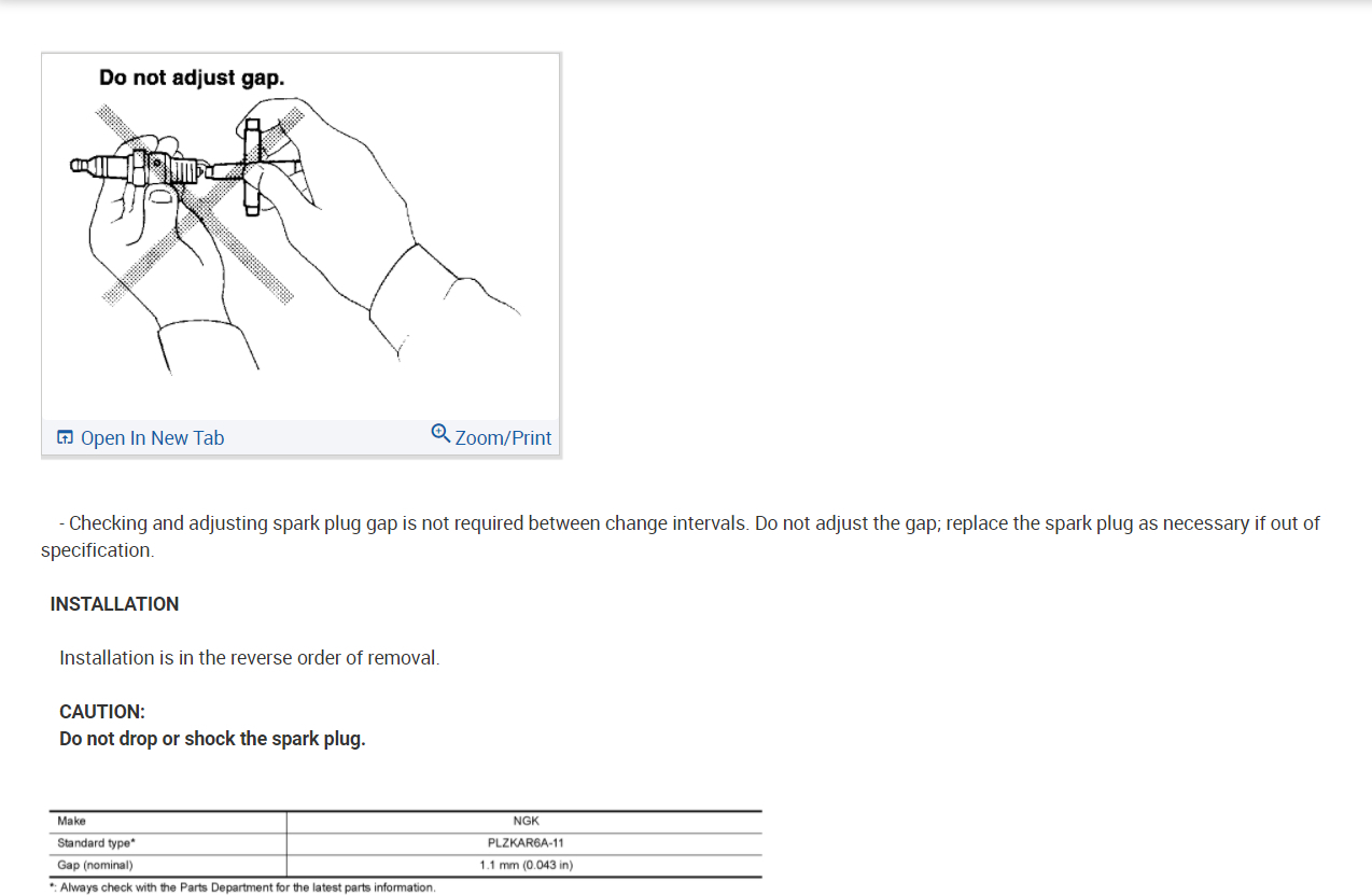

I changed my spark plugs and after I was done when I went to start it the engine started shaking and sounding like it wanted to shut off. Is it possible that I have the wrong spark plugs or could it be something else.
