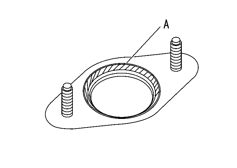

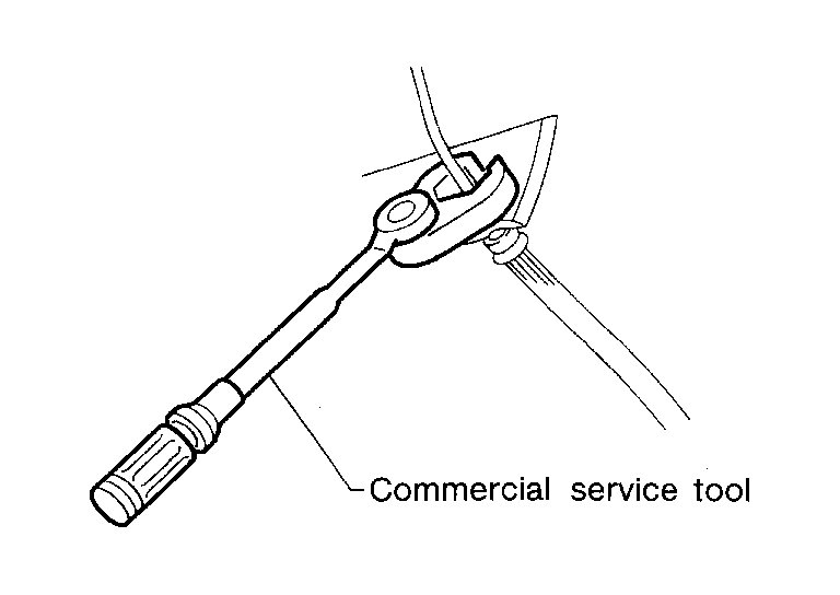

Here are directions specific to your vehicle. The attached pics below correlate with the directions.

5.Disconnect the master cylinder brake tubes using a suitable tool.

INSTALLATION
Installation is in the reverse order of removal.
pic 2
- Apply PBC (Poly Butyl Cuprysil) grease or silicone-based grease to brake booster at (A) position as shown. Be sure the O-ring is in the proper position before installing the master cylinder to the brake booster.
