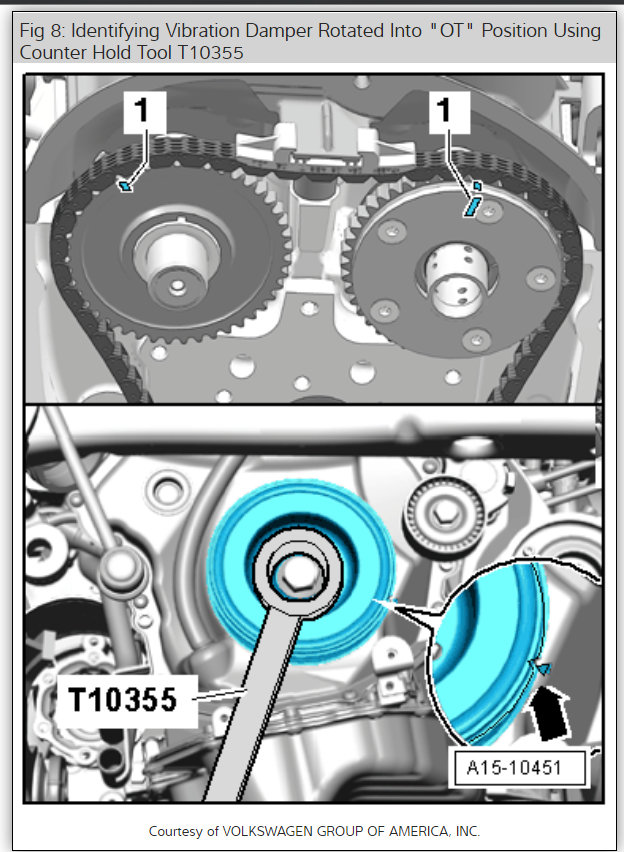

Well it has been like this for like twenty days so I do not know how long does it take to relearn.
Nov 24, 2018 at 5:41 AM
  • 55,711 POSTS
It sounds like the timing belt might be still off a tooth. Here is the camshaft timing so you can double check check it.
Nov 26, 2018 at 1:33 AM
BUJAR
  • 33 POSTS
It is sorted. Now mpg is better. Cannot wait to see the mpg on motorway now. :) Thank you.
