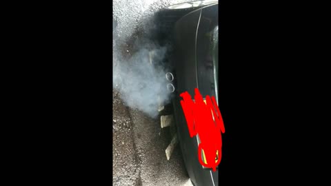

Can you explain me the problem of this car please? It does smoke when you idle it.

Here you go a video.

Hello, I am Danny.
Just a quick question. Does it do this all the time or does the smoke go away? I have attached a tutorial for you to view. Hope this helps and hope to hear back soon. Thanks for using 2CarPros.

It does that every time sometimes it stops for a few minutes and then starts again.

But the thing is when you start the car in the morning it does not smoke for a few minutes and then the smoke starts.
Aug 27, 2018 at 4:26 PM
  • 55,387 POSTS
This can be normal, after the car is warmed up and you have been driving for a while do you see what smoke/steam? Thanks for the video it helps. Also, has the coolant level been low at all?

Thanks for answering back. The car does not lose any coolant or does not burn oil at all. When you are revving the car the smoke goes away as long as you idle it back the car starts smoking as shown on the video.

It is like a blue smoke not white.

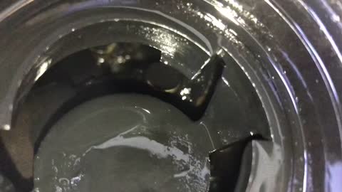

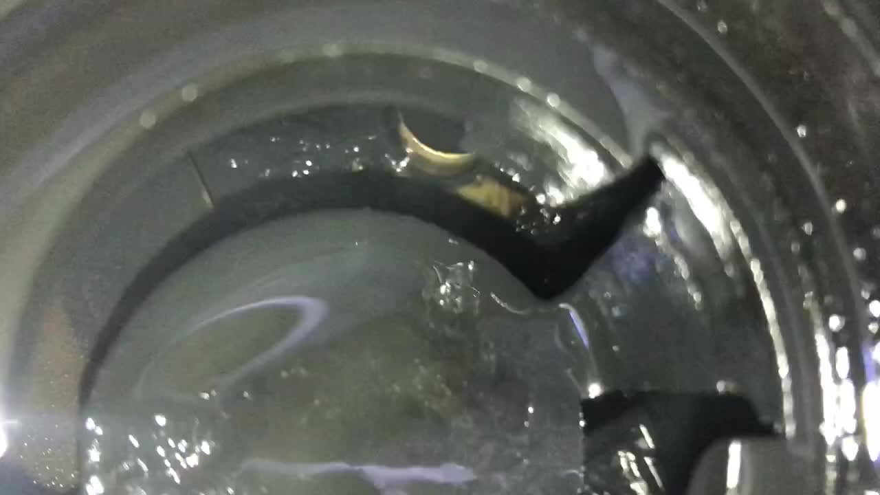

If the smoke is blue (hard to tell from the video it looks white to me) these cars had problems with the oil drain back holes in the cylinder heads getting clogged causing the engine oil to fill the cylinders heads and leak down the valve stems seals and into the combustion chamber. Can you remove the oil cap and use flashlight to see how much build up there is? Send a video if you can so we can see. Can I ask if the smoke ever goes away?

Here you go.

Yep, you can see the build up inside the cylinder head. Lets remove the valve cover and take another video to confirm the issue. Here is a guide to help us get started:

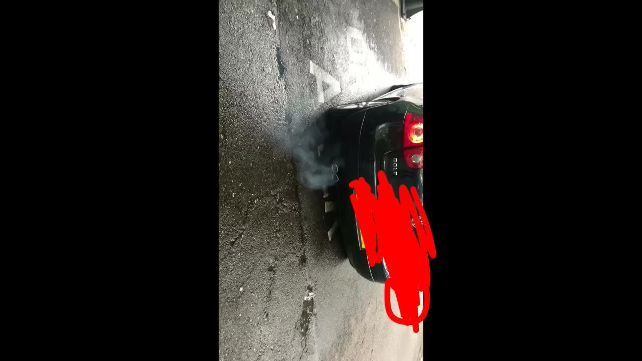

My bad, I have seen low fuel pressure and fuel contamination cause this issue as well. You say it does not lose coolant? Looking at the video again it looks like coolant or normal condensation. Does it go away when warm?

Sometimes it does go away and it does not lose any coolant or burn oil at all. I changed the oil before four month and I have not received any oil loss so I do not really know what is wrong with it.

If the smoke/steam goes away when hot then the steam is normal. Are there any other problems you see besides the steam?

Sometimes the smoke goes away and it is blue not white. White it is steam in the morning only but blue smoke, sometimes it goes away after warmed up, or it gets worse.
