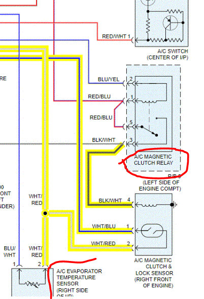

You called it a lock sensor. In all honesty, I never heard of a lock sensor for the AC. Could it be a pressure sensor?
The 10 amp fuse is for the AC switch. Power is supplied to the compressor clutch via the AC amplifier. See pic 1.

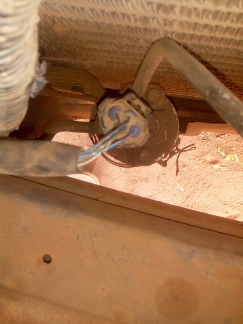

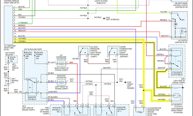

If you check the diagram, three wires are going to the compressor, one to power the compressor clutch and the other two wires for the lock sensor. Check the diagram.

Those two wires that you traced at the compressor, that are white/blue and white/red are the wires that I am talking about.
Sunday, February 21st, 2021 AT 8:27 PM
  • 109,885 POSTS
Those wires go to the AC amplifier. I indicated where they go below. As far as the fuse, I said it should have blown. I don't know why it didn't.

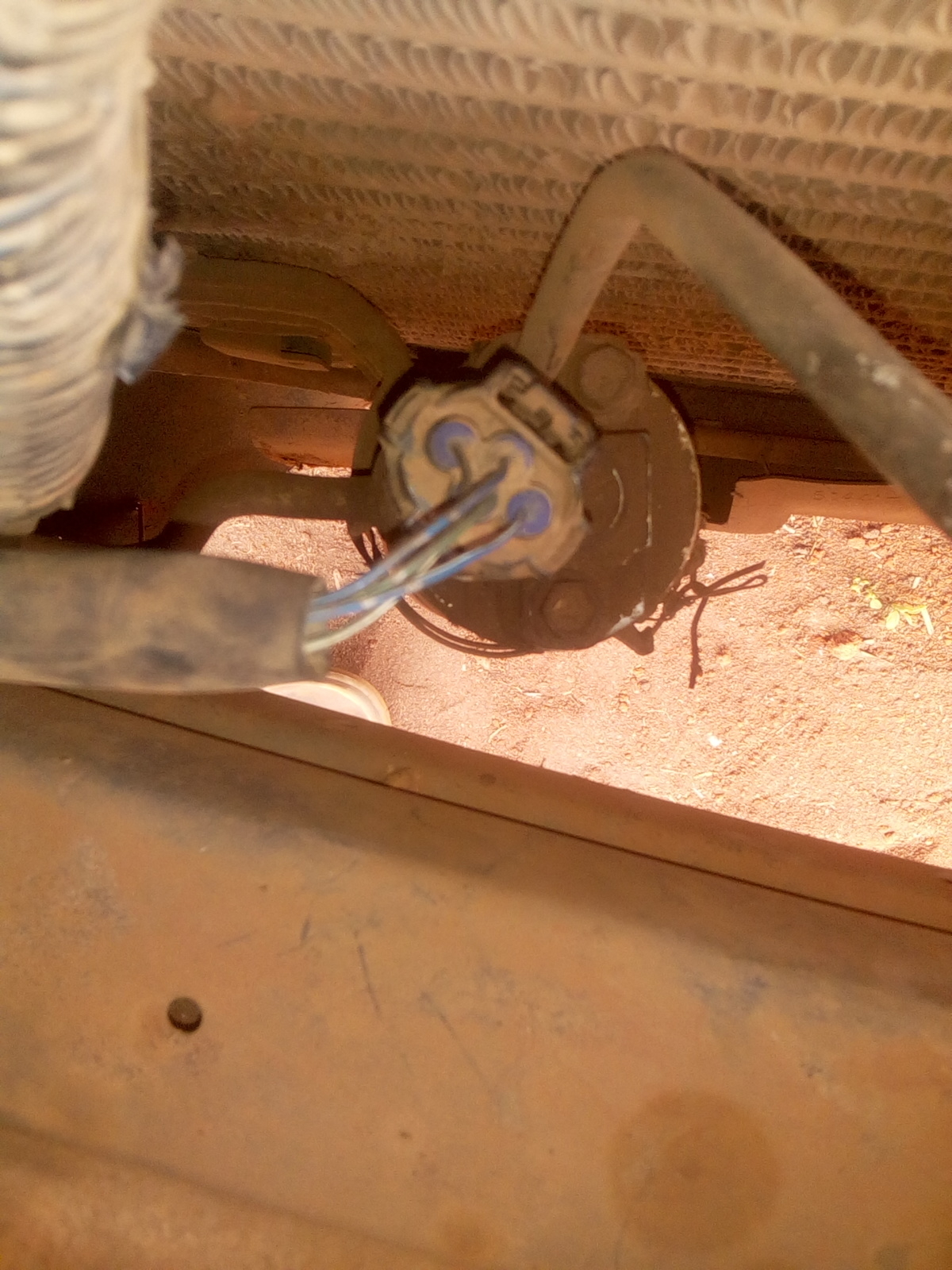

As I said earlier that two wires were not connected that goes to the compressor, I removed the alternator so that I can access the compressor properly but guess what! There I saw the real cause of the burnt wire, the black/white wire that supposed to power the compressor was naked somewhere close to the compressor and it do short the circuit to ground. After rectifying these everything works normal.

The schematic may show different colors. That is what it sounds like you are dealing with. Are you able to use the schematic to follow the wires? Not being there is going to make it nearly impossible for me.
Friday, February 26th, 2021 AT 6:21 PM
BLESSING EWOBOR
  • 687 POSTS
I used the schematic to follow the wires but I didn't use the wire's color.
