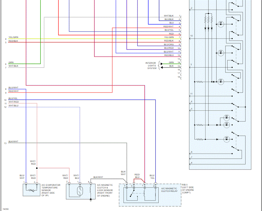

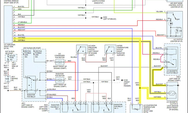

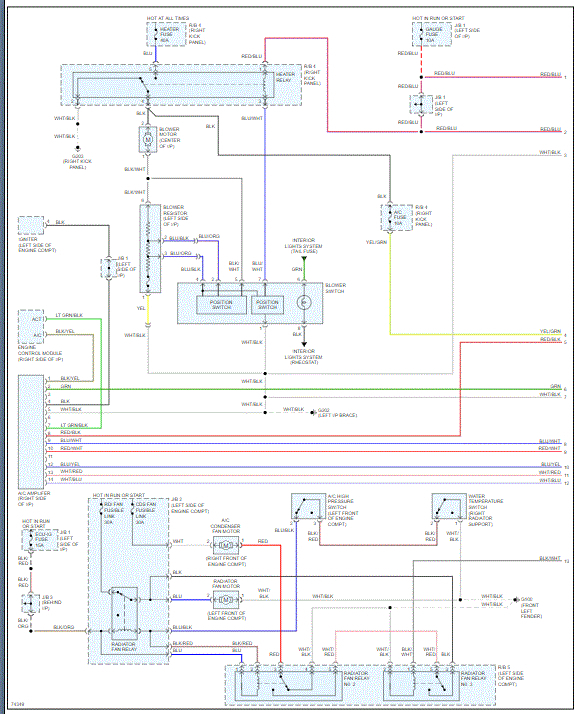

Hi, the owner of the vehicle complained that he does see smoke under the dashboard of the vehicle whenever he put on the air conditioning. He gave it to a Technician to fixed, according to the Technician he said that he replaced all the burnt wires. After he owner got his car from the Technician, it seems to work well after sometime it repeated itself (the smoke under the dash) and he said that this happened when the air conditioning is put on.
What could be the cause of these?
I don't know if I can get the circuit diagram for the A/C to trace the wires.

I'm not sure which wires are overheating, so that is a tough call. However, here is what I would be doing: First, check the blower motor and make sure it isn't drawing too much amperage. Second, confirm someone hasn't put the wrong size fuse in the circuit. Third, a loose connection (plug) or poor connection will create heat. Check all connectors. Forth, make sure the system has a good ground.

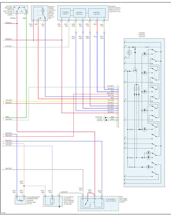

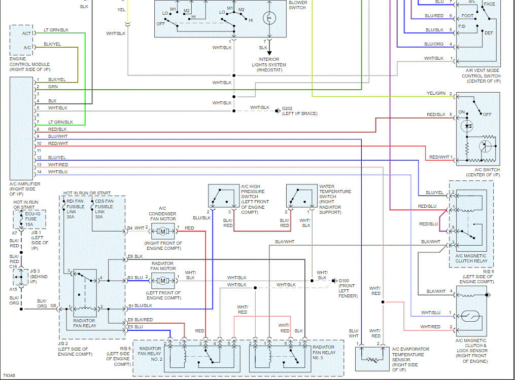

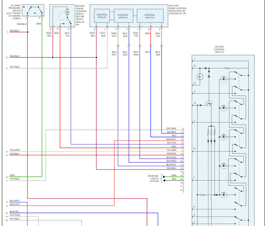

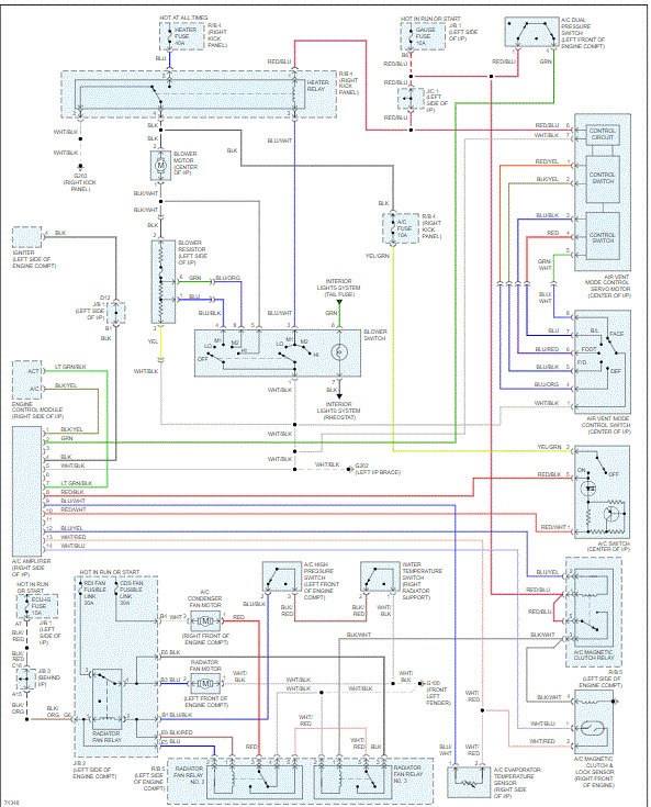

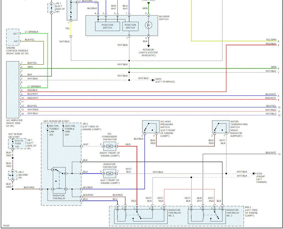

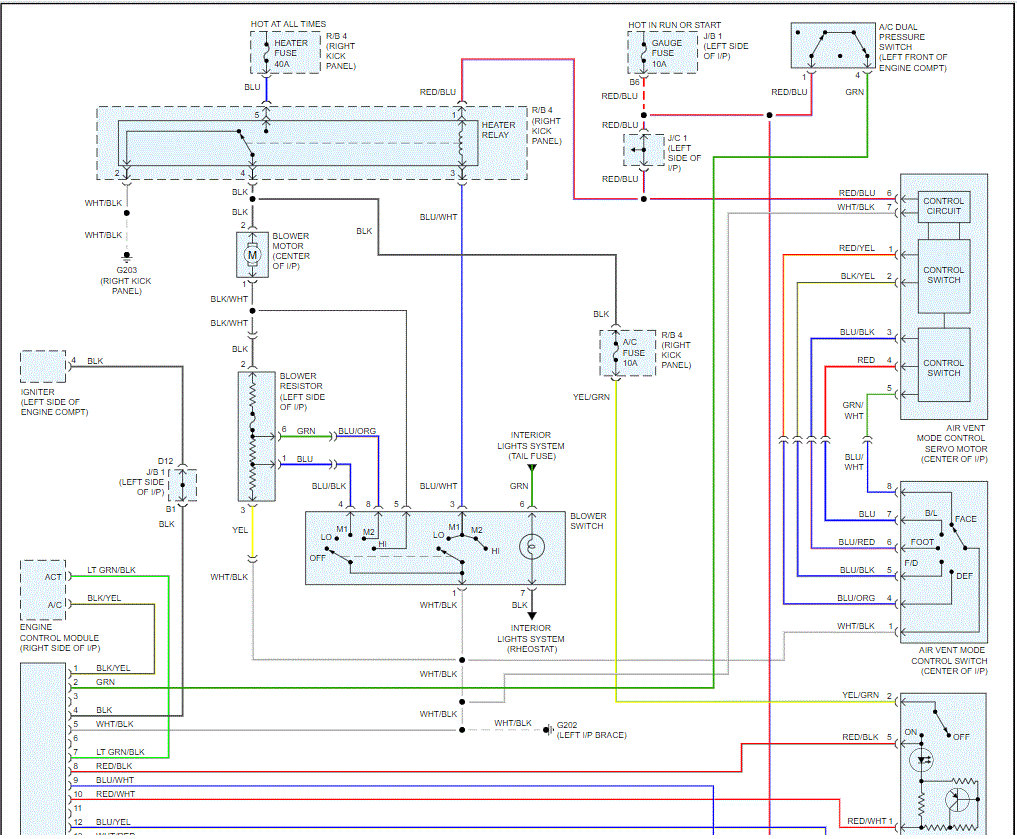

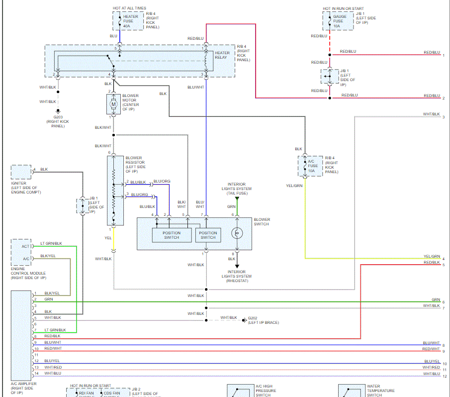

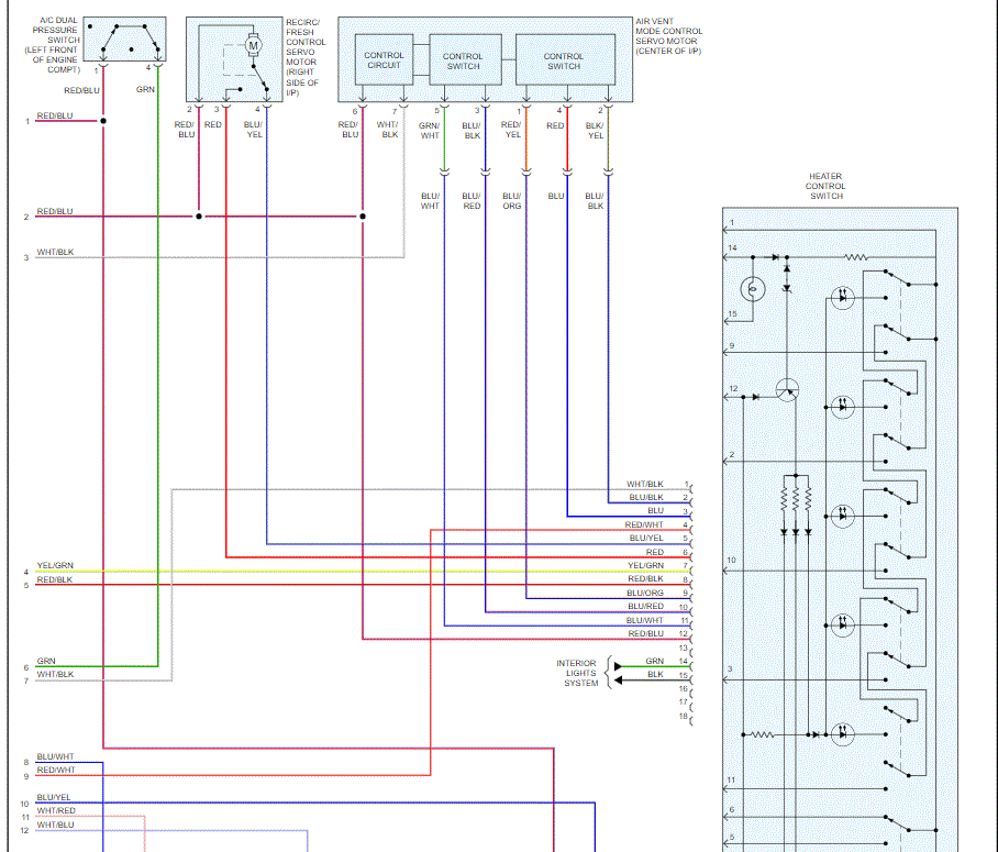

I attached 3 pics below. The first one is the AC wiring schematic for the lever-type control. Pics 2 and 3 are for the push-button type. I'm not sure which you have.

Good evening sir, I have printed those diagram but they are blur, I don't know if you could help me divide the diagram so that I can have a clearer picture.

You should be able to do this without removal. The blower motor should be accessible on the right side (under dash).

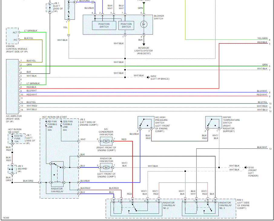

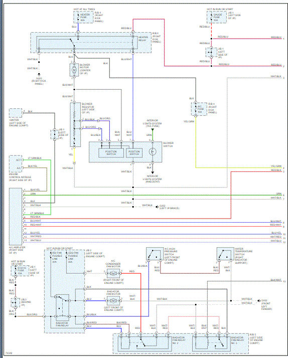

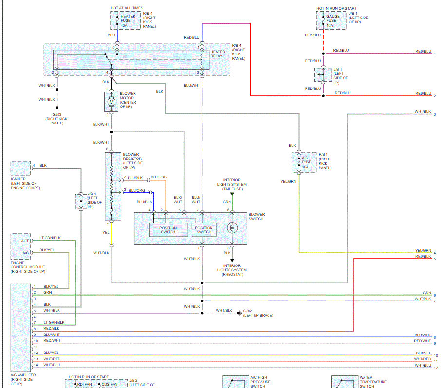

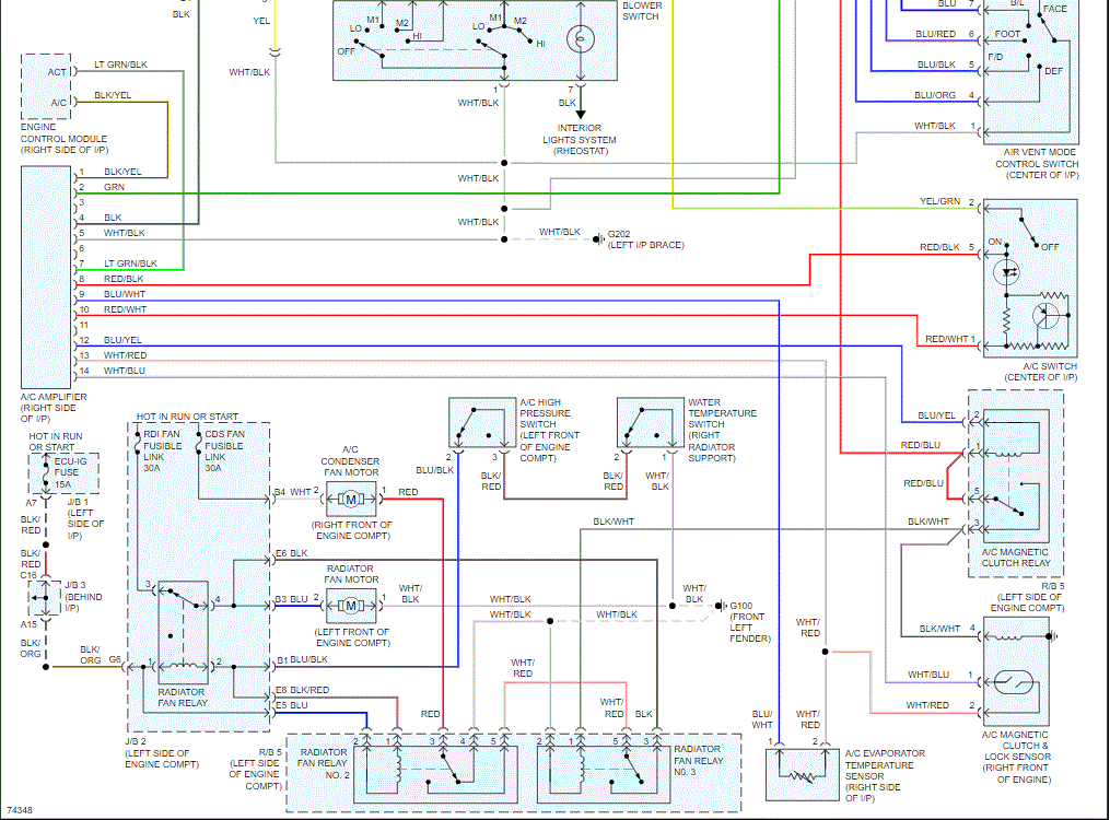

Pics 1 and 2 are for the lever-type control. I cut the pic in half, but I did overlap them to help you follow.
The remaining pics are for push button control.
I hope this helps.

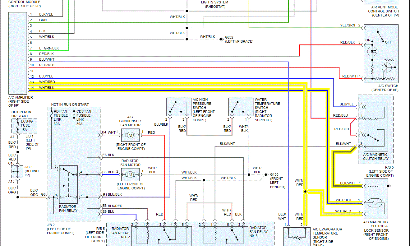

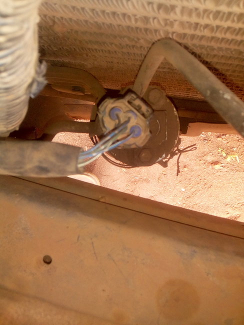

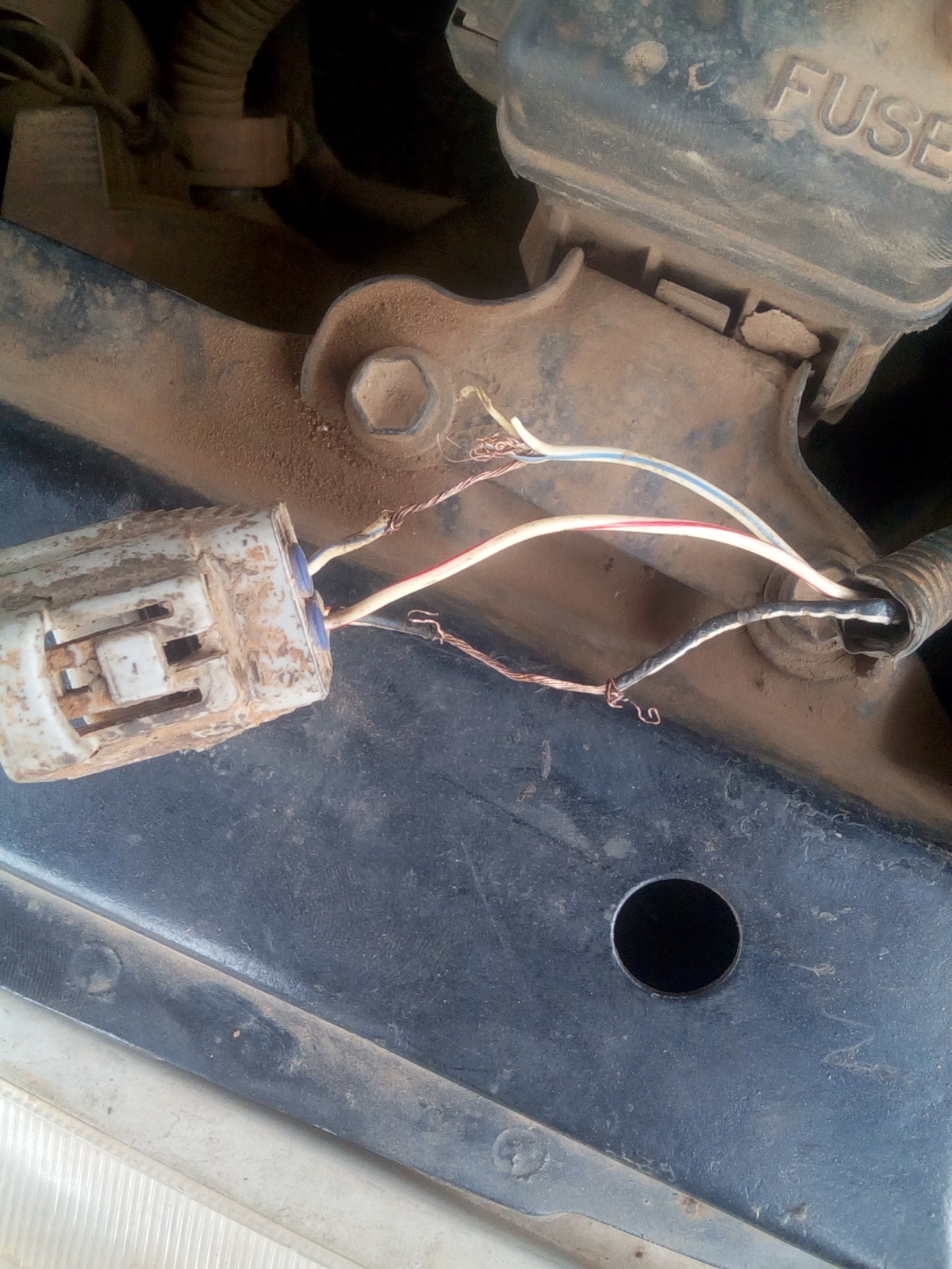

Hi, I worked on the vehicle, I confirmed the fault by putting on the A/C while the vehicle is running after few minutes, I saw smoke from under the dashboard and power distribution center (fuse box) at the engine compartment. I traced the wires, three different wires were stick together under the dashboard, I separated them. Checking the fuse box at engine compartment, I realized that the wires that powers compressor were completely burnt and some wires that comes from that big heater relay. I traced to know the cause before I saw that the A/C magnetic clutch wire at the compressor and one of the wires for the lock sensor were combine together.
Could that have been the cause of the burnt wire?
The wires are shown below.
Feb 20, 2021 at 4:47 AM

Yes, the two wires in the first pic could have caused the issue, but the fuse should have blown before melting the wires. Check to make sure the fuse hasn't been replaced with one of a higher amperage.
Now for the light, does the compressor engage at first and then stop? The clutch itself may be bad. When the light starts flashing and the compressor stops, you need to check if there is power to the compressor clutch.

I also realized that the wires of the compressor lock sensor has detached from the sensor at the compressor.

  • 110,244 POSTS
You called it a lock sensor. In all honesty, I never heard of a lock sensor for the AC. Could it be a pressure sensor?
The 10 amp fuse is for the AC switch. Power is supplied to the compressor clutch via the AC amplifier. See pic 1.

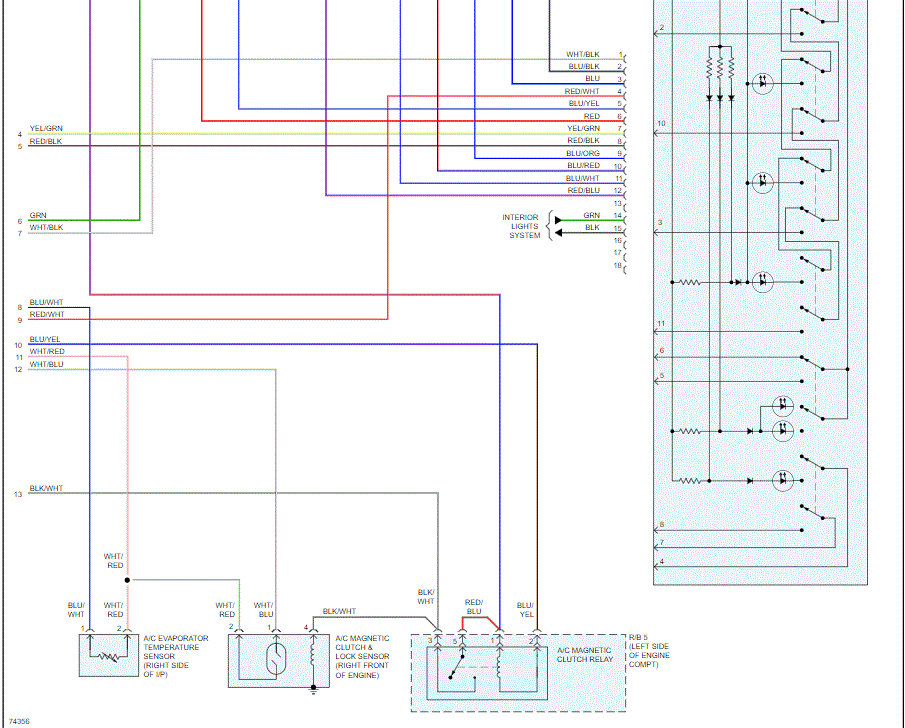

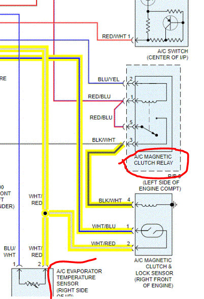

If you check the diagram, three wires are going to the compressor, one to power the compressor clutch and the other two wires for the lock sensor. Check the diagram.
Feb 21, 2021 at 12:22 PM
BLESSING EWOBOR
  • 753 POSTS
Those two wires that you traced at the compressor, that are white/blue and white/red are the wires that I am talking about.
Feb 21, 2021 at 12:27 PM
  • 110,244 POSTS
Those wires go to the AC amplifier. I indicated where they go below. As far as the fuse, I said it should have blown. I don't know why it didn't.

For the pressure switch how would I be able to bypass or check if it is faulty since it has four wires on it?
Feb 23, 2021 at 8:22 AM
  • 110,244 POSTS
You could run a jumper at the connector. However, check the pressure before doing that. Let's make sure it isn't already too high.

Hi, as you said earlier that the fuse supposed to blown off before the wire start to burn. I checked the fuse at the instrument panel (10A heater fuse, looking at the top of the fuse, it is 10 amp fuse but it has wrapped with many wires, so I think that is why the fuse didn't blow off).

As I said earlier that two wires were not connected that goes to the compressor, I removed the alternator so that I can access the compressor properly but guess what! There I saw the real cause of the burnt wire, the black/white wire that supposed to power the compressor was naked somewhere close to the compressor and it do short the circuit to ground. After rectifying these everything works normal.

  • 753 POSTS
Sir, from the diagram the fuse (gauge fuse) supposed to be (heater fuse) because when I removed the gauge fuse all light on the instrument cluster went off and there was voltage at the compressor relay not until I removed the heater fuse (instrument panel).
