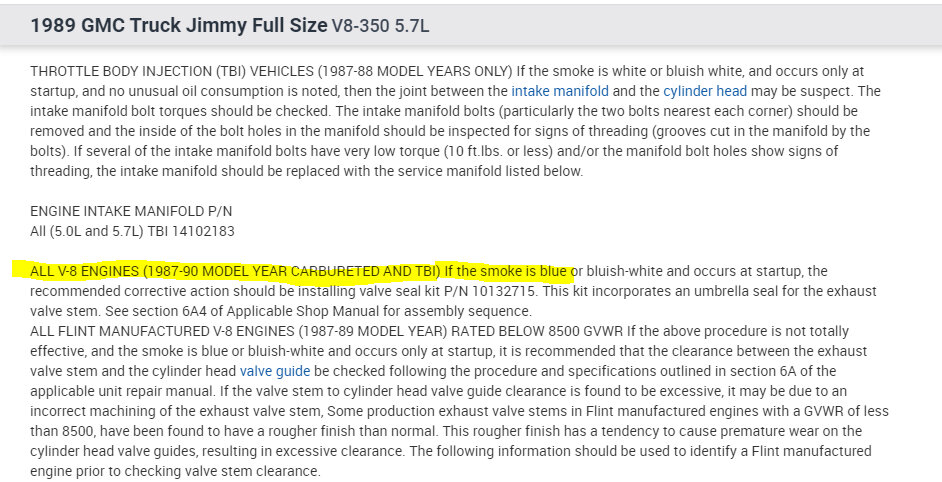

I have not noticed any oil consumption or water. Before I go to valve stem seals would like second option had a friend tell me I should lock at ECU. It has a faint smell of gas catalytic is new/plugs/cap/rotor/wires/and module are new as well. I passed smog check no problem. Thanks for any advice.
Nov 6, 2022 at 1:36 PM
  • 110,244 POSTS
The ECU has nothing to do with this. It sounds like you are on the right path with the valve seals. Keep in mind, with 150,000 on it, the valve guides can cause issues as well, but the seals usually take care of the problem.
When you have the valve covers off to do this, make sure the oil returns in the heads are clear.

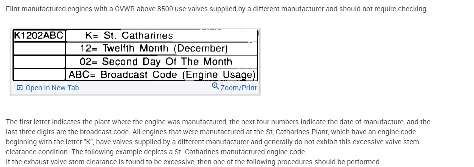

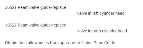

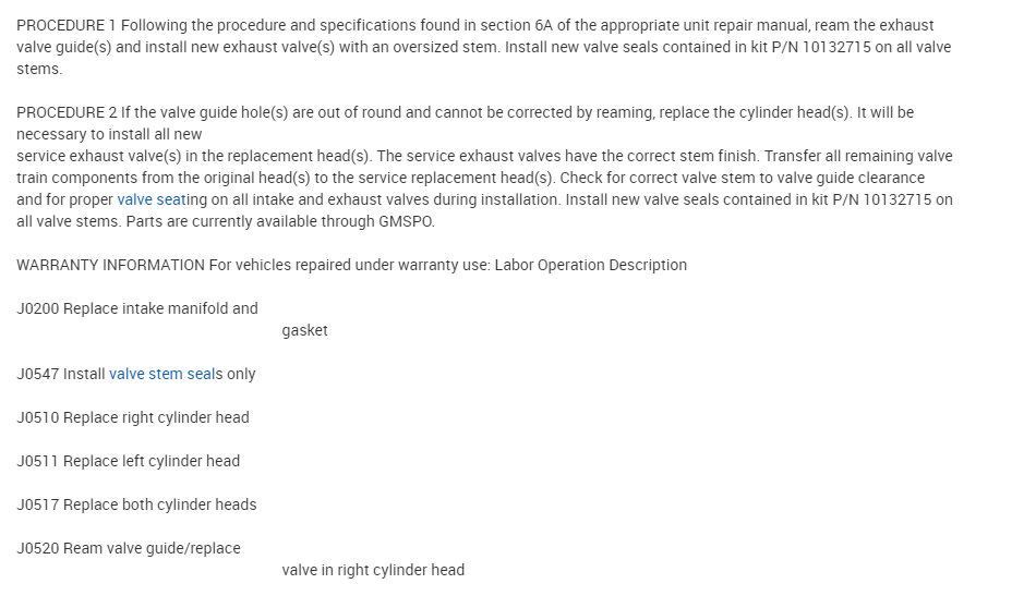

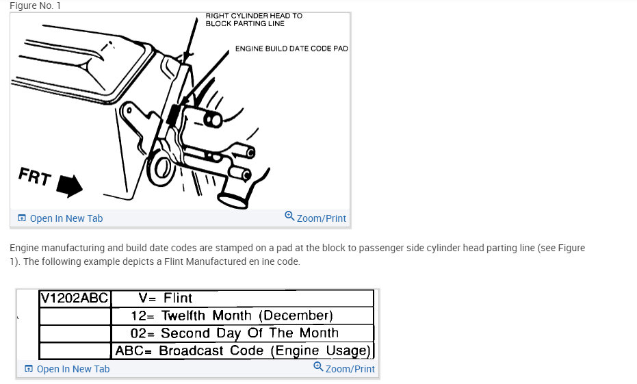

Also, I found an old technical service bulletin. I don't feel this is the issue but want you to be aware of it.
Let me know how things turn out for you.
