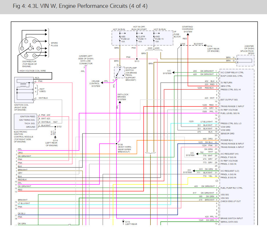

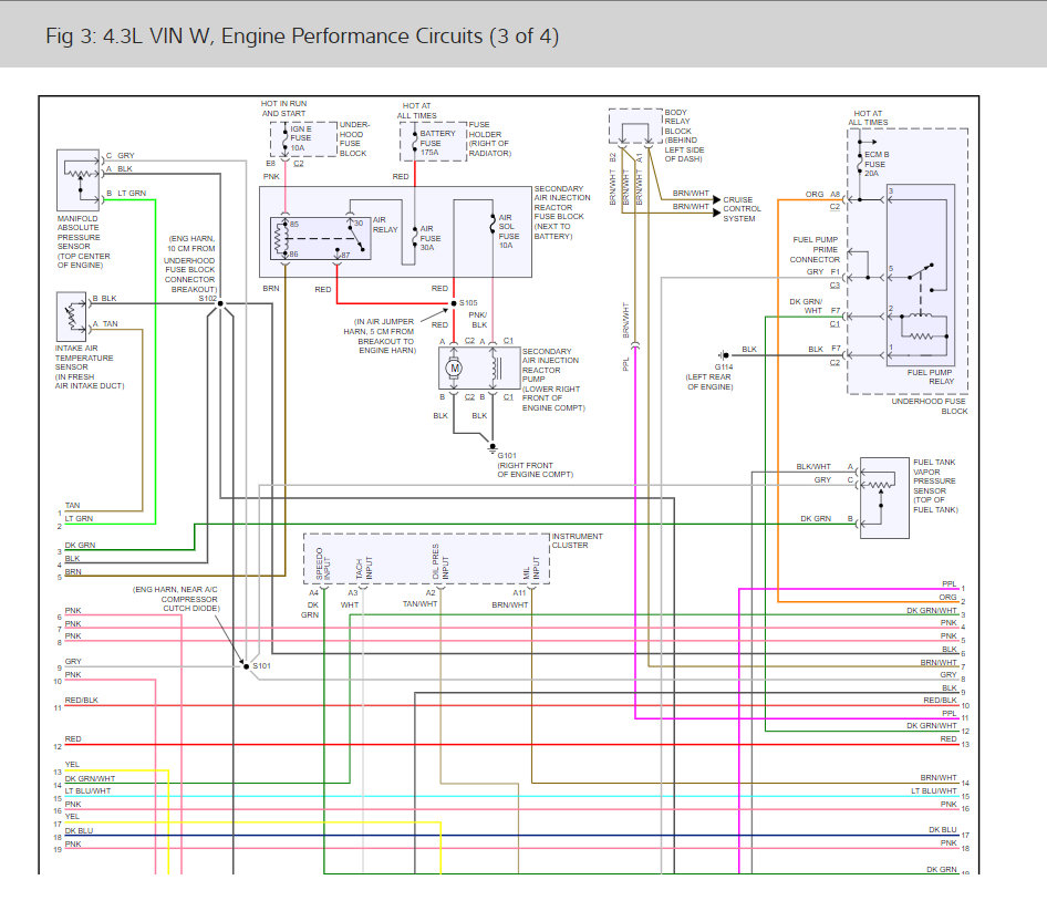

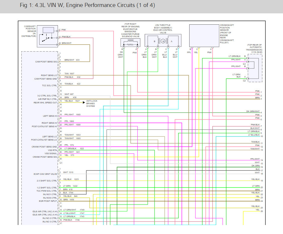

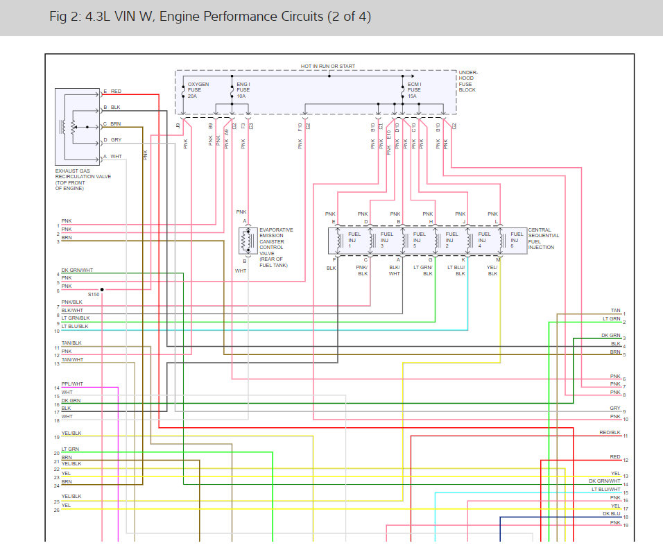

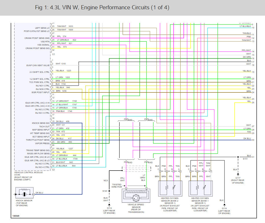

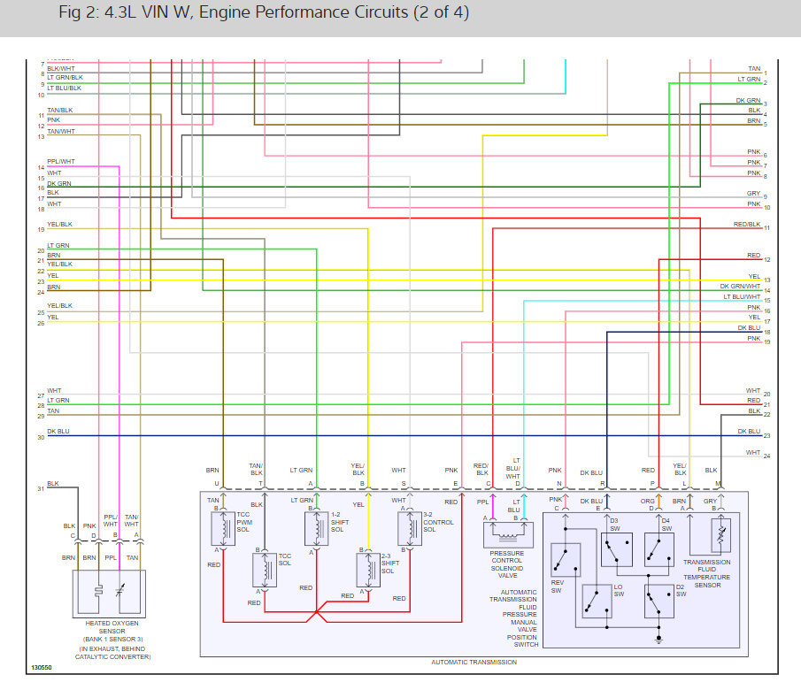

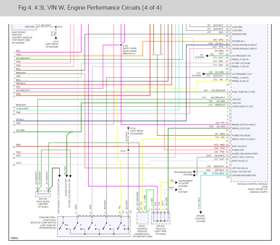

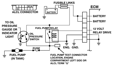

I need a wiring schematic of the fuel pump system with color code listings? Need the diagram for the fuel pump its self was replacing fuel pump and 3 prong connector broke. So now i'm not sure which wires go where? Plz help asap?
Monday, February 8th, 2010 AT 2:31 PM
11 Replies
JDL
  • 16,098 POSTS
Here is a guide to help you check the wiring and the engine/fuel pump wiring diagrams below.

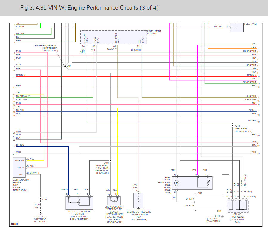

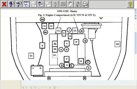

I have replaced the fuel pump, wireing harness, and check the fuse and the relay under the hood. I even check the relay behinde the glove box. All system seems to be a go. Yet it's not running yet. Now the GMC dealer tells me about this ( gas-oil ) switch! But they will not tell me where it is. Can someone please tell me where to go look. One of the relays has power in, and 4-wires coming out: only 3-wires have fire. Could this relay be bad?
Monday, September 23rd, 2019 AT 2:52 PM (Merged)
  • 75,992 POSTS
You got 2secs to check for power at the gray wire on the fuel pump connector-if its there and the fuel pump is till not pumping check the ground side and also look for a voltage drop on the gray wire-
On this ,Now the GMC dealer tells me about this ( gas-oil ) switch! they are talking about the fuel pump/oil pressure sending unit-see below how its wired.
https://www.2carpros.com/forum/automotive_pictures/12900_oil_sending_unit_and_fuel_pump_circuit_31.gif
  • 75,992 POSTS
The fuel pump/oil pressure sending unit is located on the no.6 below-its on top rear of engine near the distributor.
