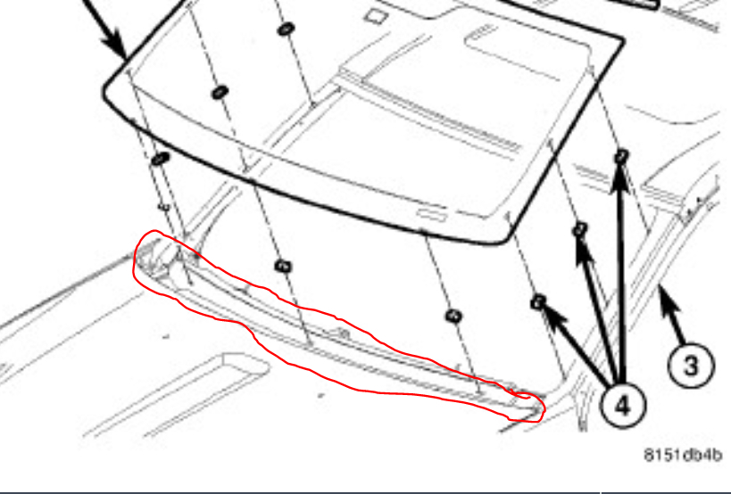

Seriously the air coming into the vehicle smells exactly like poop. I think a small animal of some kind got into the vent system and pooped in there. Doesn't matter whether it's outside air, recirculated air, A/C on or off. I've tried all matter of deodorizing including a scent fogger. FYI I'm a complete mechanical novice.
I've tried numerous online searches to try to find a diagram of the passenger air intake system and can find no info, pictures, or video beyond replacing the cabin air filter which I did to no avail. I'm hoping to be able to look at the system from the initial air intake point outside the vehicle to see if I can we anything.

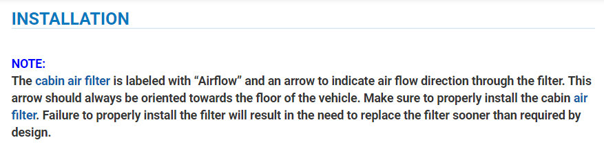

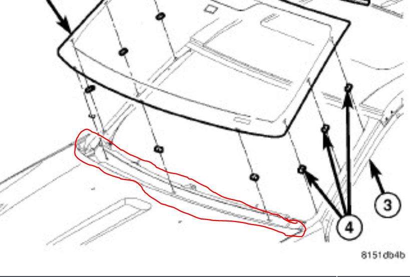

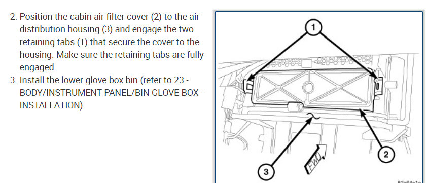

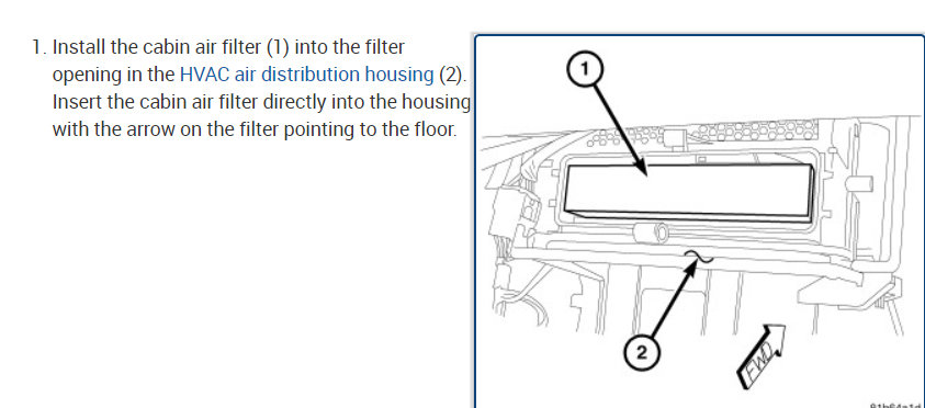

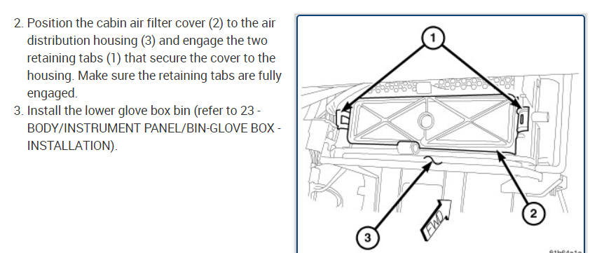

Here is the information you've requested. The area behind the back of the hood and the bottom of the front windshield is called the cowl. That is where all the air is drawn into the van for heating and cooling. I always suggest for people to spray an entire can of Lysol spray into the length of the cowl to help eliminate bacteria and smell. Here is a tutorial showing what is involved for cabin air filter replacement:
https://www.2carpros.com/articles/how-to-change-an-air-cabin-filter
I've attached picture steps below for cabin air filter replacement and the front cowl location for your van. Hope this helps and thanks for using 2CarPros.
