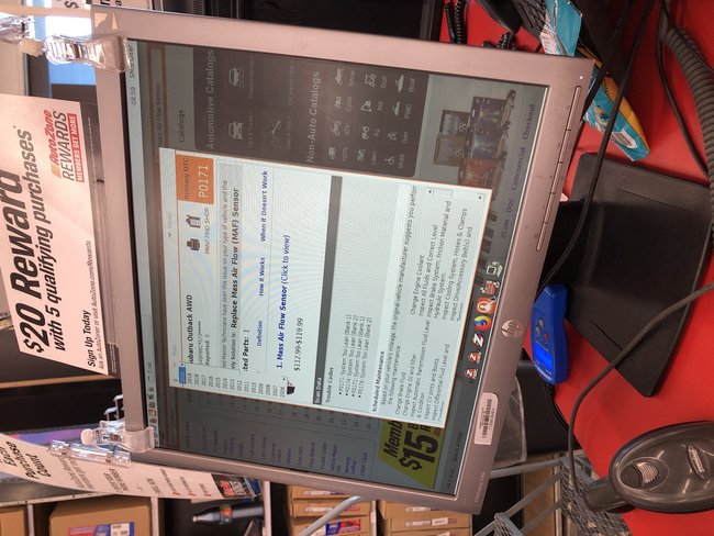

Of course! Two codes actually, but both pointing to the mass air flow sensor, I checked my air filter this morning and it looks fairly clean still. I can try to get a look at my MAF sensor soon and get some cleaner just in case it’s dirty, I’ll check back soon
Nov 18, 2019 at 5:16 AM
  • 110,248 POSTS
Hi.
Here is a link that explains how to clean a MAF:
https://www.2carpros.com/articles/mass-air-flow-service
Let me know what you find or if you have other questions. One last thought. When you remove the MAF, confirm there are no wiring issues and make sure the plug connector is clean and not corroded or damaged.
