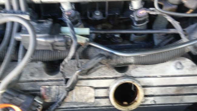

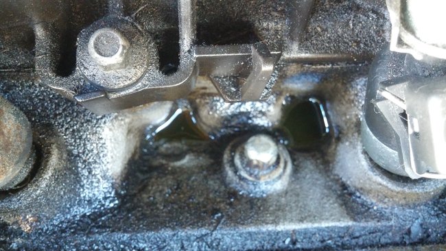

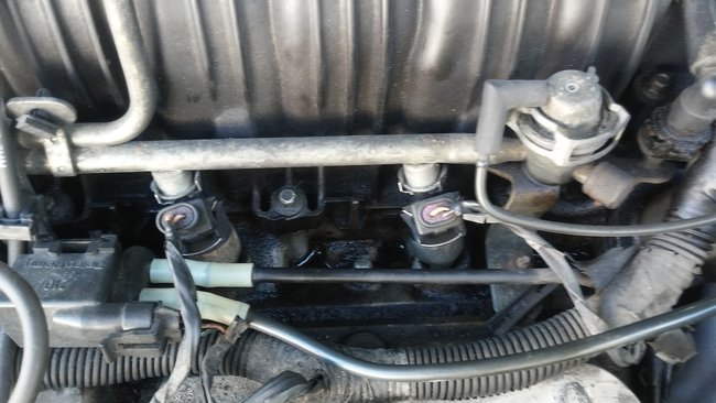

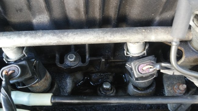

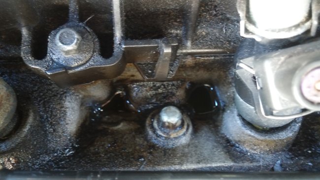

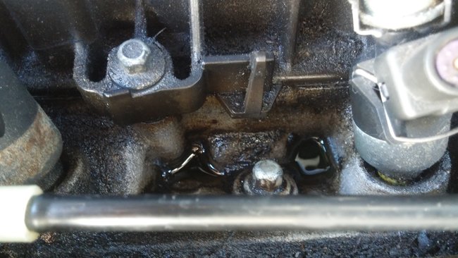

I have noticed that there is what looks/seems to be small amounts of oil, on the engine just below the upper intake manifold gasket, and it is sitting in the little pocket crevices, i usually get a rag and use my pinky to absorb it. Help! but, the car starts right up though, i usually have to turn on A/C fans to keep temperature stable.

Have you checked to see if the valve cover gaskets are leaking? Also, does the engine heat up if the cooling fans are not running? If so, does it also overheat when driving at highway speeds with the fans off?

I sent some pictures, and if you look at the middle towards the bottom of each photo, you can see the two oil spots/miniature puddles.

Hey DWIGHT,
That is definitely an valve cover gasket leak, here is a guide on how to change it. Once competed clean up the oil and the problem should be gone.
Here are to guides to help fix both problems.
https://www.2carpros.com/articles/replace-valve-cover-gasket
and
https://www.2carpros.com/articles/engine-overheating-or-running-hot
Please let us know what you find so it will help others.
Best, Ken
