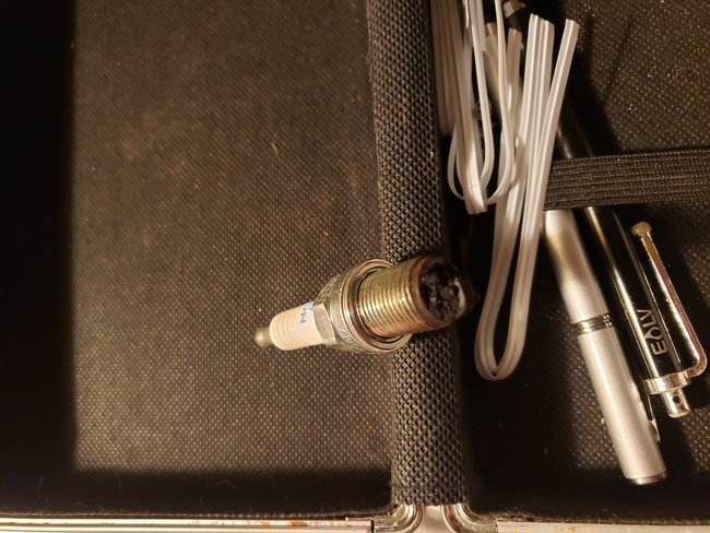

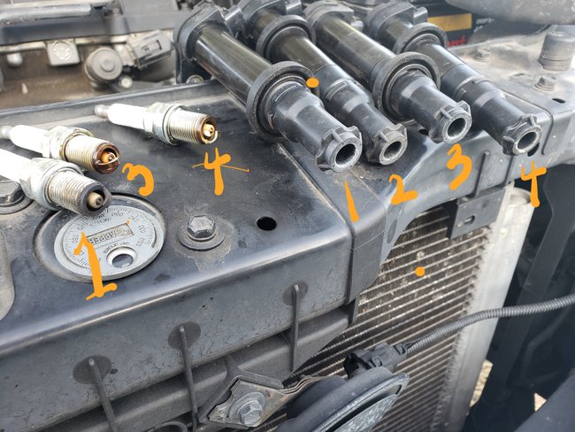

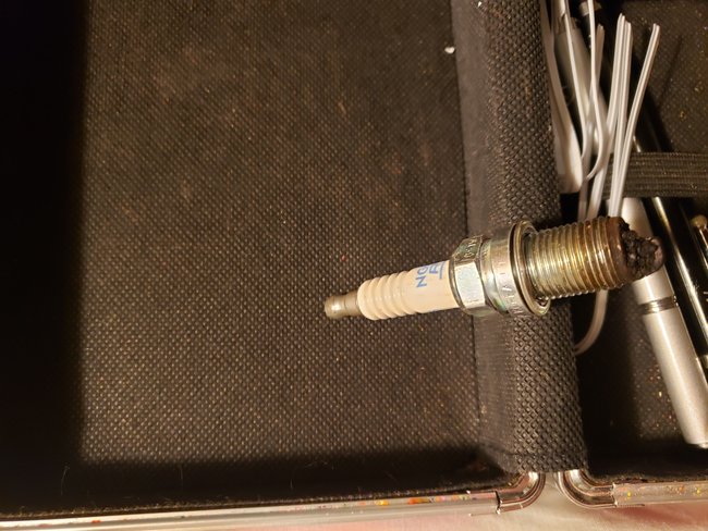

Hello again.
Yeah, those plugs are terrible. Definitely needed replacement. Be sure to gap between .039-.043 in. Hope this helps and thanks for again using 2CarPros.

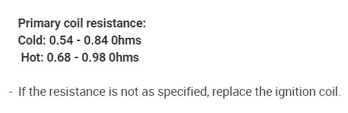

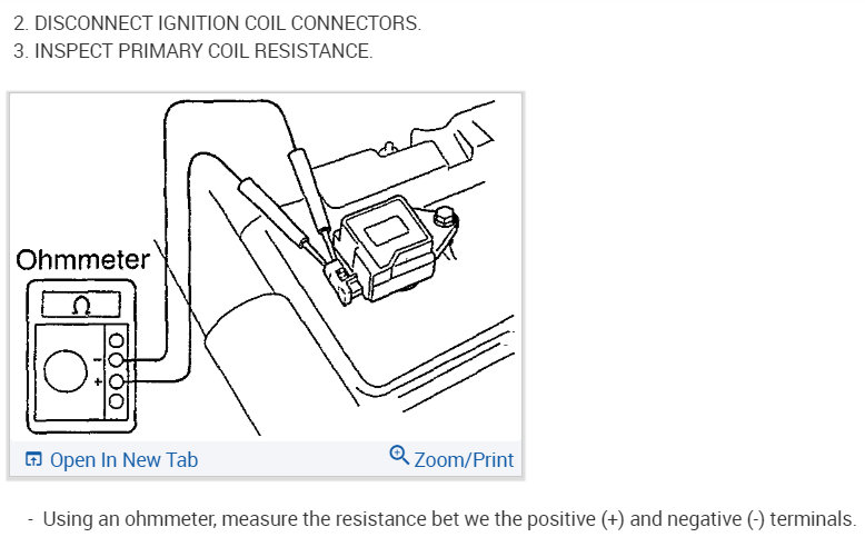

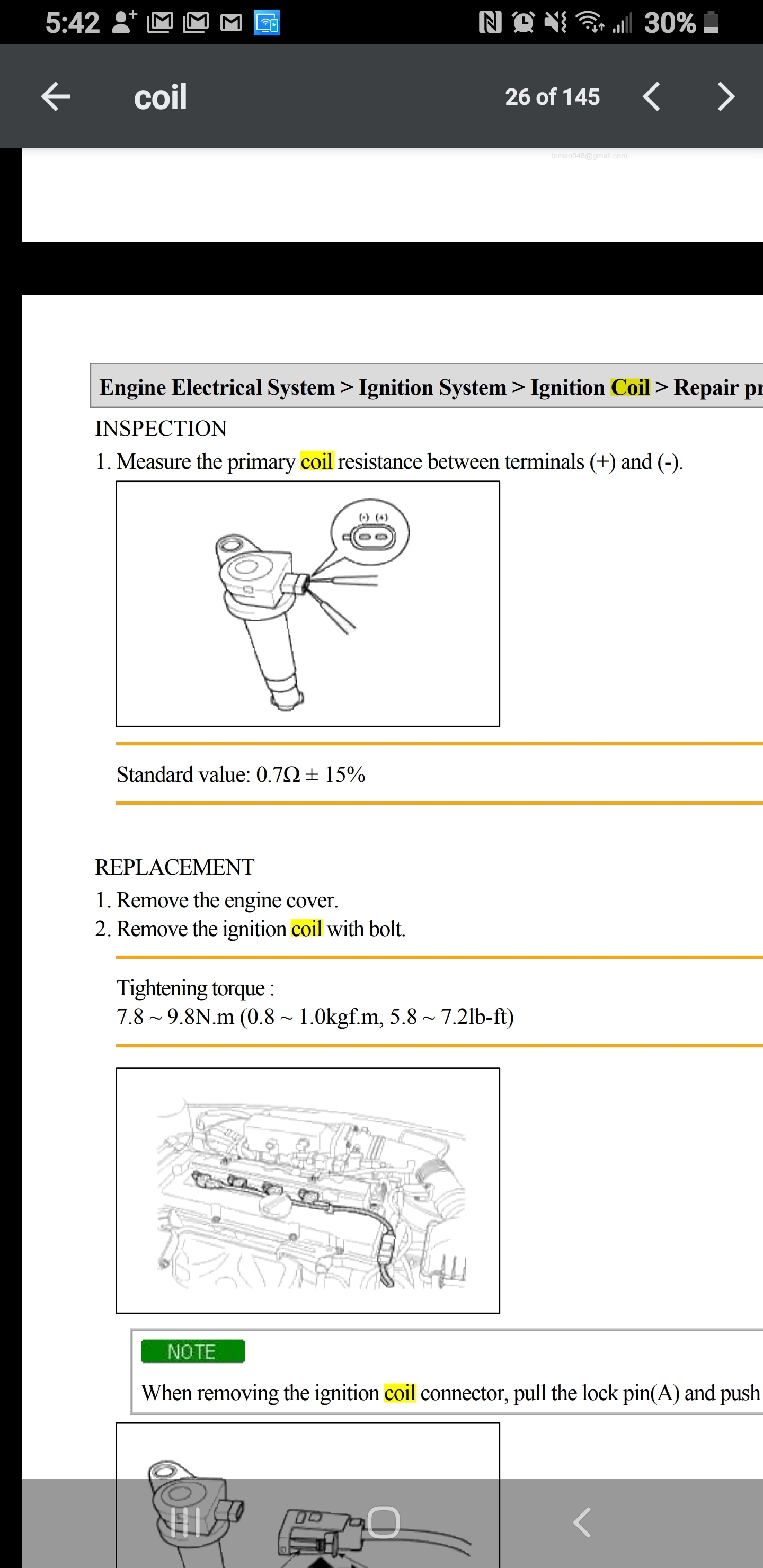

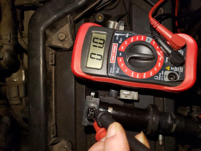

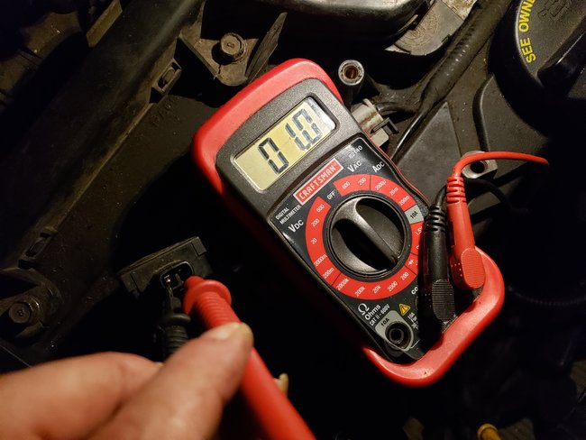

I get 1ohms on all the coils with the multimeterset at 200ohms. If I set it at any other setting for ohms it reads 0. Does that mean they need to be replaced?
Aug 18, 2020 at 4:08 PM
No, not at all.
The real way to test coils is with a scope to see what voltage is being sent to the plugs.
That would be part of the diagnostic from a shop unless you have a scope.
