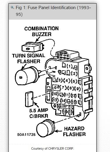

Fuse panel location picture of the flasher relay
2001 JEEP CHEROKEE
200,000 MILES
RENEE AUSBUN

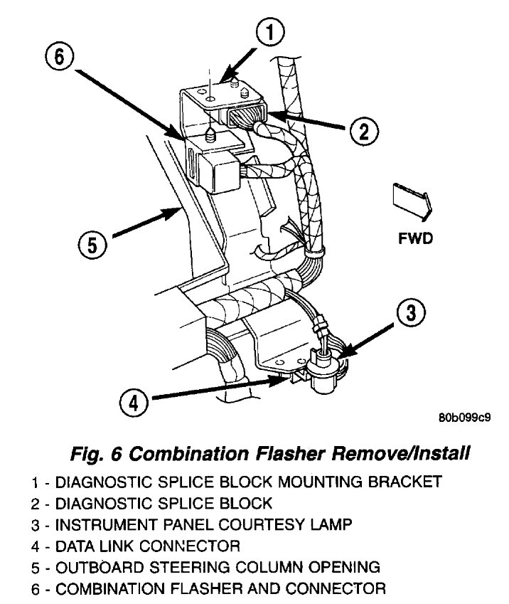

Would like to see a picture of the flasher relay panel.
Oct 27, 2019 at 2:05 AM
  • 55,433 POSTS
Here is a guide to help you check the fuse and the fuse panel with locations as well:
and
https://www.2carpros.com/articles/turn-signals-not-working-blinker
Oct 28, 2019 at 6:50 AM

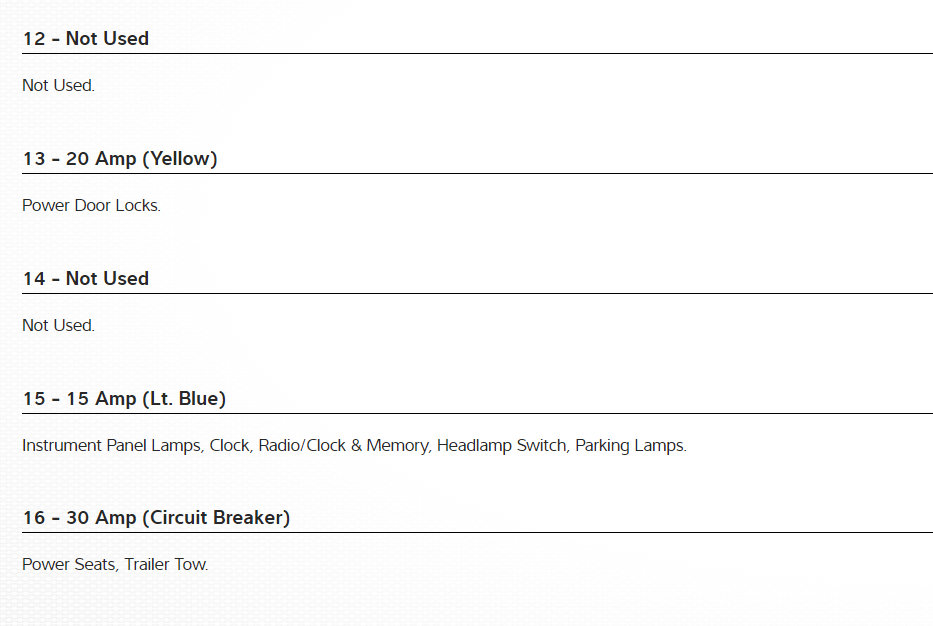

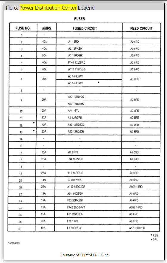

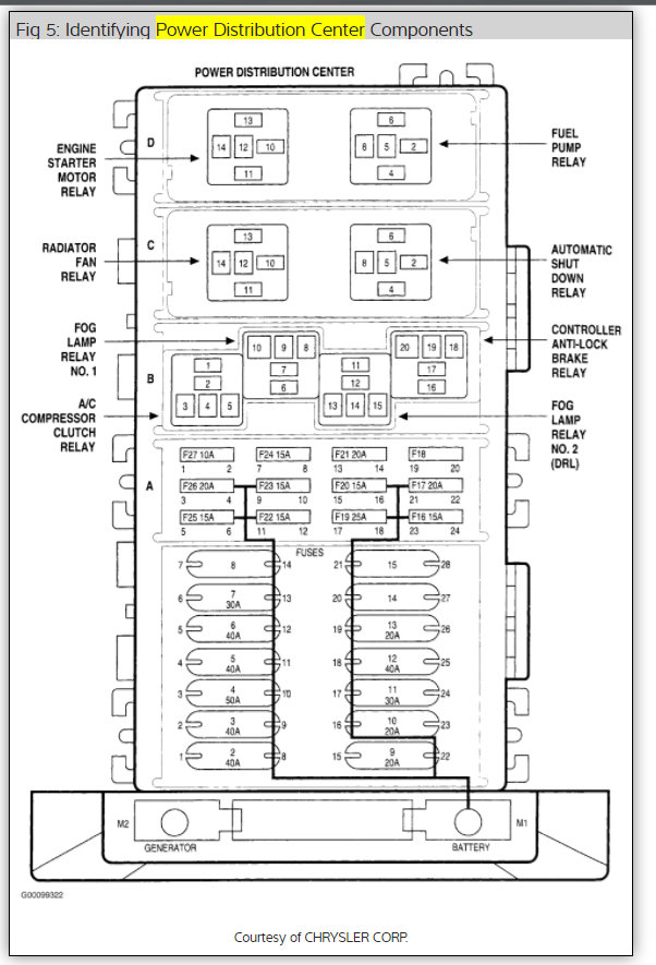

BMRFIXIT
  • 19,053 POSTS

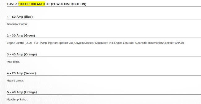

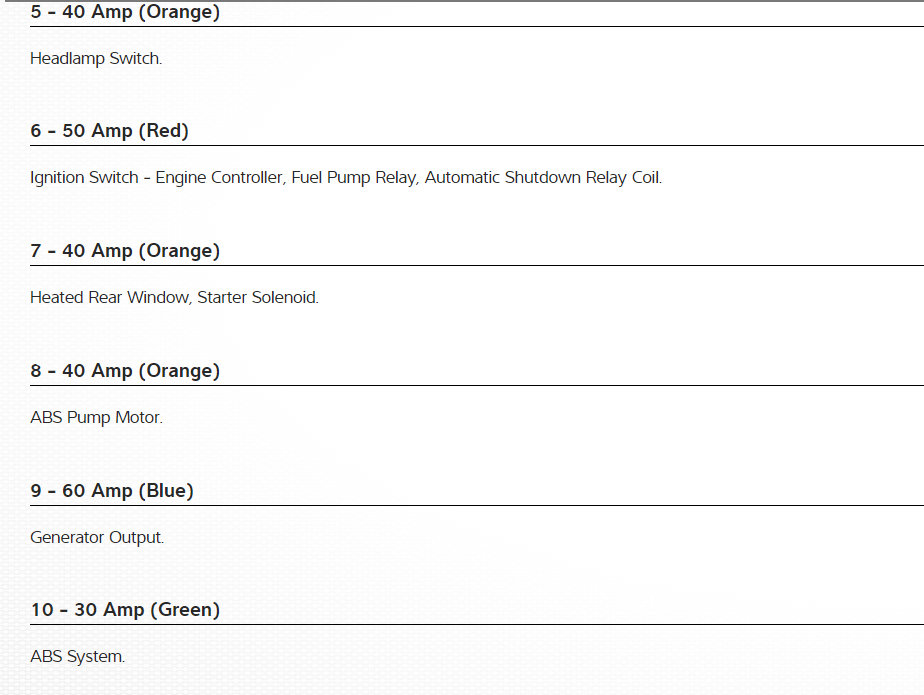

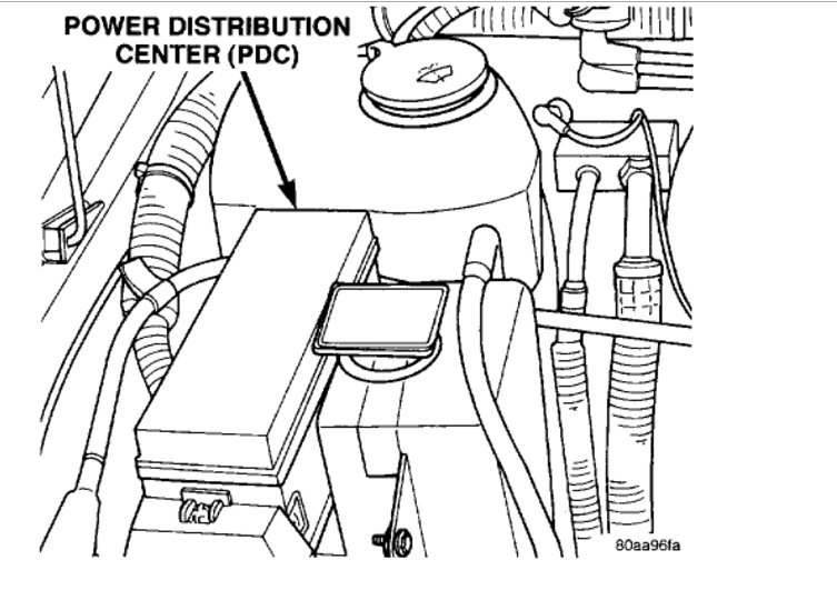

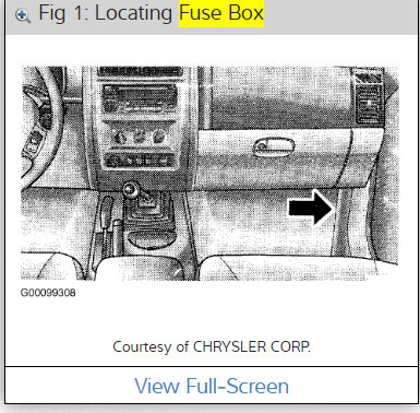

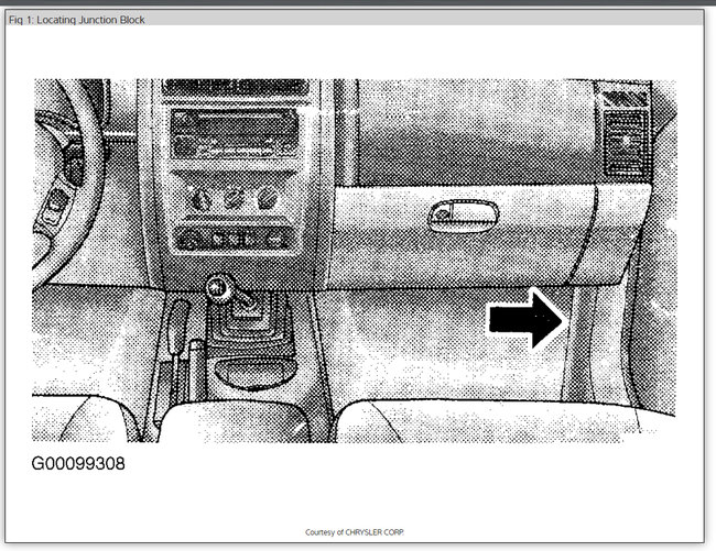

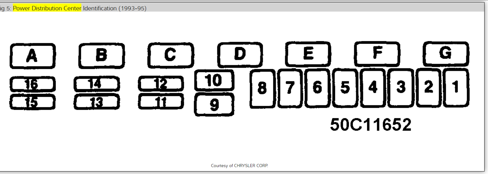

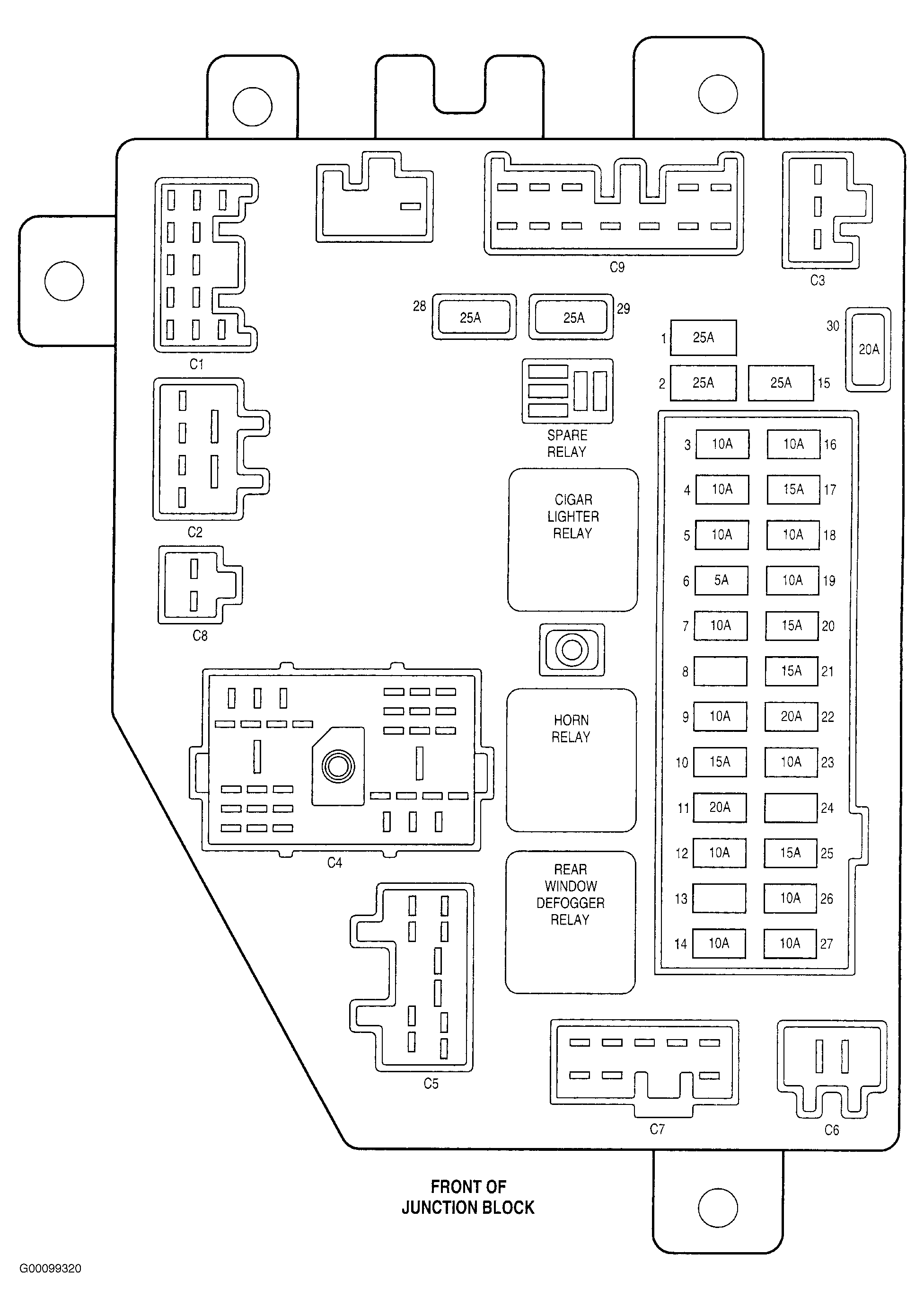

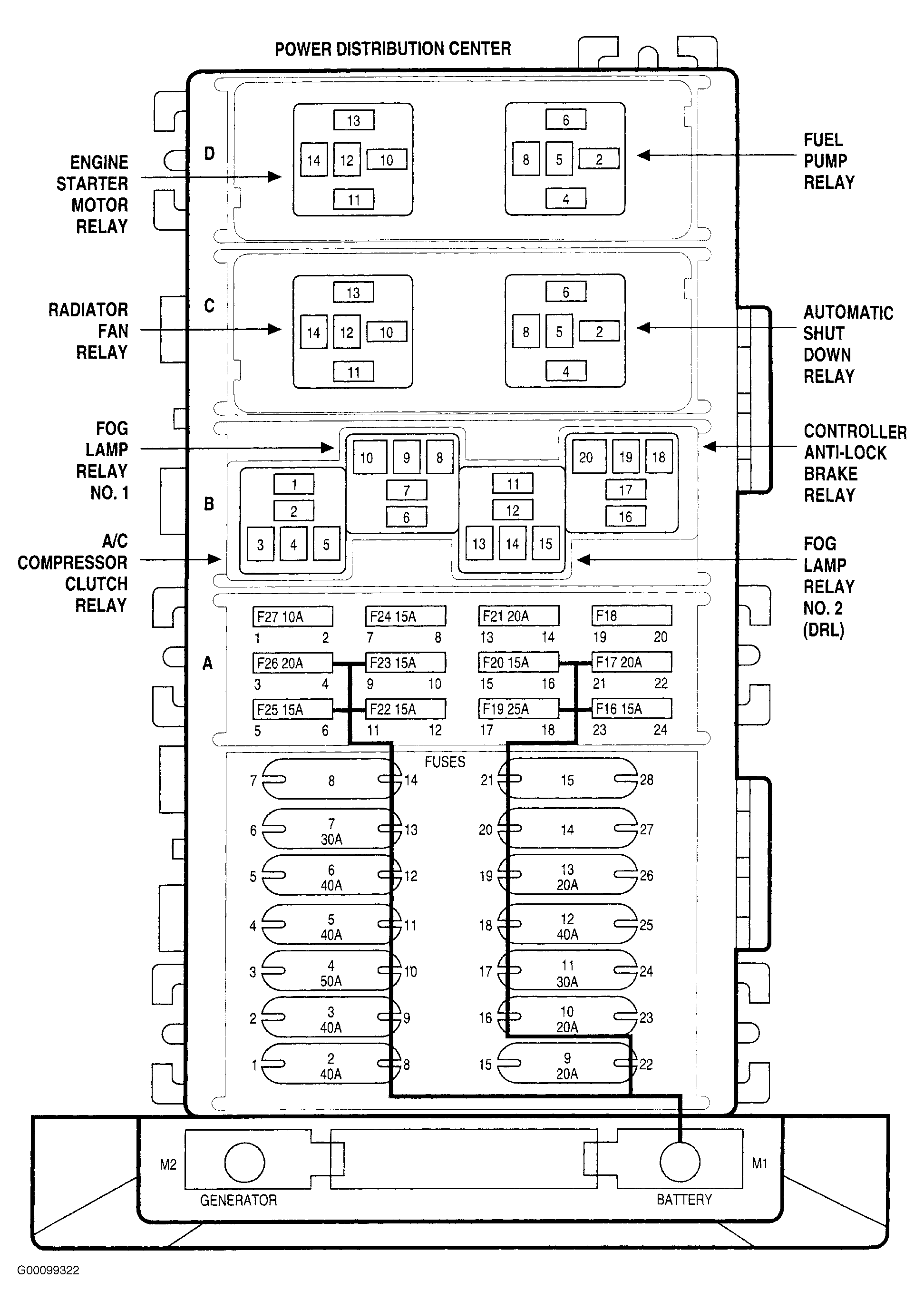

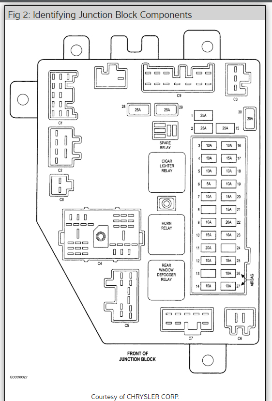

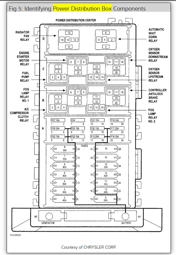

Fuse box /power distribution center. Click on the images below to enlarge them:
Aug 4, 2020 at 10:55 AM (Merged)

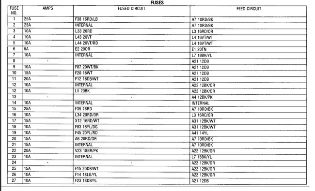

Here is a guide and more diagrams (below) to help you get the job done and fix the problem.
and

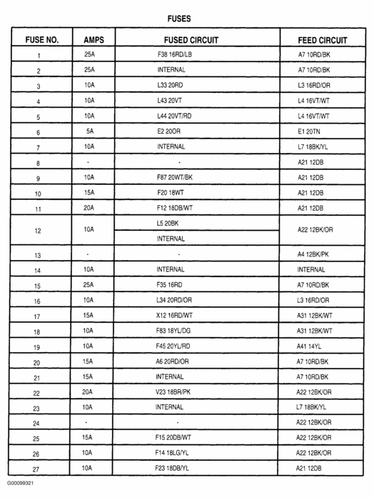

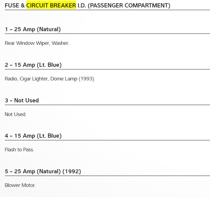

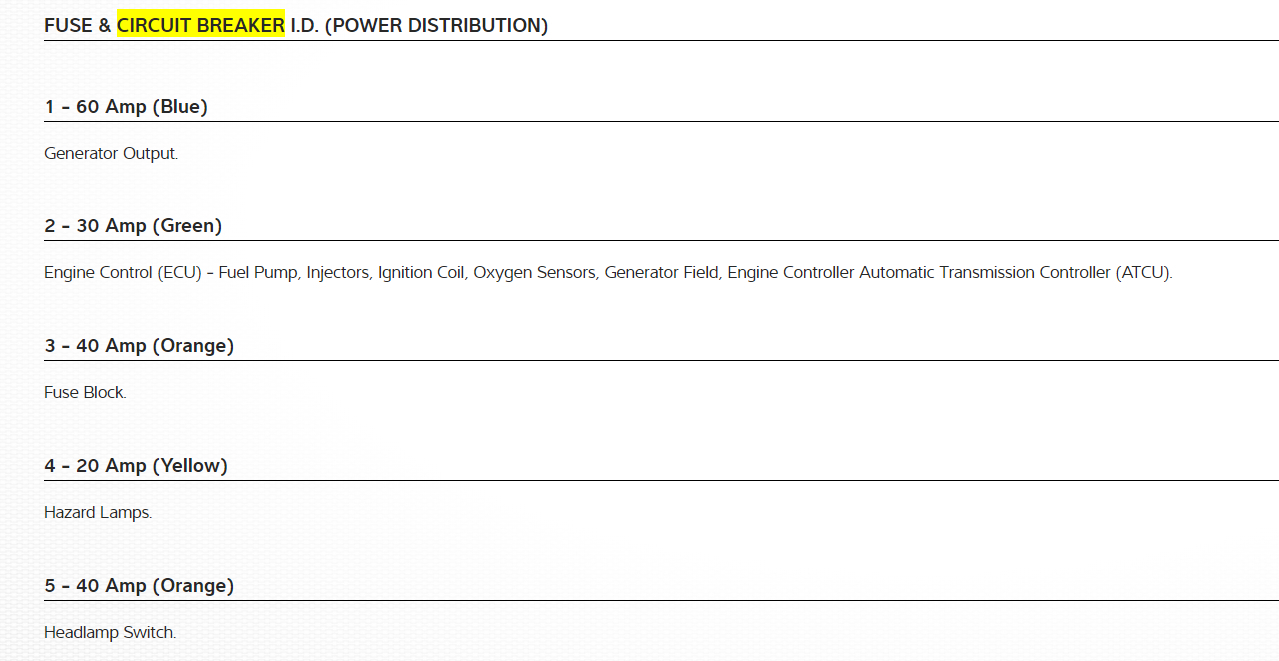

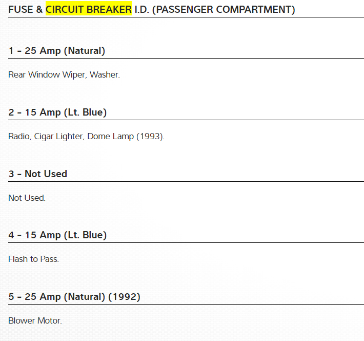

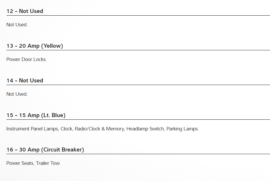

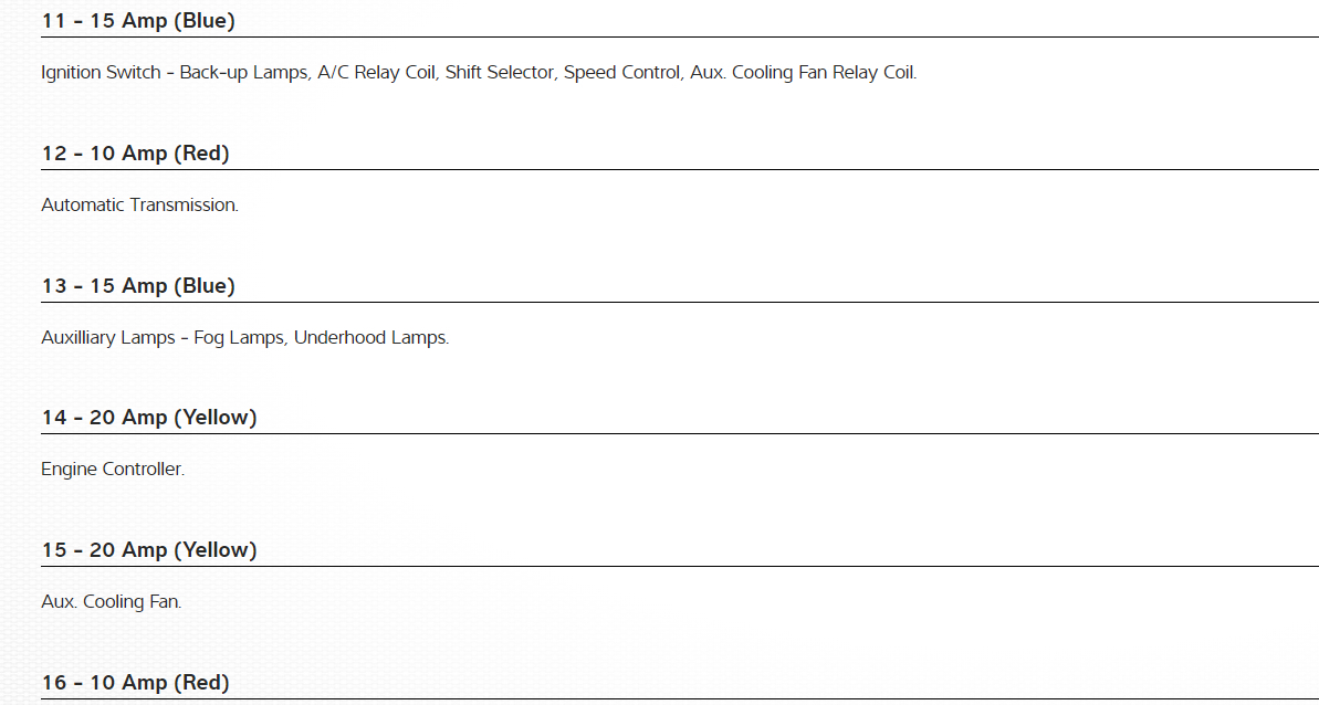

JANDREWS

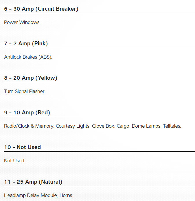

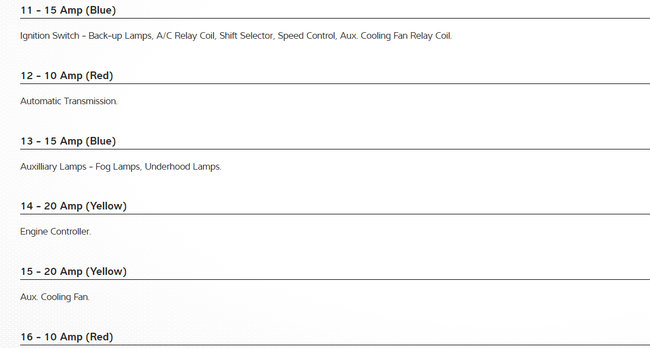

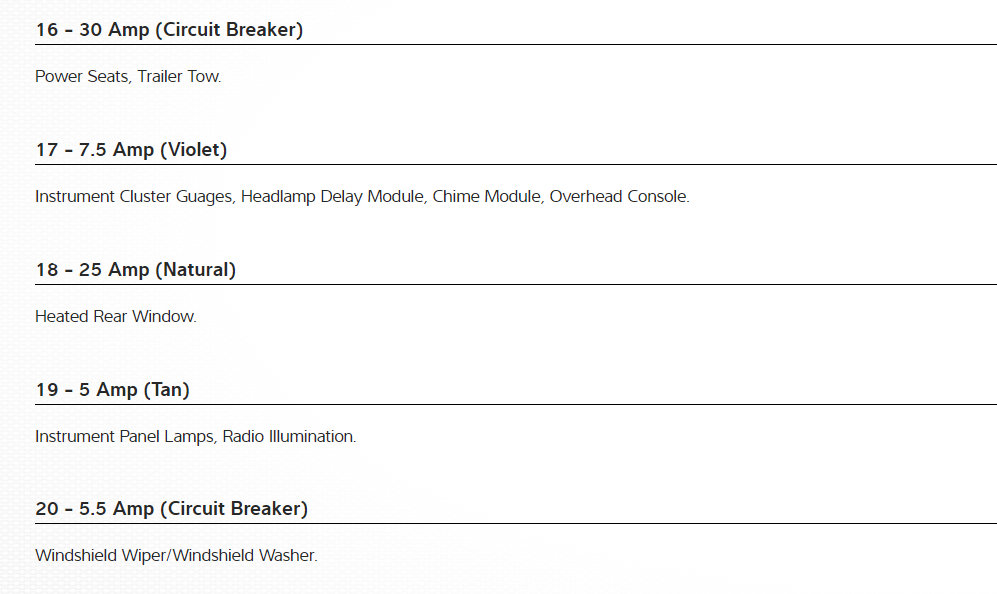

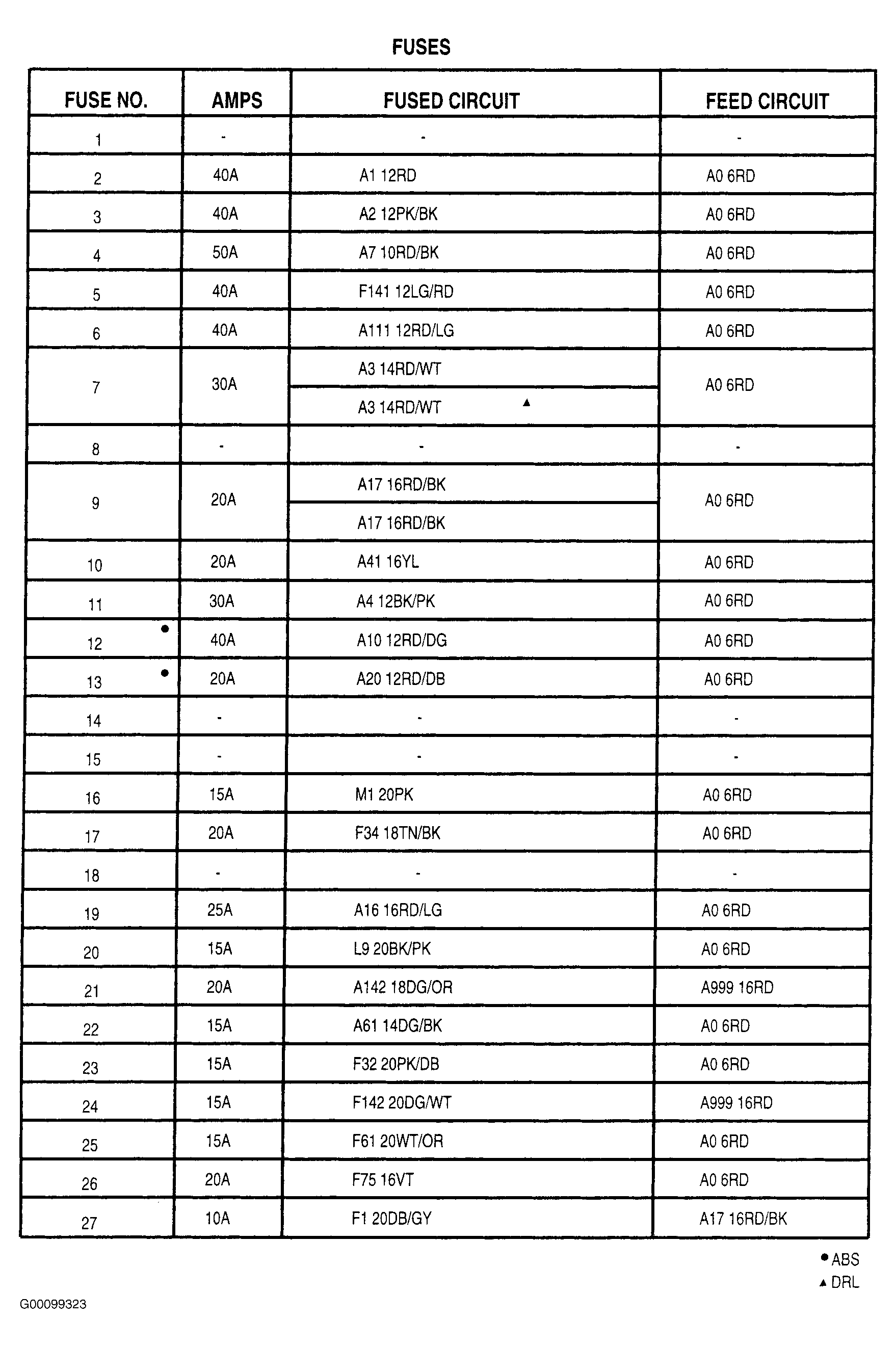

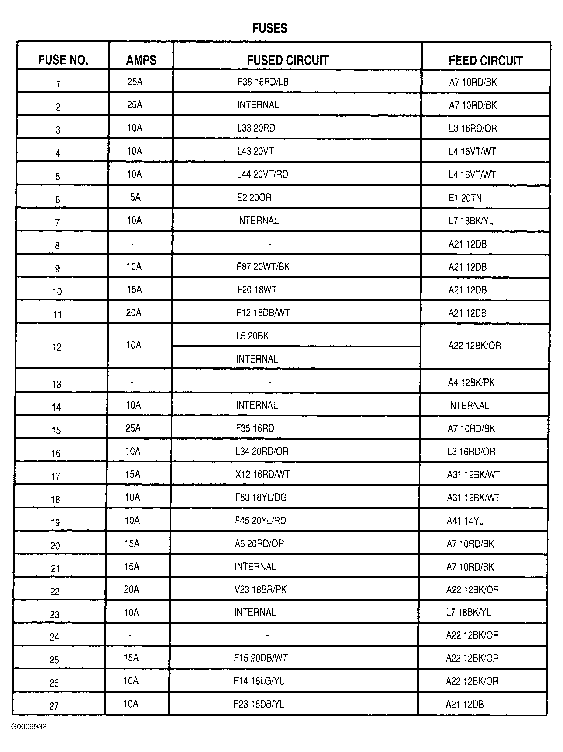

I would like a diagram of some sort to tell me what fuses go to what.
Aug 4, 2020 at 10:56 AM (Merged)

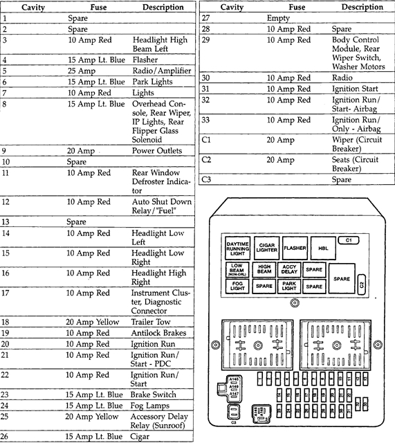

BLUELIGHTNIN6
  • 16,542 POSTS
interior fuse block legend is attaced

Check fuse no.22 if okay and there's power at the pink and dark blue -adjust or replace the brake switch

YANKEEFRANK
  • 13 POSTS
I remove a small black relay instead of the red one that I needed...Now I do not know which slot it goes into...

JDL
  • 16,098 POSTS

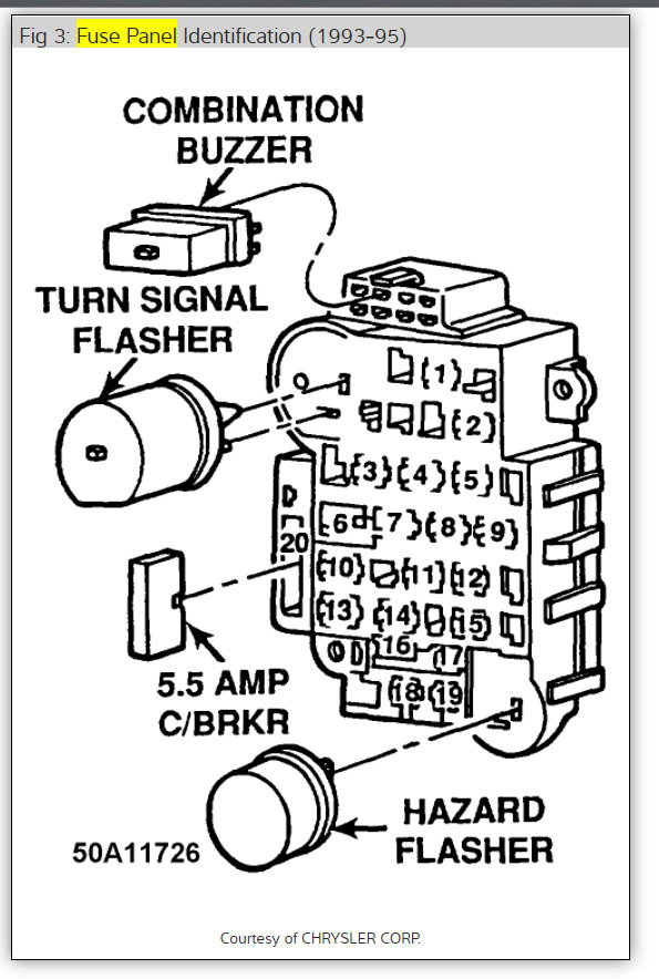

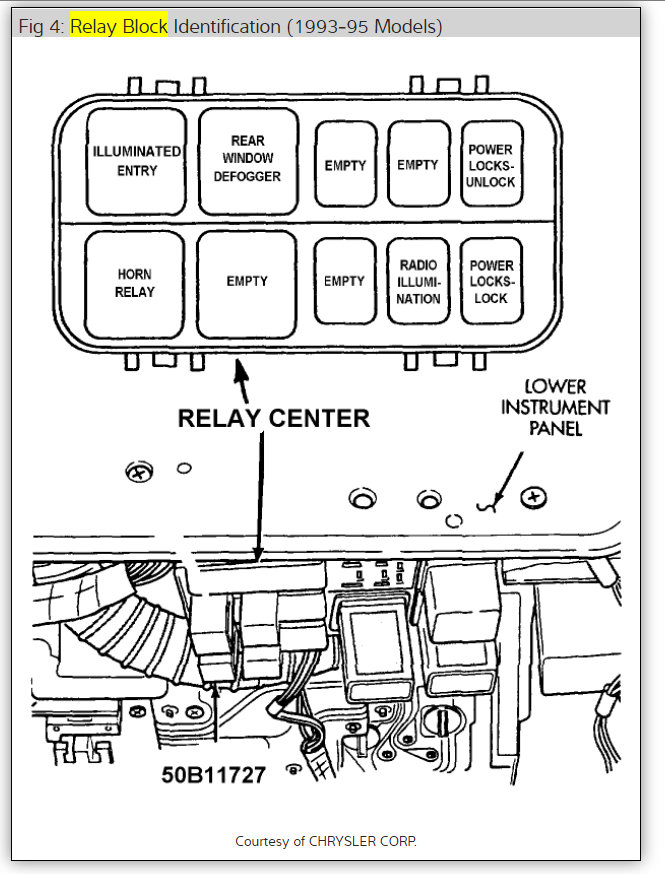

Here is a guide to help you check the fuses and the the fuse panel location and diagrams below.
Check out the diagrams (Below). Please let us know what you find.
Aug 4, 2020 at 10:57 AM (Merged)
YANKEEFRANK
  • 13 POSTS

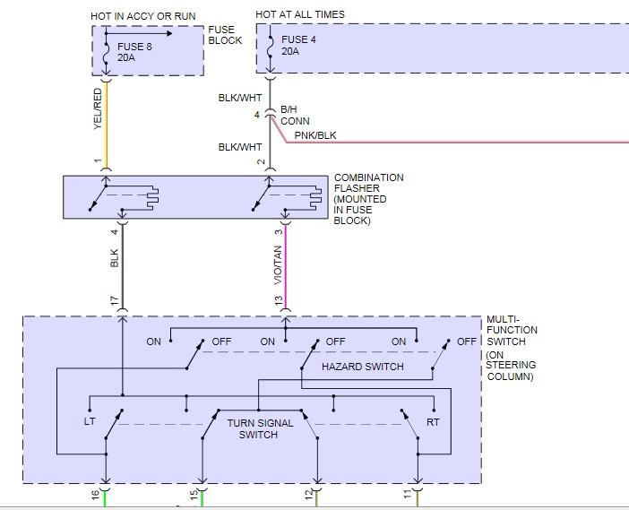

Yes it helps a bit...however, the diagram you provided is correct to a point...instead of being the horn relay, I have a blue relay (Chrysler #56007348) that is the dual flasher (which I assume does both hazard AND turn signals)
Regards,
Yankeefrank
JDL
  • 16,098 POSTS
Hi, which Cherokee is it, sport--limited--or what? I would think they would be the same? I'll take another look.
JDL
  • 16,098 POSTS
Yes, 93--94, the horn relay is correct. 95--the flasher is in that spot, and the horn relay is in top left empty spot, diagram, no. 5 spot.
I just didn't read far enough in the info.
YANKEEFRANK
  • 13 POSTS
Replaced the relay in it's correct spot, still don't know why turn signals don't work..
JDL
  • 16,098 POSTS
Did you check the fuses? Did you check voltage at fuse circuits. Usually the turn fuse circuit goes hot with the key on. The flasher fuse circuit should be hot all the time.
It's possible you will have to check the multifunction switch? If so, make sure you disarm the air bag before working on steering column.
YANKEEFRANK
  • 13 POSTS

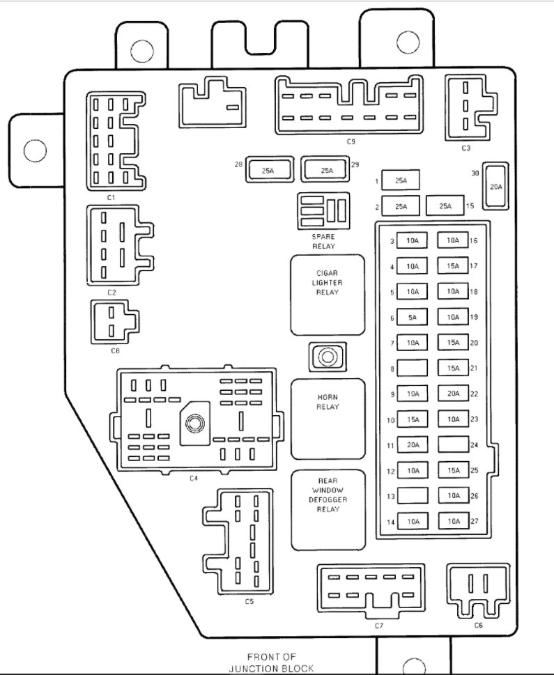

Going by your drawing, there is NO fuse in number 8 slot...never been one as there is only 1 contact in the slot. Hazards work, tried a new relay didn't help. Have power in one slot where relay goes nothing in others when turn signal is in left/right position. Everything points to multifunction switch. Just don't understand why it happened all of a sudden.

I know now that the Sport wiring diagram is different than a regular Jeep. The hazards work, the flash to pass works and the wipers work. I tried a new flasher (hazards/signals) and still didn't work. I have tested and removed for inspection all of the fuses. The horn, turn signals and rear window heater relays are on a block under the drivers knees right of the steering wheel column. Any idea?
JDL
  • 16,098 POSTS
Our database says fuse block under left side of dash. If our database is wrong about fuse block location and the wiring diagrams are wrong, I'm not sure how to help?
It does show relay block to the right of steering column. I'm not giving up yet.

In the fuse block to the left, is there a fuse 8--20 amp?
As far as your other question, I'm not sure.
YANKEEFRANK
  • 13 POSTS
Nothing is slot 8....never had one...
JDL
  • 16,098 POSTS
Our database shows a fuse 8 in left fuse box. Either our database is wrong or I'm looking in the wrong place? I've looked at other databases, same fuse 8--20amp.
All I can do is hope the wiring colors are correct from flasher to multifunction switch for turn signals. Then look under the dash for proper wire color going into steering column. Should be multiwire electrical connector where wires go into steering column, check voltage on that wire, key on, turn switch on. If no voltage backtrack the wire.

Just to add, this diagram says it is for 95 jeep Cherokee sport 4.0L.

In one of your posts, didn't you say only one hot terminal at flasher? My thinking is, should be two hot terminals with key on, one hot terminal with key off.
How many pins on flasher? Are there pin numbers? Even with one hot pin, using a jumper, you should be able to check hazard and turn, they just won't flash, should lite-up.
If turn signals will lite, one side then the other, then I think problem is before the flasher. If they won't lite up, then I think the problem is in the steering column, wiring or multifunction switch.

YANKEEFRANK
  • 13 POSTS
I've attached a photo of the fuse block. .as you can see there is no fuse in #8....
