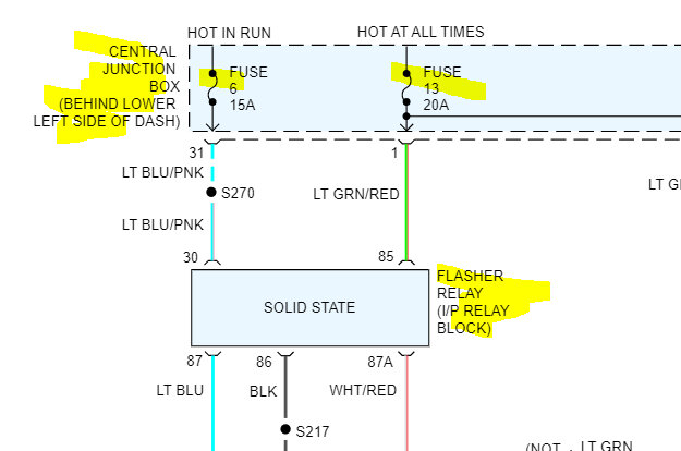

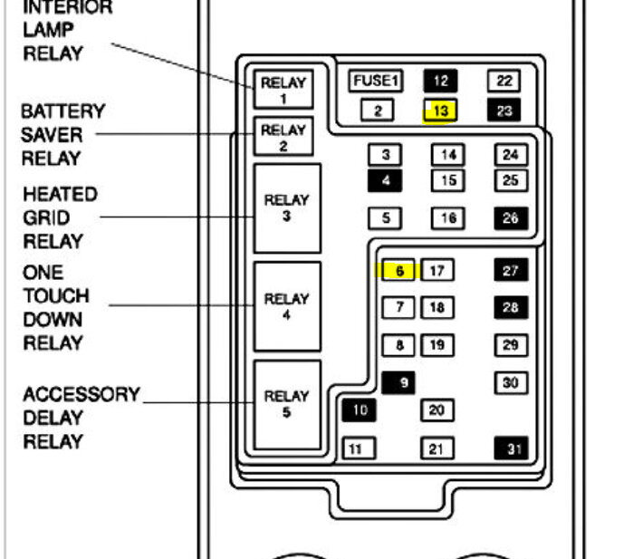

Signal lights are not working.
May 4, 2023 at 2:55 AM
  • 110,251 POSTS
Hi.
Does anything happen when you turn them on? Do the hazard lights work?
I attached a pic below showing power to the flasher and then to the signal switch/hazard switch. First, check to make sure the fuses are good. If they are, make sure there is power to and from them.
Here is a link that you may find helpful:
If the fuses are good, the next thing is the flasher relay.
Let me know what you find and if anything happens when you turn the signals or flasher on.
