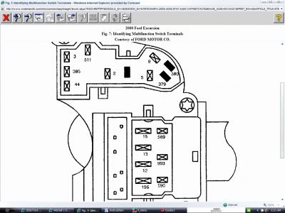

we have a v10 and the turn signal will not light up in the dash or on the outside. we have checked everything. the brake lights also do not work. please help .
Apr 19, 2008 at 4:34 PM
MERLIN2021
  • 17,250 POSTS

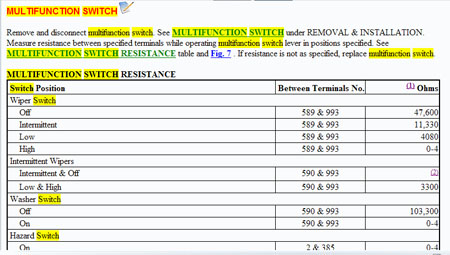

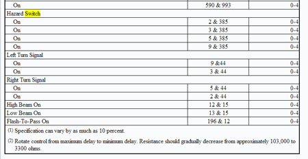

Test the multifunction switch, and did you check the fuses under the hood?
https://images.2carpros.com/forum/automotive_pictures/62217_Multi_SWa_1.jpg
https://images.2carpros.com/forum/automotive_pictures/62217_Multi_SWb_1.jpg
https://images.2carpros.com/forum/automotive_pictures/62217_Multi_SWc_1.jpg
