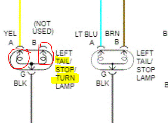

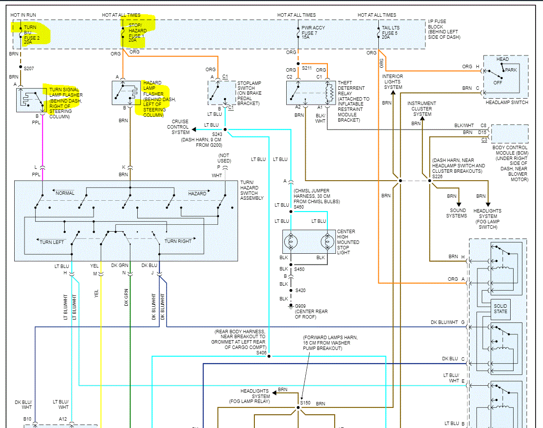

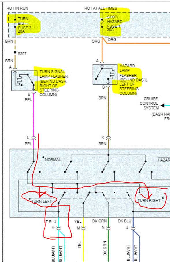

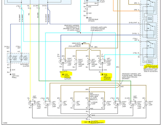

If you look below, I attached the wiring schematic below for the exterior lighting and highlighted a few things for you to check. As far as the ground, there are several different ground locations for the lighting. Note that the hazard light and the turn signals both have different power supplies, so confirm the fuses are good and they have power.
Take a look through the schematic below. See if there is anything that is helpful.

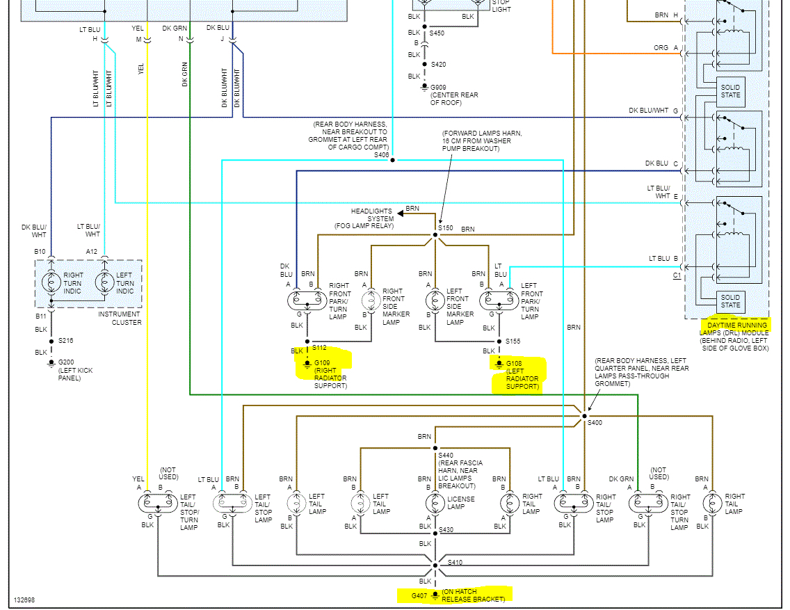

You shouldn't have continuity to ground on both wires. One is power and one is ground. When the signals are off, you should have an open circuit. Based on that, it sounds like we have a ground issue which is somehow back-feeding power.
Do me a favor. Review the schematic above and check the black wires at the affected sockets for continuity to ground. There will be two other wires (see schematic for wire color and what they power) and test them for 12v when either the brake lights are on or the turn signal.
Looking at each of the bulbs in the schematic indicates they have two elements in each bulb. That allows the park lights to remain on (one element) and the brake light (another element) to illuminate at the same time. I think we have something mixed up at the socket or you may have gotten a single element bulb. The rear should have a 2057 and the front a 3157 (different socket design same type of bulb). Is that what you have?

Let me know. I copied and indicated power flow out from the switch. Note that both the left and right signals have the same power supply. With that in mind, power is present.
You may want to go to the signal switch and locate the light blue wire to see if there is power to it when you have the left signal on. If there isn't power right at the switch, the switch is my first suspect.
See pic below.
