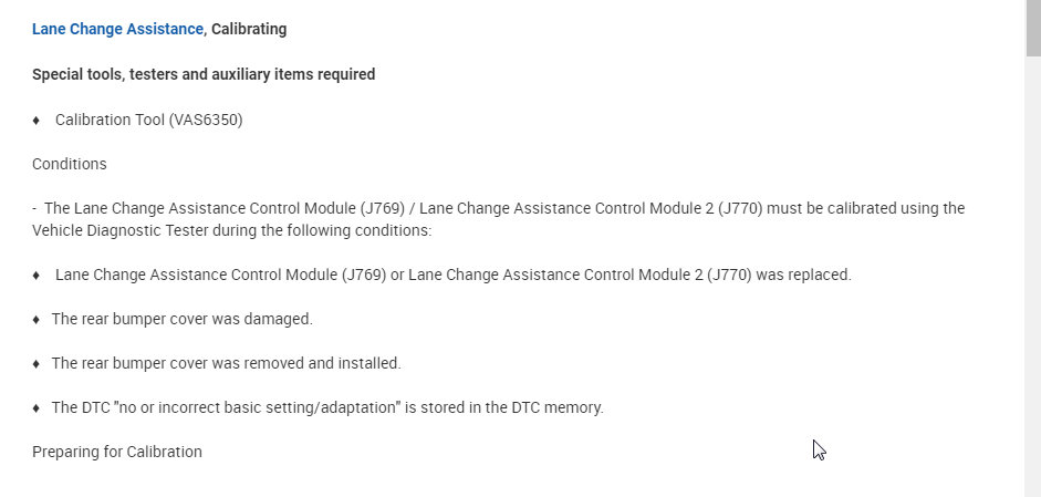

There are a number of things that could cause this. The module itself, wiring issue, water intrusion in the circuits.
Long story short, just replacing the module may fix your issue however, you will not be able to calibrate it without the attached tools and process.
I did not include the entire procedure because it is lengthy and you will need all the tools attached in order to do it and I have never seen a DIY'er have any of them. Which means you will need a shop to calibrate it.
The DTC's are telling you that the module is trying to self calibrate which it does frequently so that it is always accurate and it is not able to do this for some reason. This is not a common issue with Audi's but unfortunately things do fail and there is no telling when they may fail. If the OEM's built vehicles that never failed, none of us would be able to afford them because the components would make the car too expensive so unfortunately this means cheaper parts break. Not to say the vehicle is cheap but compared to one that was built with the highest possible quality parts that would never break, it is cheaper.

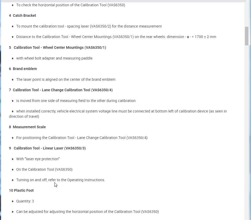

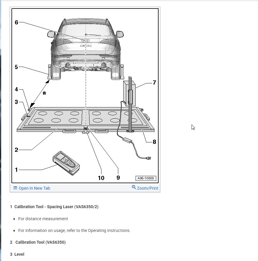

There are lot of used sensor/module listings. I'm wondering, since these are pre-calibrated from the original vehicle, if I just buy the used one and plug it into my vehicle, will that work like plug and play? Or Do I need to make the car computer learn to recognize this new(used) sensor/module?
Dec 23, 2024 at 10:01 AM
  • 55,423 POSTS
You can try it but it says in the instructions that it needs to be calibrated. Click on the first diagrams above and it will show you how.
