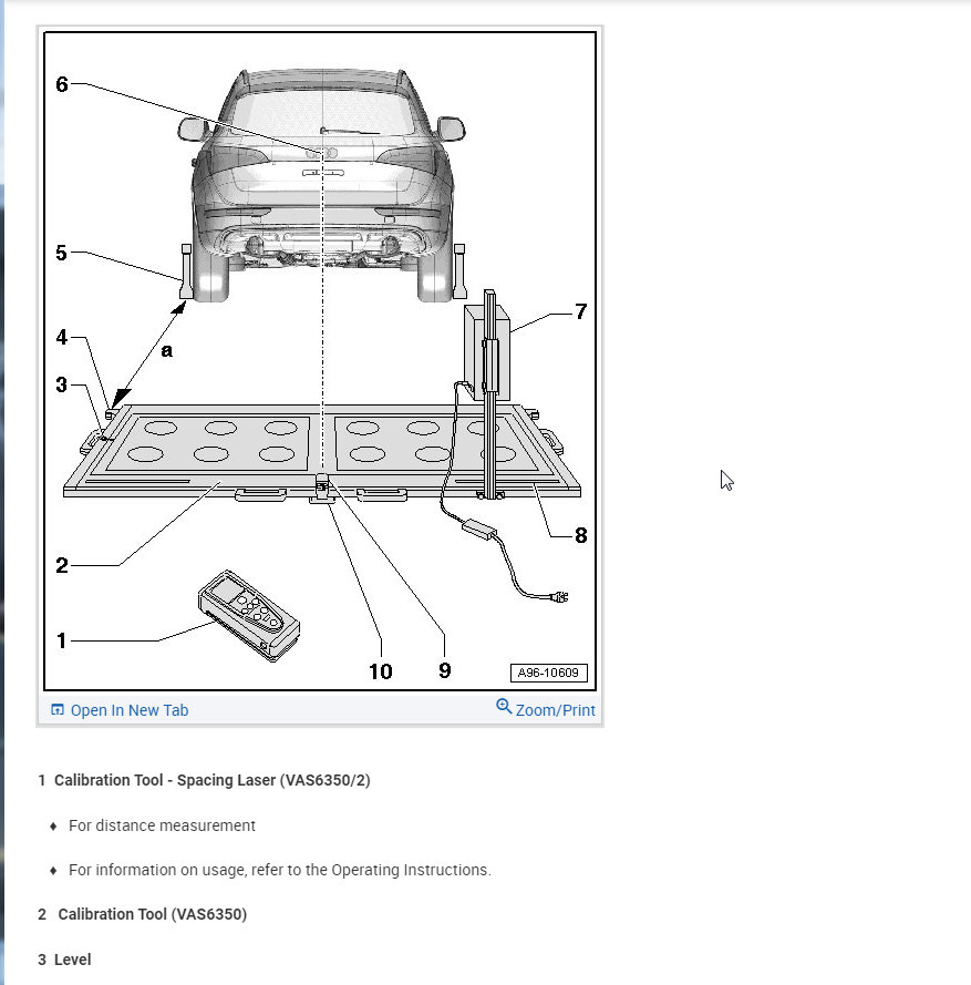

There are a number of things that could cause this. The module itself, wiring issue, water intrusion in the circuits.

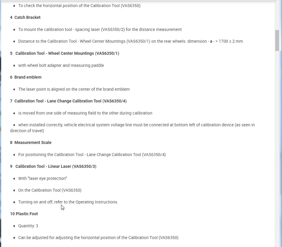

Long story short, just replacing the module may fix your issue however, you will not be able to calibrate it without the attached tools and process.
I did not include the entire procedure because it is lengthy and you will need all the tools attached in order to do it and I have never seen a DIY'er have any of them. Which means you will need a shop to calibrate it.

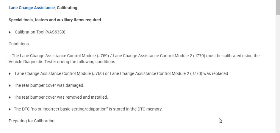

You can try it but it says in the instructions that it needs to be calibrated. Click on the first diagrams above and it will show you how.
