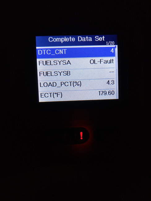

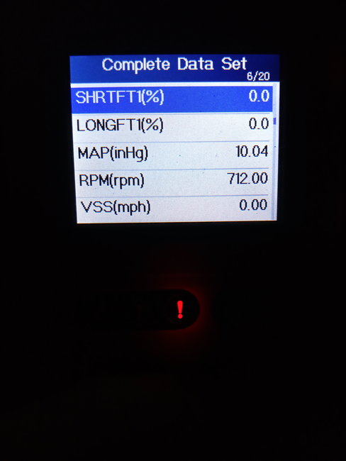

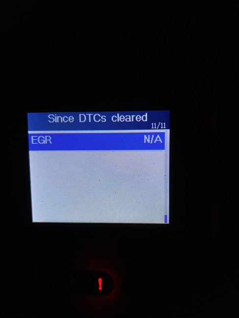

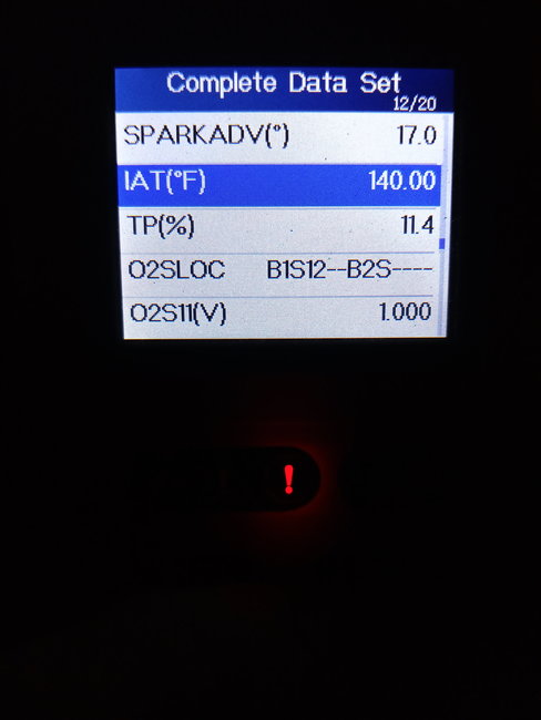

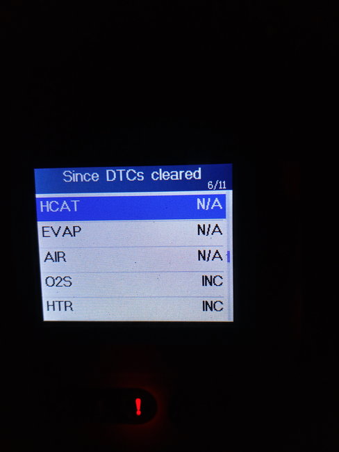

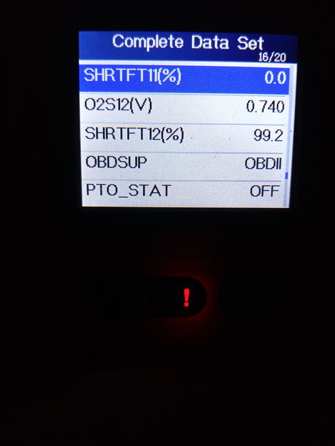

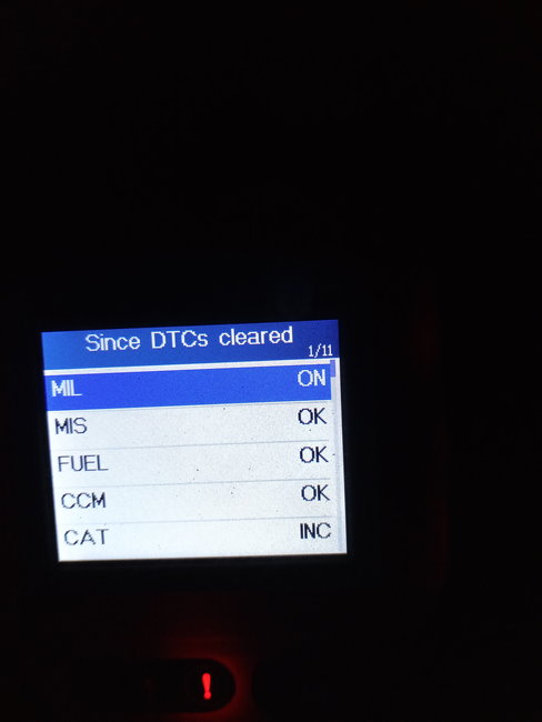

When I took these pictures it was running fine.
Wednesday, March 10th, 2021 AT 6:26 PM

When I checked for vacuum leaks I didn't hear anything, but I didn't spray anything on the hoses I just checked to see it there was any wear and tear holes or splices and didn't see anything like that.
Wednesday, March 10th, 2021 AT 6:35 PM
  • 110,071 POSTS
I would take it one step further. It's hard to see if there is a gasket problem or leak in a vacuum hose.
