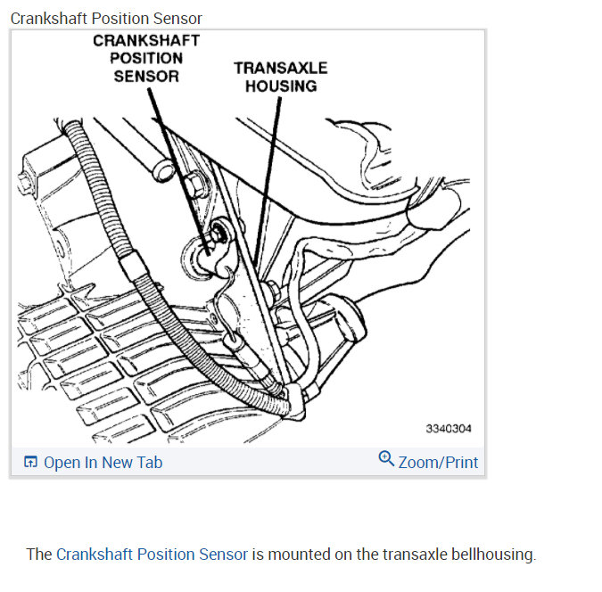

This guides can help you get the codes as well as the on, off trick. Also I have seen the crankshaft angle sensor cause this issue as well.
When the crank sensor goes out it may not leave a trouble code btw. Here is the sensor location. Check out the diagrams (below). Let us know what happens and please upload pictures or videos of the problem.

I located the crankshaft sensor and it's in a really hard spot to get to and I don't have the right extensions to go at it from the top so I'm trying to figure out how to get to it. Sorry it took so long for me to reply if I start it up today I'll take a video and show everyone what it does. A buddy is also going to let me borrow his obd2 code reader today. I'll also send video of those results as well. thank you

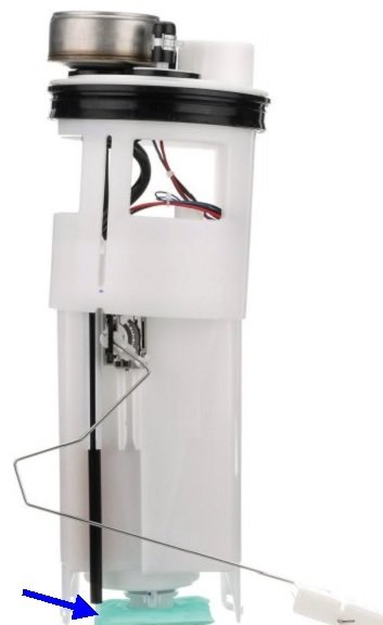

You've been describing symptoms very much like when the strainer in the fuel tank becomes plugged. When you replaced the fuel pump, if you replaced the complete housing assembly, you got a new strainer as part of it. Most people just get a pump and motor that has to be transplanted into the old housing. The more expensive ones come with a new strainer that has to be snapped on separately, but they can't be replaced separately on some models. This is where you need the fuel pressure gauge to see what's going on. If the strainer is plugged, you'll see fuel pressure slowly drop until stalling occurs. It will pass fuel again after sitting for a few minutes. Stalling is also more likely to occur when the highest volume of fuel is being pumped, which is during coasting.

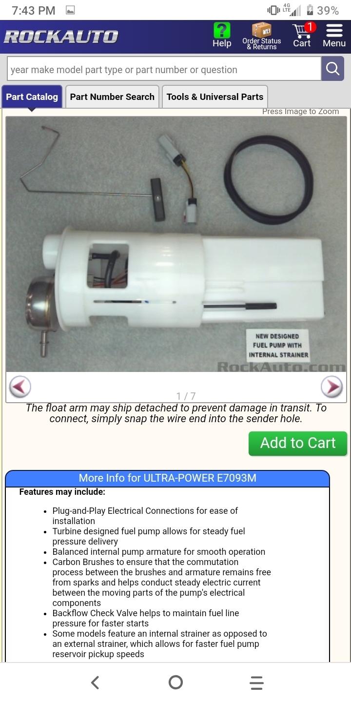

This is the one I got and took it to the mechanic he changed it all said he test drove it for a few on his drive he shut it off turned it on 3 or 4 times then headed back to the shop and like I said when I got it back I drove all over town no problem til the next day but I feel like it does do what you just said but it also dies when I let it idle to long and I cleaned the idle air control sensor which helped it out alot I cleaned the fuel injectors today thought maybe 1 was clogged but it shut off after about 30 minutes of idling and it came right back on left it on until it shut off after about 20 minutes then wouldn't turn back on so I went back inside.

Dandy. That's the complete assembly including the strainer at the bottom. I did have a second strainer become plugged on my '88 Grand Caravan, but that was after another 200,000 miles.
I haven't run into this for quite a while, but repeat fuel pump failures used to be not uncommon. You'd buy an aftermarket pump, stick it in, then it would fail after a week or two. Get it replaced under warranty, and it too would fail after a couple of weeks. Try one from a different auto parts store, and it also failed after two weeks. By the time you got frustrated after the fourth or fifth pump, you'd buy one from the dealer and have no more problems.
The cause actually had nothing to do with where the pumps were coming from. In fact, Napa gets their Chrysler pumps from the same supplier that sells them to Chrysler. What was happening was microscopic debris had collected in the tank, and that was plugging the impellers in the pumps. It was just coincidence that by the time you bought the one from the dealer, all that debris had been collected and was no longer in the tank.
This was common enough that a service bulletin was issued telling us to have the tank steam-cleaned at a radiator repair shop any time the fuel pump had to be replaced. That did indeed stop the repeat failures.
After discussing this with a friend who runs a small engine repair shop, he showed me a sample of how mold grows in the ethanol in today's gas. I have to wonder if that contributed to the fuel pump problem.
We've also found that GM and Chrysler fuel pumps almost always fail in different ways. GM pumps slow down or lock up after you've been driving a while, leaving you sitting on the side of the road. They're also relatively noisy and easy to hear running, especially on their trucks. It is extremely rare for a Chrysler fuel pump to stop running once it has started up. They are built to tighter tolerances which makes them real quiet, but more prone to locking up from debris. Their pumps fail from worn brushes in the motor. That causes them to fail to start up, leaving you sitting in the parking lot or driveway. If they do start up, or if you get them going by banging on the gas tank, they'll keep running until you stop the engine.

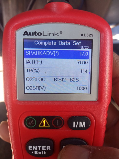

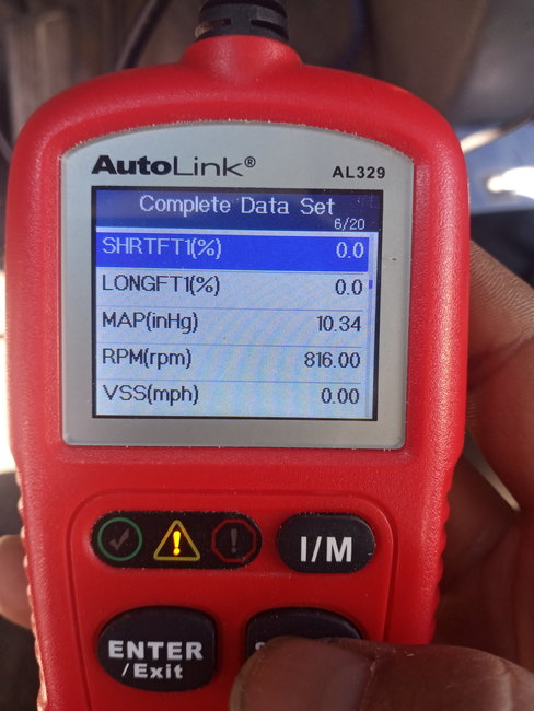

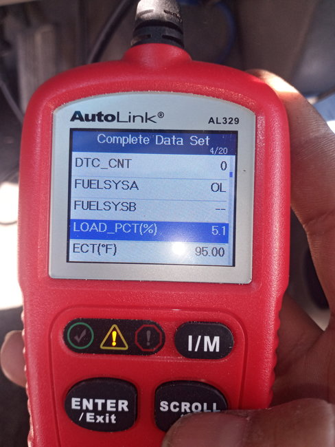

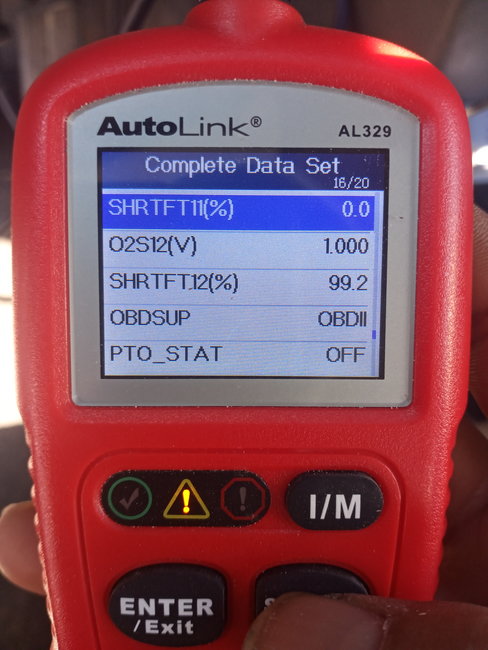

96DODGERAM
  • 63 POSTS

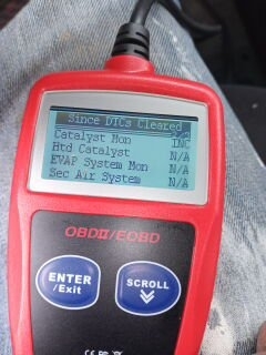

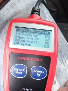

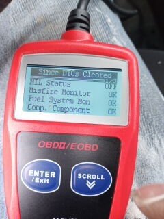

Here's the readings I got on my obd2:
Mar 9, 2021 at 1:29 AM
  • 110,240 POSTS
I looked at your pics. The short-term fuel trims are indicating fuel being added. Have you checked for vacuum leaks or the fuel pressure? Also, the coolant temperature sensor says 95°F. Was this done as soon as the vehicle was started and still not at operating temperature?
Mar 9, 2021 at 9:16 AM
96DODGERAM
  • 63 POSTS
Yes, it was it was hard to start so I hooked it up and then took the pictures like 5 after it was idling. I don't know how to check vacuum leaks and I need to get paid before I can get a fuel pressure gauge and then I can send that info.
Mar 9, 2021 at 9:32 AM
  • 110,240 POSTS
If it was running for five minutes, the ECT should have been higher. I'm starting to question if that is the issue.
Do me a favor. Allow the engine to reach operating temperature. See what the ECT signal is at that point. It should be around 200°f.
Also, here is a link that explains how to check for a vacuum leak:
Let me know what you find.
Mar 9, 2021 at 9:39 AM
96DODGERAM
  • 63 POSTS
Okay, I'll do that and I do know that when it's warmed up it stays around 180-200 f.
