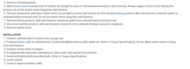

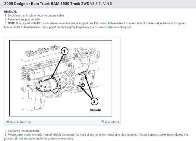

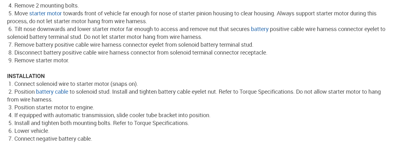

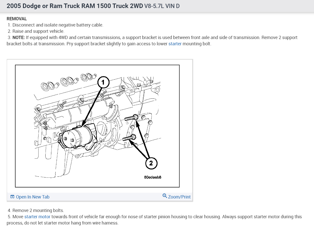

We can only handle one problem per question so this one will be to get the engine started again, please start a new question for the misfire issue. It sounds like the no crank issue is either a weak battery, bad connection or the starter motor has gone bad. here are three guides to go over to found out and fix the problem I have also included how to change the starter motor out in the diagrams below.
and
and
