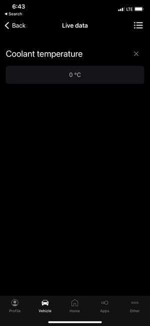

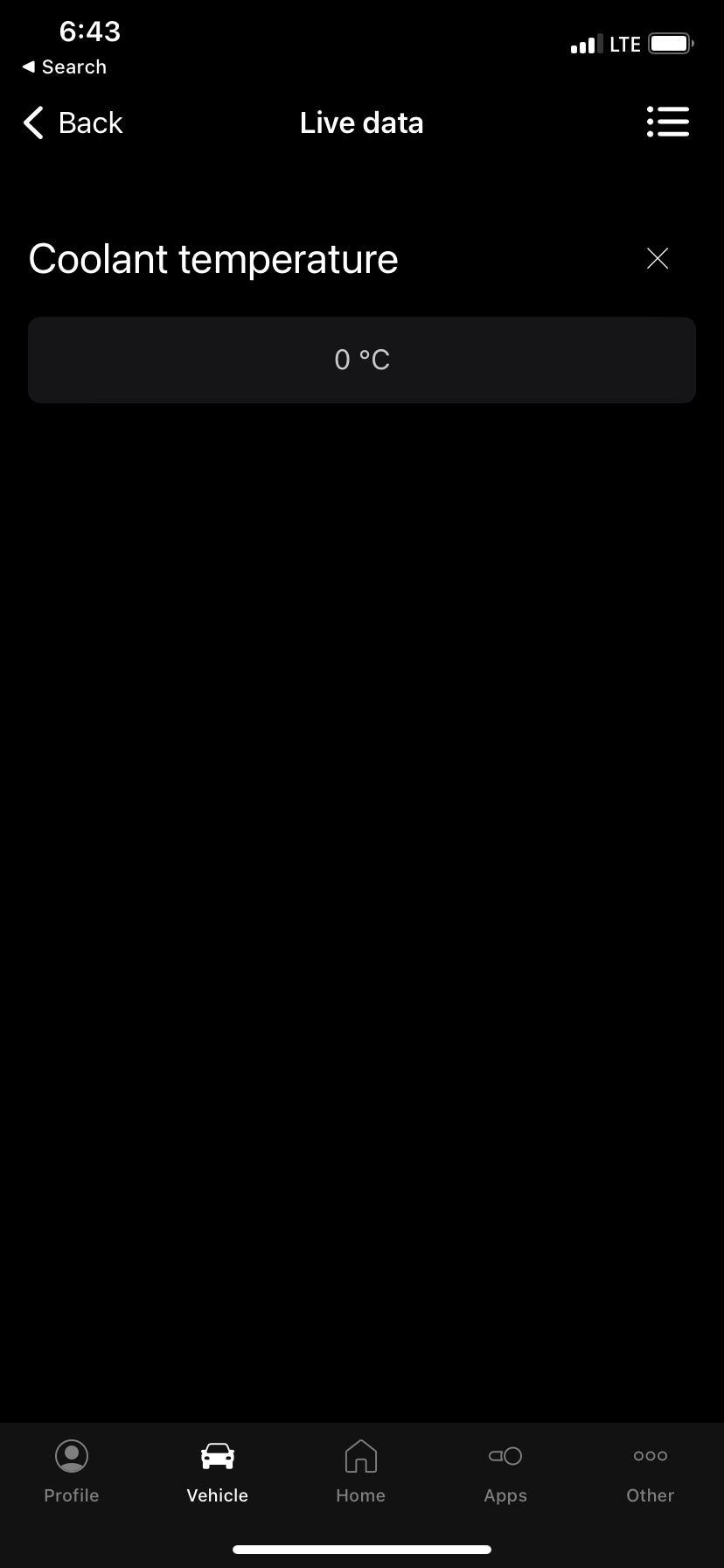

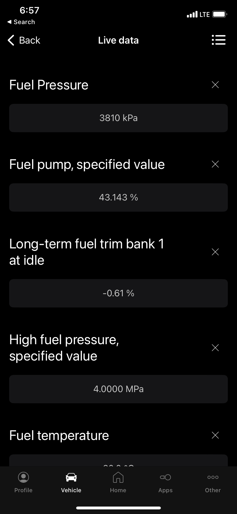

Do me a favor. Since you have a live data scan tool, try this. Before starting the engine cold in the morning, hook up the scan tool and see what the engine coolant temperature is signaling to the PCM. The temperature should be really close to the ambient temperature. If it is off, that can cause an issue like this.
Next, after driving it and the engine reaches operating temperature, check the short-term fuel trims. Let me know what they are. This will tell me if there is too much or too little fuel getting to the engine.

Here is the live data, i threw in some extra things in there that are air/fuel related. For some reason I only had the option for long term fuel trims, not sure why. Hopefully this can give you an idea.

Coolant temperature was kind of close, the temperature outside was around 20F and it read 32F for the coolant temperature.

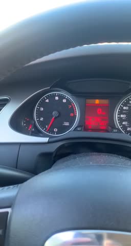

Here’s another video, showing me starting the car for the first time, reversing off of my driveway, idling in reverse on the road and then at the very end I shift to drive. You can see on my boost gauge how it’s fluctuating badly. Seems like I might have a vacuum leak? But I'm not sure what it would be?
Dec 5, 2022 at 3:57 AM
BHUSE
  • 7 POSTS
This is also only when the engine is cold and sitting overnight.
