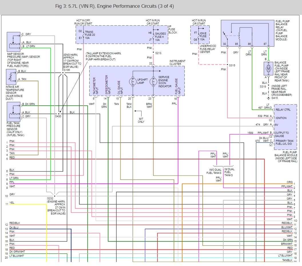

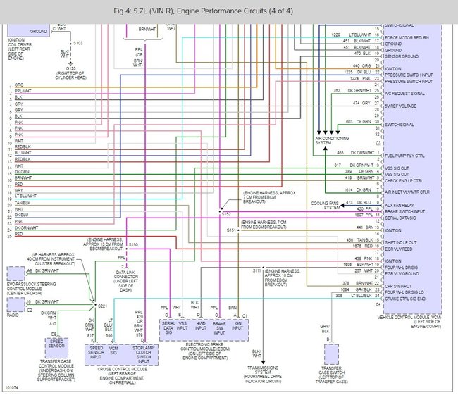

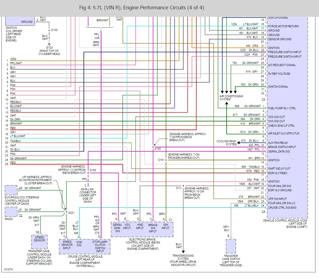

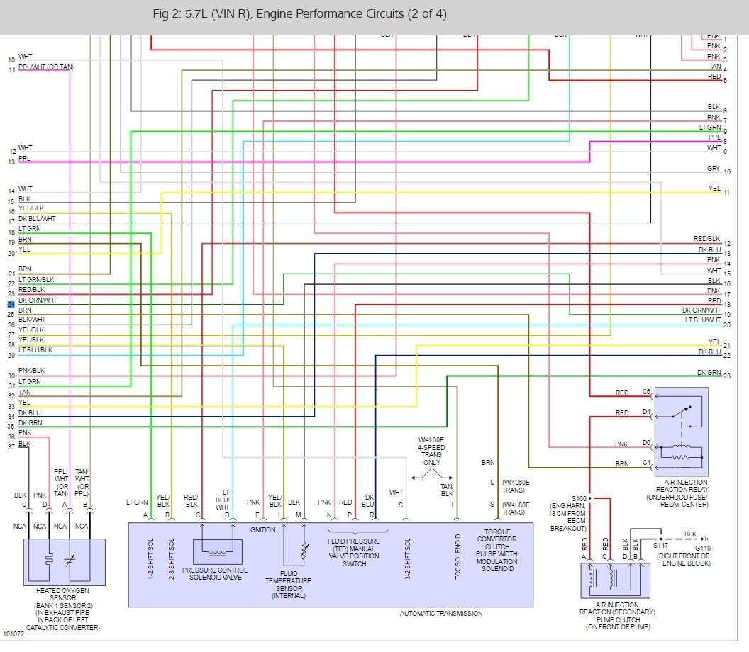

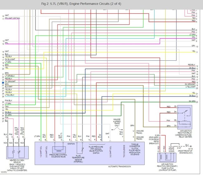

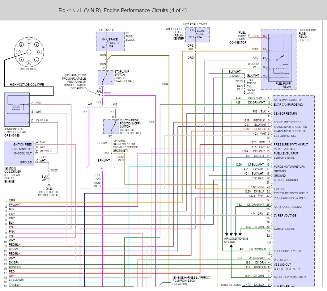

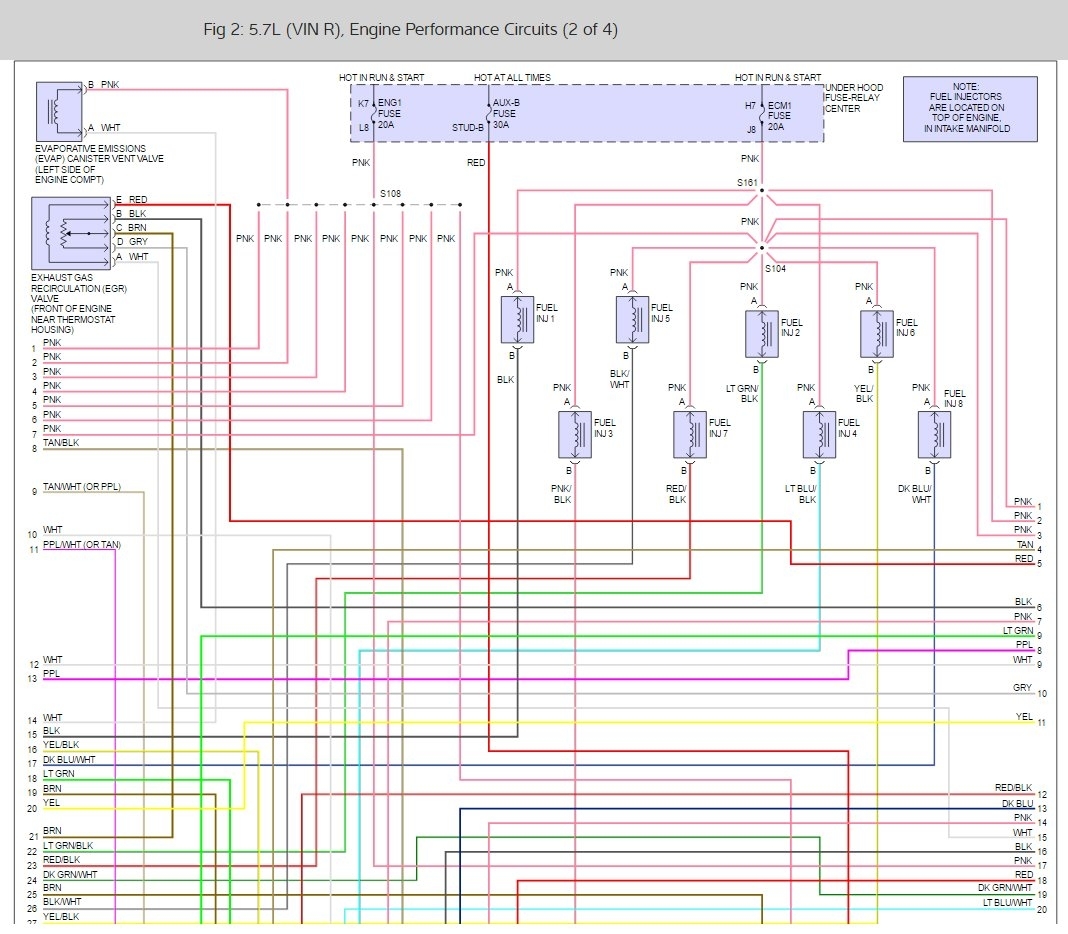

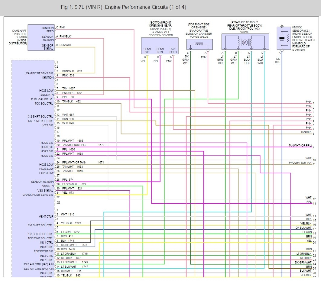

Hey JOHNNY,
If I may put in my 2 cents, it sounds like you have lost connection, power or ground somewhere, here are some wiring diagrams and a guide to help you check this out.
and
Please run some tests and get back to us so we can continue helping you.
Best, Ken
