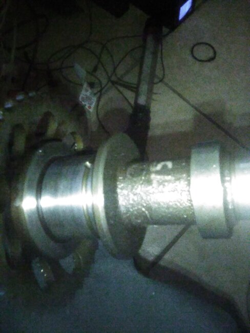

I guess I need to give full details in order for you to give a better diagnosis, this will be long but here I go, Last year my apts had my car towed and tow truck towed it front the back and i had parking brake in and it was in park, which threw off my timing. Which I was unaware of at the time. I kept trying to start it and it wouldn't start every time. So, I started replacing parts and here's the list of parts: fuel pump, injectors, crankshaft sensor, camshaft sensor, VSS sensor, fuel line, timing belt, throttle body, radiator, starter and alternator, battery. After replacing all the above, I was trying to start the vehicle and was still unaware of the timing issue, but I was trying to start and held it a little too long and I believe a valve broke and went into the next shaft. By this time, I was truly upset and frustrated, so I stopped working on the car for a few months, but then I went and bought another engine from the junkyard. So, when I pulled out old engine and transmission, I went ahead and replaced both cv axles, and wiring harness. took apart old engine from transmission and replaced with new(used)one, dropped it back in car and then cv axles.(first time doing either). Once i got it all back together, it finally started right up. I was super stoked until I went to put it in gear and then nothing happened. Oh, almost forgot, when i started it up and tried to get it to go into gear it wouldn't at first and frustration got the better of me to where i yanked on it and forced it to come out of park. Nothing. So afterwards I assumed i snapped the shifter cable and ended up replaced it as well as the shifter. Tried starting it again and went to shift and still nothing. So i replaced the 2 shift solenoids and lock-up solenoid on valve body. tried again after and still nothing. I then replaced valve body, still nothing. So now I'm at a stump as what it could be. I'm not sure if it's something i missed with cv axles, or what. Before it was towed everything worked just great. I have redone everything under the hood minus the actual transmission. Which I am hoping I don't need to. Any advice or help would be truly appreciated. Thanks
Dec 25, 2022 at 5:32 AM
  • 110,251 POSTS
There is a possibility that the CV axles you used aren't fully installed. I have a question. If you place the car in park with the parking brake off, are you able to move the vehicle as if it was in neutral?
Also, when the trans and engine were connected, was the torque converter fully engaged into the transmission's front pump?

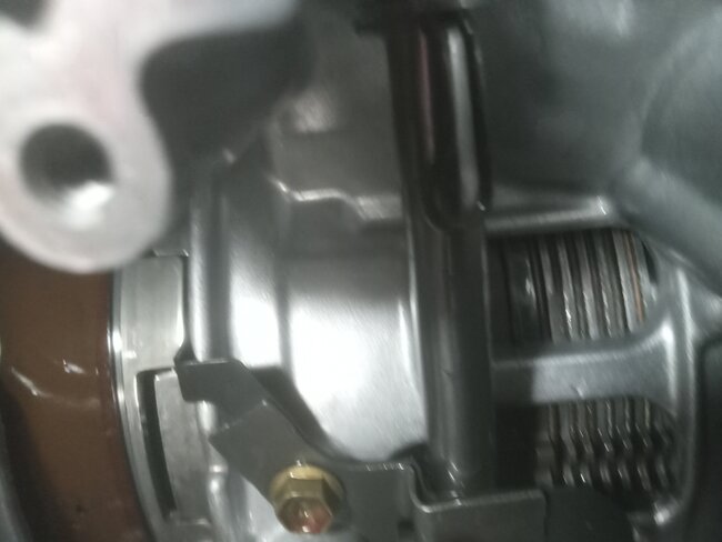

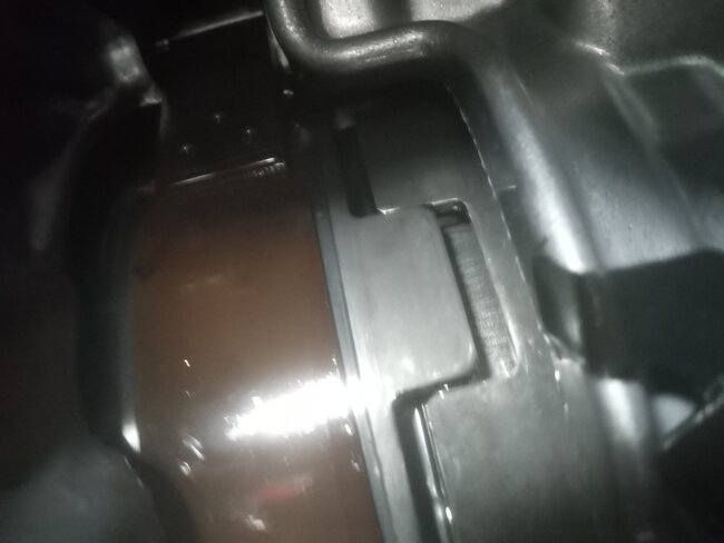

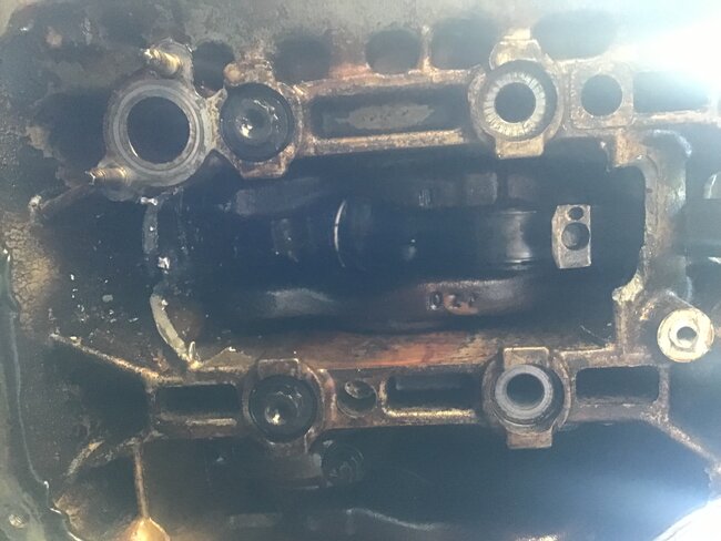

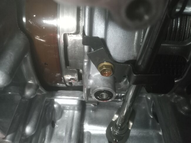

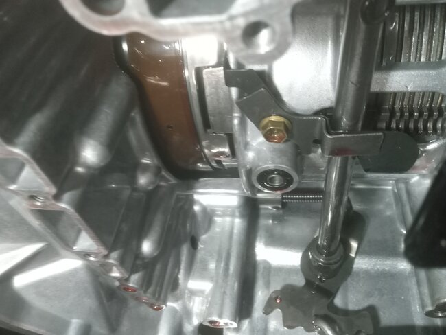

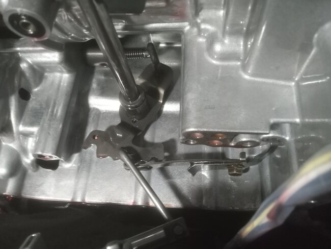

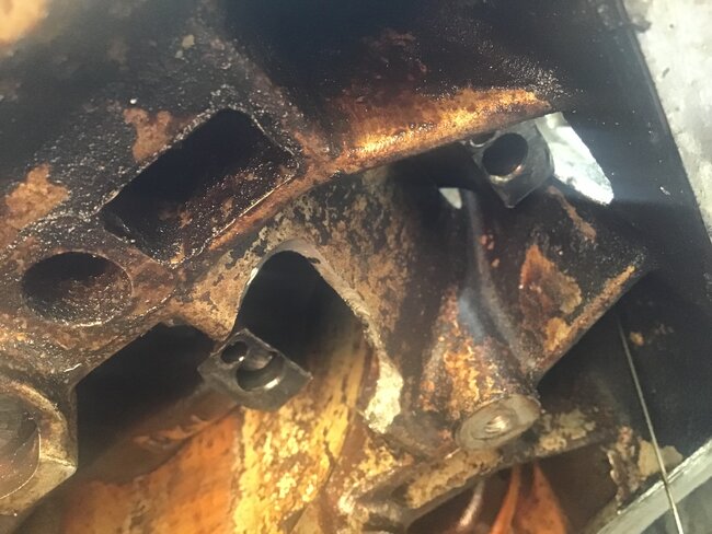

Here are pictures of the bottom of tranny when i removed the valve body, is there supposed to be a gap there? The other night I had rechecked the CV Axles to make sure they were all the way in again, I used a weighted mallet and hit it on the spindled and it didn't seem to move anymore. When I rotated it, it moved on both sides. Yes, the reverse lights come on, as well as the brake lights. It doesn't move in park, but in any other gear i can push it and it moves.
Dec 27, 2022 at 9:19 AM
  • 110,251 POSTS
That gap is normal. When you place it into gear, does anything happen? For example, does the engine speed change? If you lift the front wheels off the ground, start it, and place it in gear, will the wheels move at all?

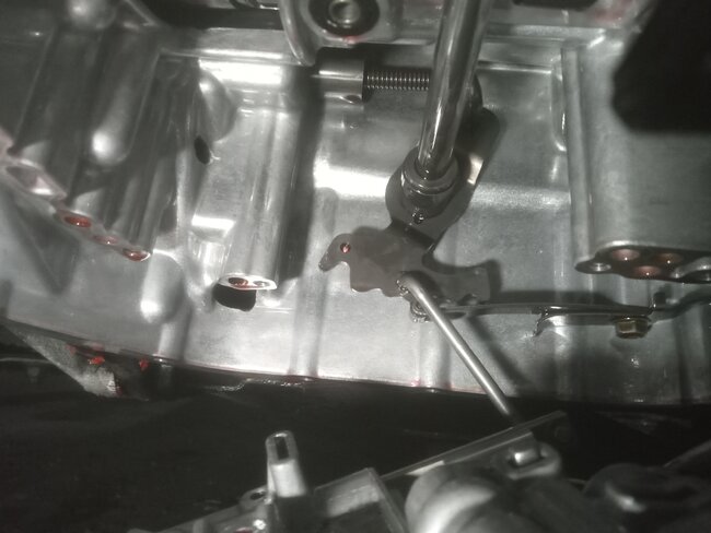

Yes, the gear selector represents the correct gear. When I replaced the shifter cable, I made sure that it was lined up correctly. I'm not entirely sure that the torque converter was fully seated, but I want to say yes. I took the starter off and had to make sure that I had bolted it down to the flywheel and it had the 3 bolts in it. Let me take a look at what you sent. If I/we can't seem to figure it out, within next few days, the junkyard is having a sale to where everything is half off, so I'm thinking of just getting another one. If i do, I was thinking of converting it to a manual. which would mean I would need to grab the engine as well? correct?

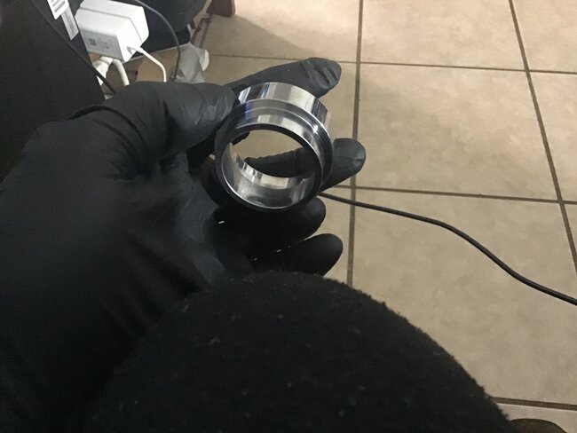

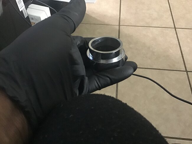

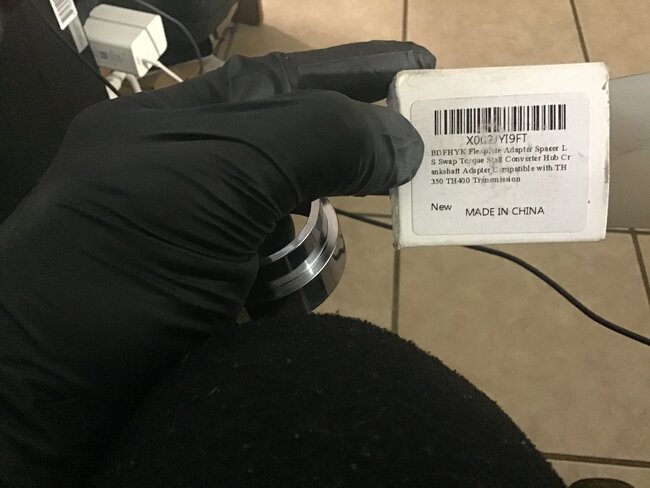

DC CRENSHAW
  • 36 POSTS

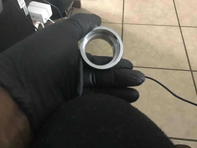

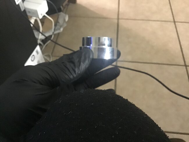

It seems like the tip doesn’t fully fit into the flex plate. But they have adapters/spacers. I bought one but not sure how or where it goes, or if it's the right one.
Feb 3, 2023 at 2:57 AM
  • 110,251 POSTS
Are you sure it is for this issue?
I read the label in pic 1. If that is what I think, it is a component for a GM vehicle transmission (older one) if a different performance flex plate is used. This is required for fitment if you are using a curved flex plate with an LS engine on a TH350, TH400, or Powerglide transmission. It isn't made for a Toyota, and I don't think any were ever made, but I could be wrong.
Who is giving you this information? They are going to drive you crazy.
Feb 3, 2023 at 5:39 AM

Hey Joe,
So, here's an update: 2 transmissions later, smh! The one from the Celica wouldn't fit due to the torque converter being bigger, so swapped it out and got one from a 2006 Corolla. Finally able to drive it again, but still not 100percent. I'm losing power between first and second gears. My neighbor is saying my O2 sensor is bad, and a possible vacuum leak. I'm getting code P1656 as well. What are your thoughts?

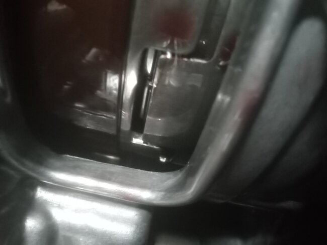

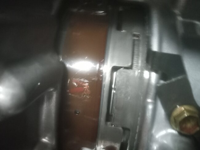

  • 36 POSTS
Joe,

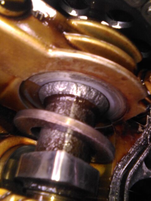

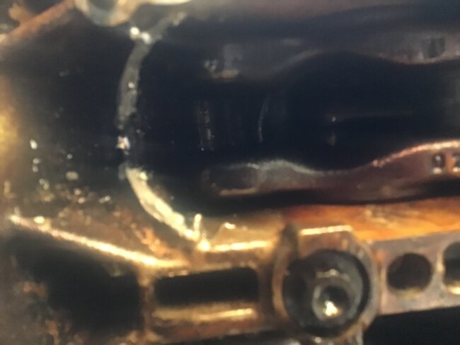

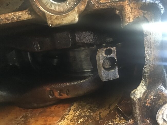

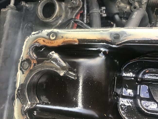

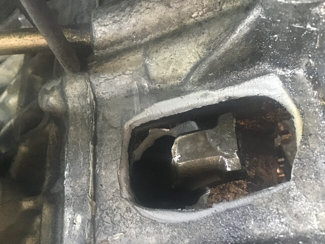

Why is it every time you fix one problem another appears! SMH!! So, my neighbor suggested i remove the valve cover because of a knocking sound that we could hear! So, I set timing just in case, removed valve cover and this is what was seen attached pictures! Now my neighbor says I should just cut it off, and it wouldn't be a big deal. If this is true, I'm okay with cutting off, but i want to know will it be a big deal down the road or would it be fine to cut off and not worry about it! But that is the piece that was causing a lot of noise!
Mar 14, 2023 at 6:10 AM
  • 110,251 POSTS
I've never seen one of those come loose. They are pressed in. Also, I don't think you would be able to cut it and I question if that would be a good idea.
Is that the only thing you found? I suspect that helps hold the bearing in place.

DC CRENSHAW
  • 36 POSTS

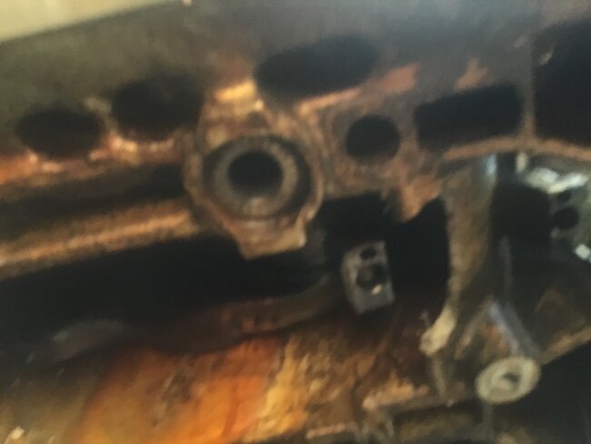

Not even with my Dremel? I think it is the end result from my a/c compressor not being fully tightened and I had the belt pop off as well as power steering pulley wheel fly off. So would you suggest replacing it, if I have a spare one.
Mar 14, 2023 at 9:17 AM

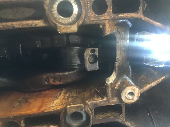

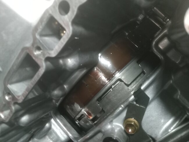

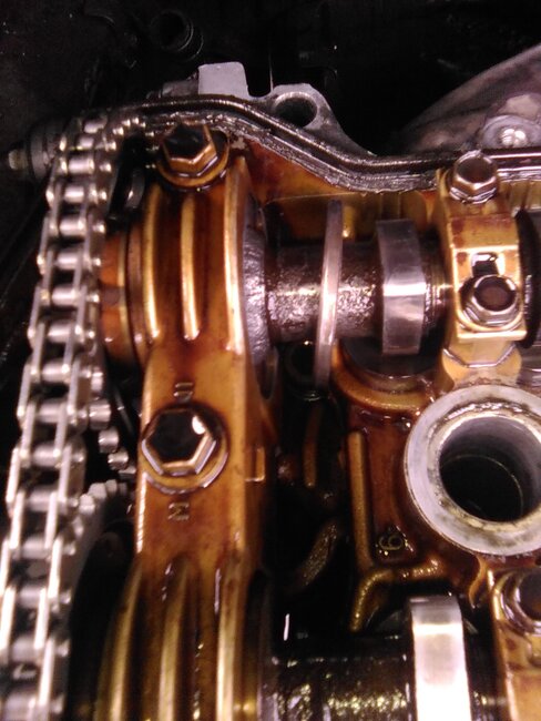

DC CRENSHAW
  • 36 POSTS
Joe,

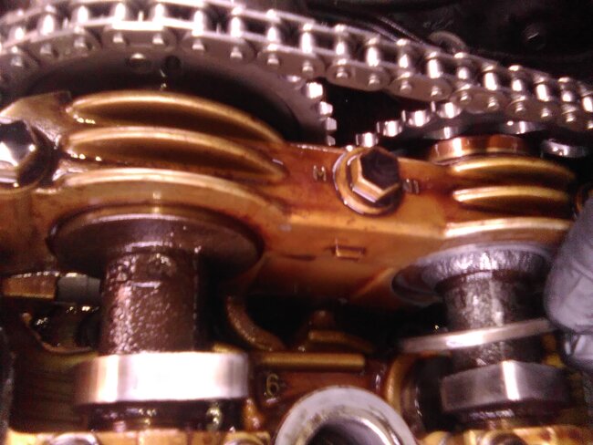

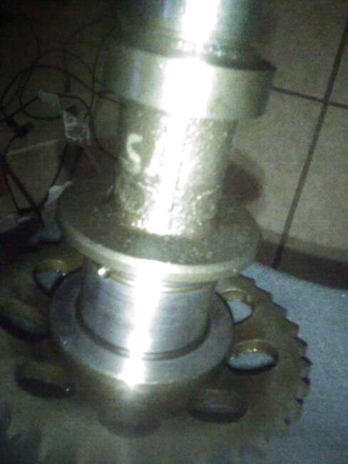

Here is what it looks like originally, pulled it off my old engine to see exactly where it came from. Question, if i remove nut, then doesn't the sprocket come off and then other pieces follow?
Mar 14, 2023 at 10:42 AM
  • 110,251 POSTS
Yes, if you remove the cam pulley bolt, the pulley will then be removable. I looked at the pics you attached. It appears that it was welded to the camshaft originally. That would be used to prevent the camshaft from traveling forward and back. It needs to be there.
Is the cam you have in the last pic (old engine) the same part? If it is and it's in good condition, I would use it.

DC CRENSHAW
  • 36 POSTS
I wish i had seen your response Joe, lol it would have saved me of having to take everything back apart. should i go ahead and replace both, since I'm already replacing one of them?
Mar 14, 2023 at 5:53 PM
DC CRENSHAW
  • 36 POSTS
yes, the part is from old engine, they both look better than what is in the new engine.
Mar 14, 2023 at 5:57 PM
  • 110,251 POSTS
Replacing both is a good idea since one has failed. Just make sure they are the same parts.

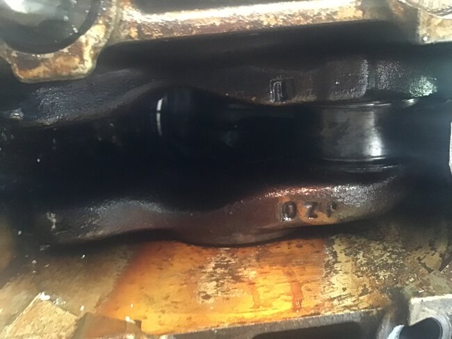

Need help! If it’s not one thing it’s another. So, I replaced them and fired it up and started up just fine but then I started hearing a noise, so I shut it off, and checked the pulleys and power steering pump to see if they were the cause of noise. As far as I could tell they weren’t. So, I fire it back up and put it in reverse and give it gas next thing I know it shuts off. I’m like great! I tried to start it, but it wouldn’t start. So, I tried to turn the crankshaft by hand, and it wouldn’t turn. I’m like great engine locked up on me. What are the causes for the engine to lock up? The sound resembled to dryer with a piece of metal in it and it bounces around with every turn. Before I replaced the camshaft, I removed the injector from 2 cylinders and spark plugs, the bolt that holds injector to head had fallen out and I assumed it fell off behind engine. Especially since I was able to put spark plugs back and everything went back together with no problems. So, I’m really unsure of what can cause the engine to lock up, can you point me in a direction of what to look for and if you have the right process for fixing the issue. I figured I have the old engine and I could take apart the engine in car and replace it with parts from old engine. The worst case is going to junkyard and getting another engine. Your help is greatly appreciated.
Mar 22, 2023 at 6:24 AM

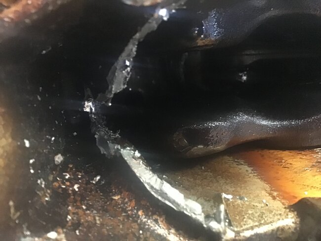

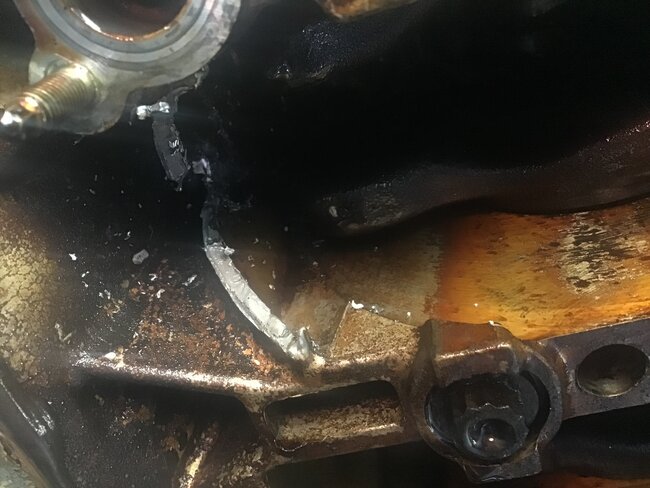

DC CRENSHAW
  • 36 POSTS

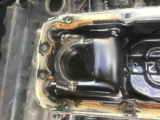

And how can I set the timing now when I can’t even get it to rotate? I’m sure the markings on my timing chain should still be there but how can I get cylinder one to the right position?
Mar 22, 2023 at 6:26 AM
  • 110,251 POSTS
Can you turn the engine in either direction? The 1.8L is an interference engine. If the timing jumped, the noise you were hearing was a valve or valves hitting the tops of the pistons.
Let me know. Also, please confirm something for me. The only engine offered in the vehicle is a 1.8L and your original heading indicates a 2.3L.
Hang in there. If this happens and you have a different cylinder head that is good, we should be able to fix it.
Mar 22, 2023 at 11:12 AM
DC CRENSHAW
  • 36 POSTS
Joe,
So, I figured out what the noise was. So, when I first started hearing the noise, I assumed pulley or cam which is why I checked the top side, when whole time it was the bottom side, I should have been worried about. This is the sight I saw as soon as I dropped the oil pan. Truly not a happy camper. Let me go and answer your questions, when I tried to crank by hand it would barely move either way and I see why. This would explain why I was having power issues. Yes, my car is 1.8l not sure why it says 2.4l. I wish it was thou! By the end of it all, plan on making it faster by adding a turbocharger kit to it. After I can get it running and not a short-term run. So, this part of the engine is truly foreign territory for me. Once I seen the crack, I’m like great now I definitely need a new one but then I realized that crack is below line I seen. Or is the line just a crack and I need a different engine. Tell me that it’s possible to piece together the engine from the two I have! I'm not sure exactly the issue with the old engine but I think it did the same as this but not as bad, because when it happened, I was frustrated and just yanked it out and put this one in. Really frustrating because before all these issues car ran like a champ until it got towed wrong way and I was unaware at the time that it would throw my whole timing off from it. Getting ready to remove oil pan from old engine to see how bad it is. My concern is pertaining to the timing, because I wasn’t able to set it prior to removing oil pan with it being jammed. But haven’t messed with timing chain except for pulling out the plugger on backside by power steering pump.
