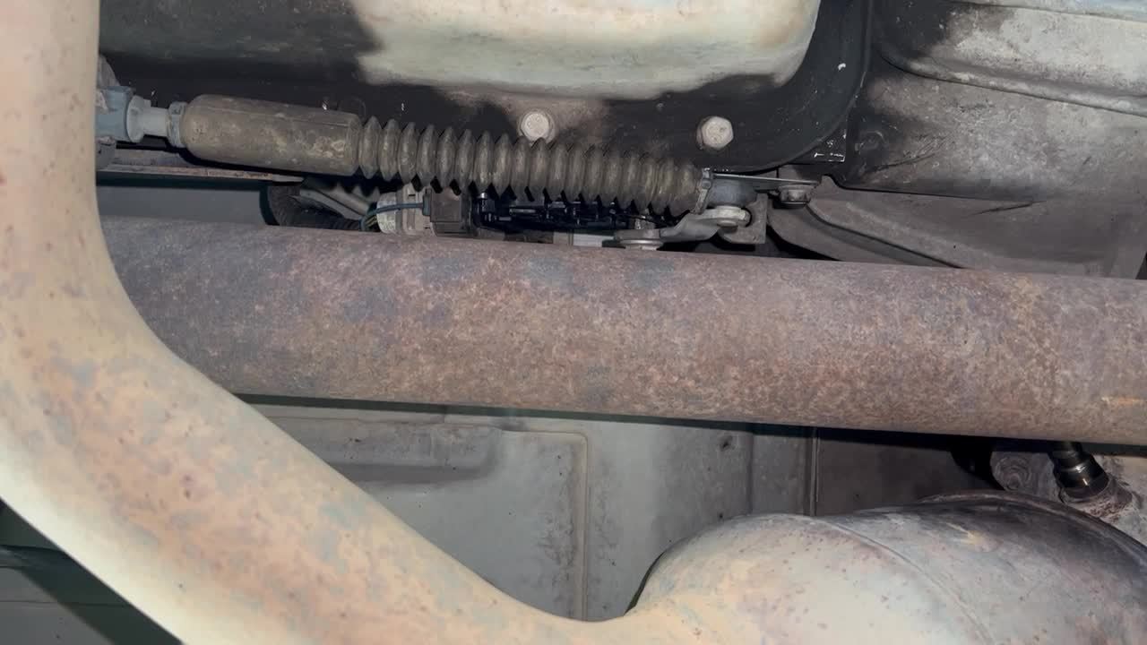

The shifter works like normal, but my transmission will not go into gear and move
2008 GMC SIERRA
267,156 MILES • 6.0L • V8 • 4WD • AUTOMATIC
BRYAN WHITE
After moving the shifter up and down a few times my truck will go into gear. I replaced the neutral safety switch but that’s not the problem.

Have you checked the linkage at the transmission to see if it is properly attached?

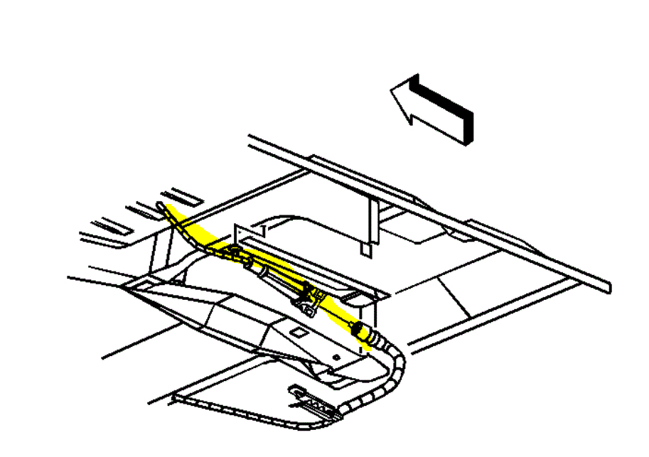

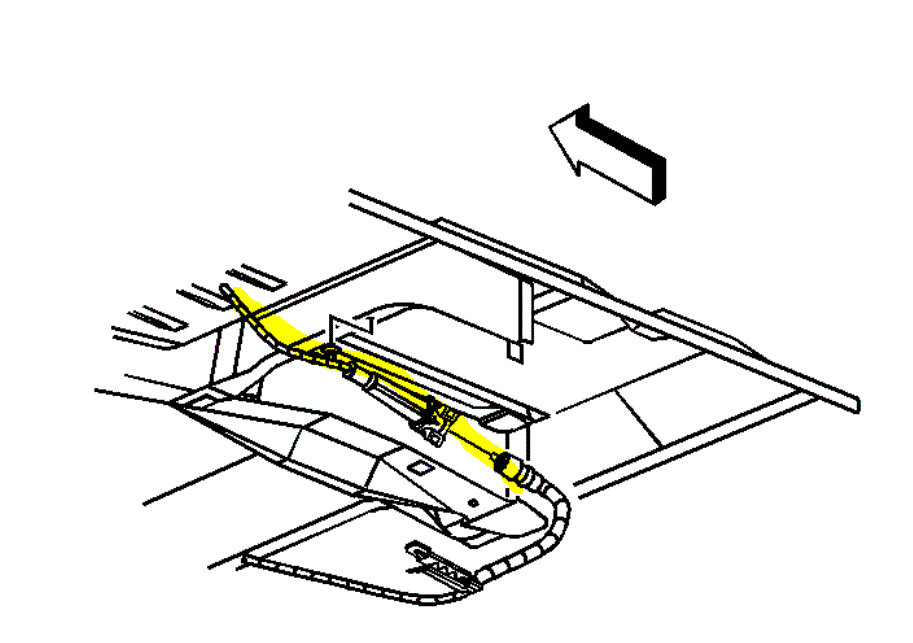

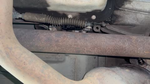

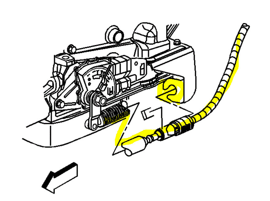

I attached a few pics below. The first shows the cable and its mount. Make sure that it is secure. Pic 2 shows how the cable comes through the floor panel. It is clipped in place. Confirm that it is tight.
Also, with the parking brake engaged and the wheels blocked, have a helper shift through the gears to confirm the manual shift lever (what the cable attaches to on the transmission) is fully moving through the gears.
Try this and let me know what you find.

Linkage works properly. Still will not go into any other gear.
Jul 3, 2022 at 5:52 PM
  • 110,194 POSTS
Yes, it does appear to be moving normally. I did notice what appears to be a loose retainer where it connects to the range sensor shaft. Did you notice it?

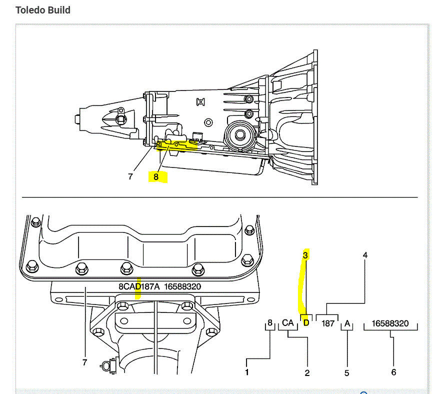

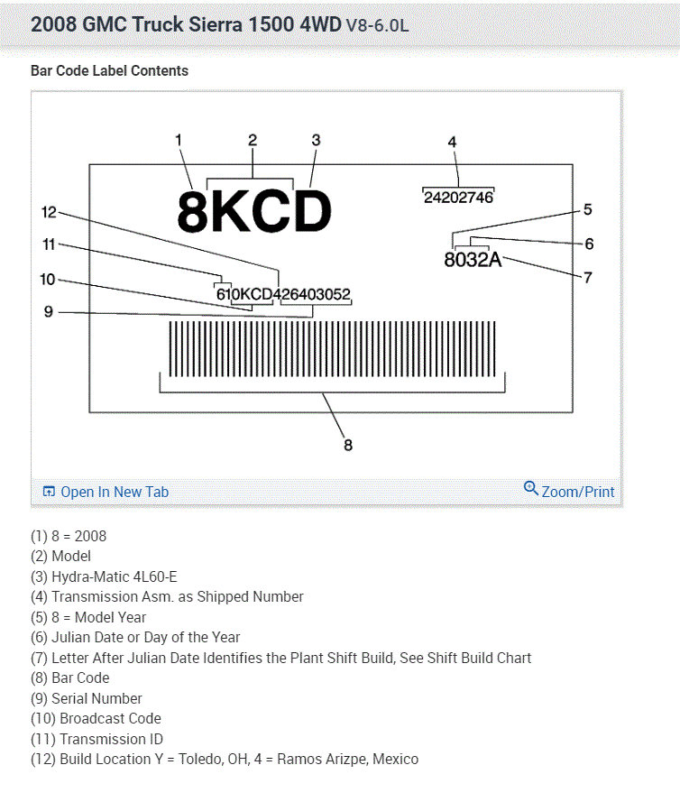

I need you to check something. I need to know which model transmission you have. There are three optional automatics used on this vehicle, a 4L60E, 6L50, or an Allison transmission. I attached a couple of pics below to help you locate the info I need.
Let me know what you find.
