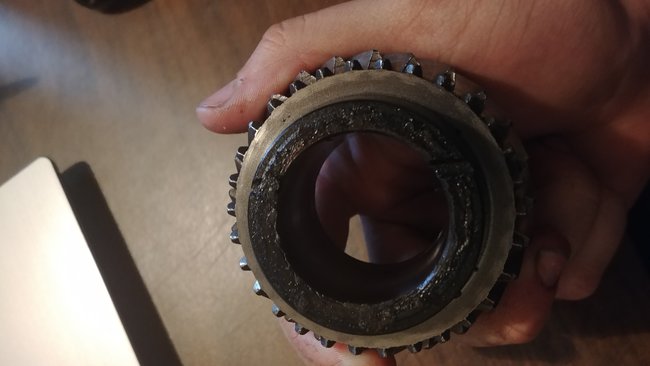

That is one worn transmission. It looks like you are also missing bearings. With some of the pictures you have put up you might just want to find a replacement transmission. It might be cheaper than buying all the pieces to rebuild this one. It looks like that unit had water get in it and was not serviced at all.
I would start pricing all the damaged and worn parts and see which would be the better option.

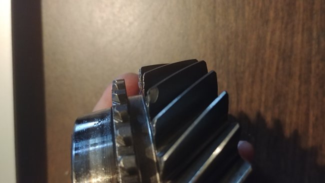

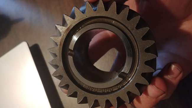

So far the money spent is not as much as a replacement transmission from the junkyard. I just received a kit with new synchros. Attached are more pictures of the third gear (I think it is third). I found a chip in it, should I buy a new one?
The rest of the shaft is taken apart, I am ready to rebuild this thing with new bearings, synchros, spacers, clips, gaskets, etc.

Chips are not a good thing on a gear like that. They will chew up the gear they mesh with over time. I would replace it.

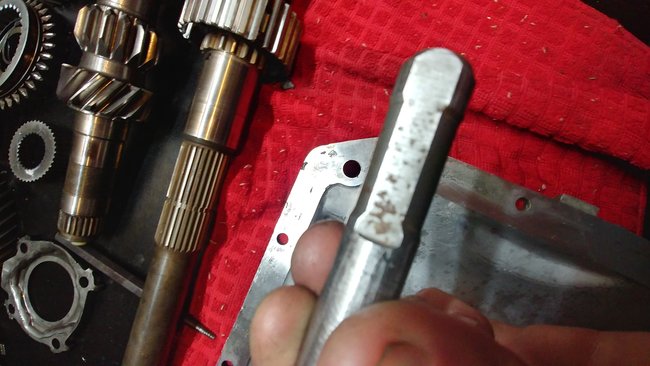

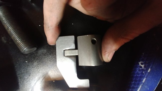

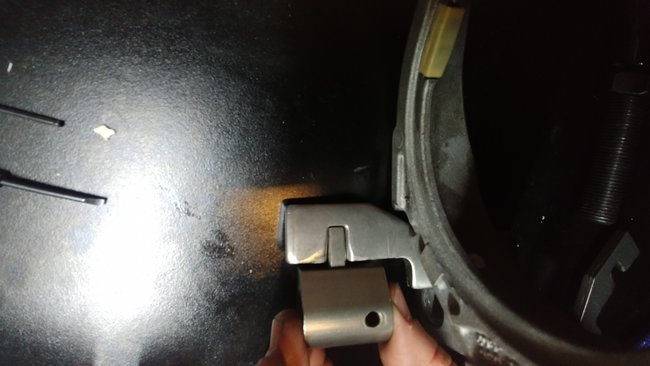

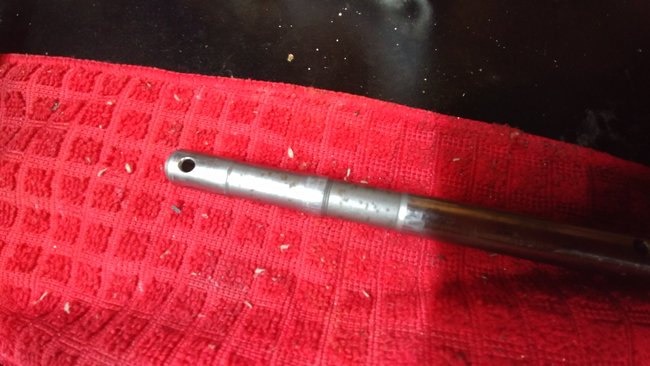

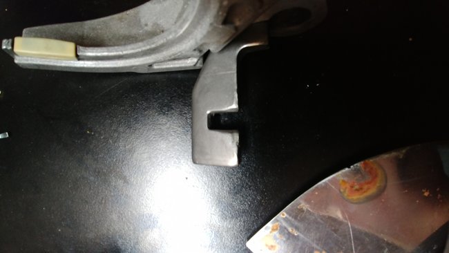

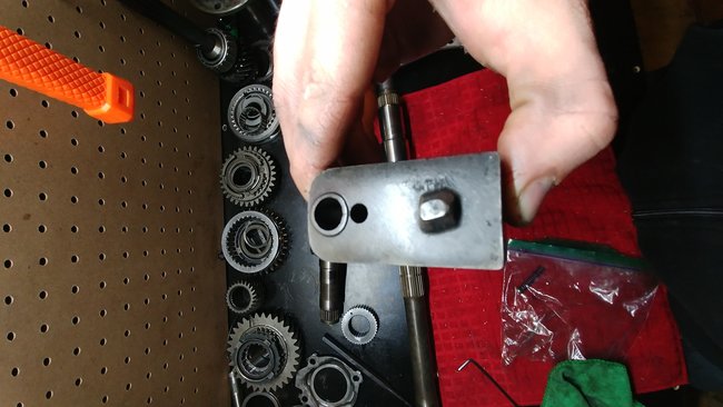

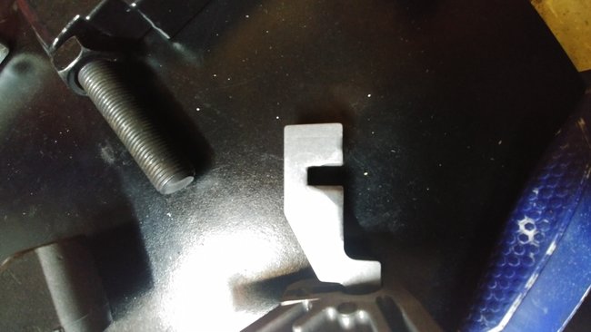

Attached are some more pictures. While I wait for some things to arrive in the mail, I took apart the shifting rail to clean. The shift finger was a little stubborn to shift because of 1) rust spots on the rail (pictures) or 2) the lugs are stretched, or both. Judging by the pictures of the lugs and shifting finger, what do you think?

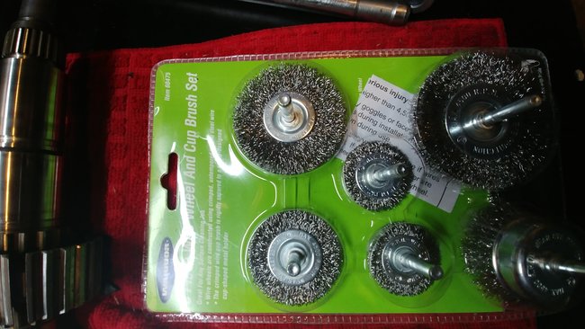

Also, pictures is a set of wire-brush wheels for a drill I got for free from Harbor Freight. It says good for "any" surface cleaning job, but would it be ideal for cleaning the rails and/or the mating surfaces on this transmission?

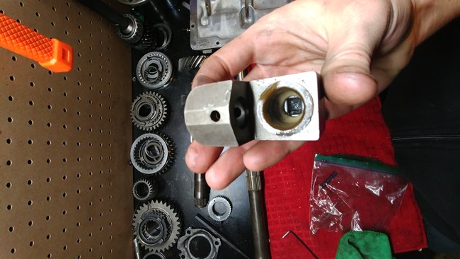

Lastly, I have also pictures the offset shift lever. Some people say that the points wear. I do not think this one is bad but it would not be a surprise if it happened to be.

Those are simple steel brushes but soft they do not remove rust so much as burnish it pretty. For the mating surfaces use a scraper to just get the old sealant/gasket off. Wire brushes will work but it is easy to gouge the aluminum. Harbor Freight also sells evaporust and fine wet or dry paper. Get some of the 500 and 1000 grit, soak it in water and use that to just polish the surface, you do not want to keep going until the pitting is gone but you want to remove the sharp edges of the pits.
