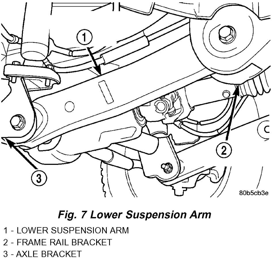

I notice that the lower control arm boot is torn on one side. Could that be it? also maybe I need to have it aligned after replacing bearing?

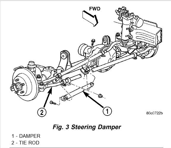

A common cause for the death wobble they develop is a bad steering stabilizer. The next is worn control arm bushings that allow the steering to shift around loosely. Where is the shaking felt the most? Steering wheel or in the seat? Normally steering wheel is front end and seat is rear tires or driveline.

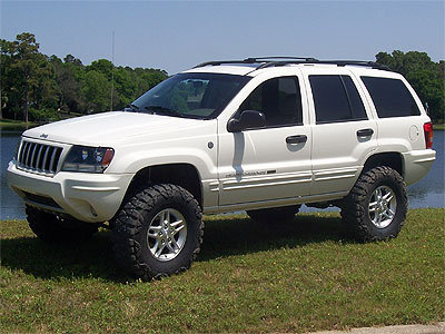

Sounds like the typical issue with 4WD, they don't get used regularly so the transfer case parts are still tight and bind up when used. To check the front shaft isn't hard, get the front of the Jeep on ramps or block it up so you can slide under it. Then just grab the shaft and see if it moves in any direction. Does your Jeep look like the one in the first picture? I forget that the Liberty in the US was called the Cherokee everywhere else. I ask because you show a 3.7 which was used in the smaller Jeep but the 4.7 was the common engine for the larger Grand Cherokee. Just want to be sure of the vehicle.

It's the 4.0 - 6 Cylinder.
Picture enclosed is what it looked like in it's better days. I plan on getting the vehicle in the garage today after work and will switch out the tires and check on those things you touched on.

Nice looking ride.

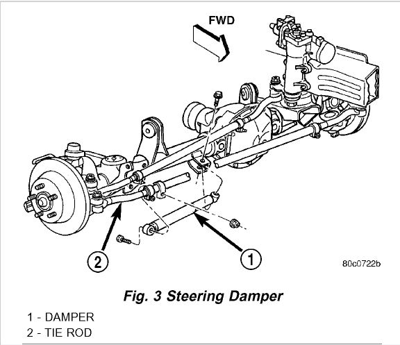

It could be an out of round tire, or one that has something in it but that should have changed with the rotation. You mentioned a LCA boot? Did you mean the bushing itself is damaged, Is it the front one or the one at the body? What shape is the steering dampener in? To test it you can unbolt the shaft end, then try stretching it and pushing it together. It should be stiff in both directions and have no play between directions, even as little as 1/4 inch can cause unwanted problems. I've seen those fail in a month if the roads are real rough. I normally upgrade them if there is even a doubt, the MOOG SSD107 is a larger unit than stock and seems to last a bit longer if you'rs fails testing.

If it's a lot less in 4WD then it is likely a bad front drive shaft or a bad steering damper. The front tires under load can act like a buffer in the front end as they are linked together. It can hide things like worn parts because now they cannot flex or move easily.
