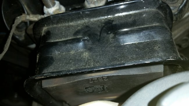

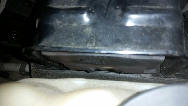

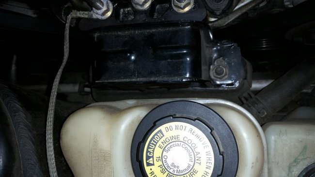

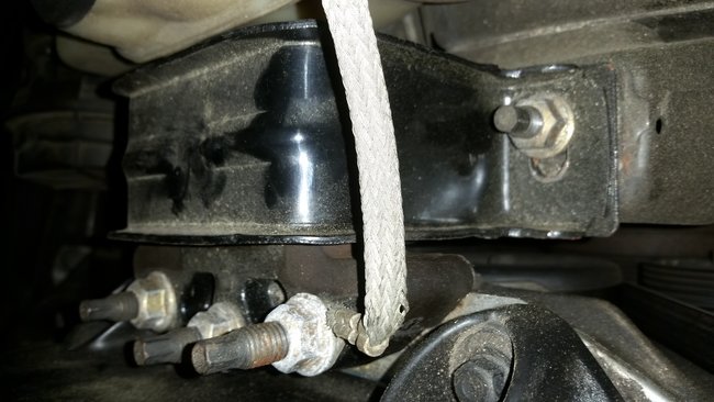

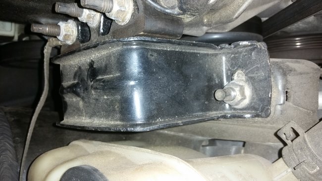

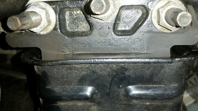

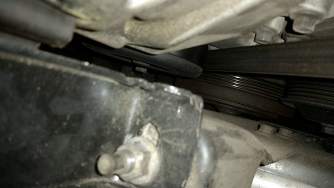

Then usually the lower transmission mount under the transmission colaspes or tears loose.Also the upper engine mount by the coolant bottle colaspes and tears.Takes some pictures of the upper mount from all different angles and post them for me to see.
May 23, 2016 at 12:03 PM
BLUEISMYCOLOR
  • 54 POSTS
Ok. I did the best I could with the pictures. Also I uploaded these videos .the first one is of the high idle and you can also hear the whine I have been trying to explain. The second one is a closer up of the whine.

I need to see the part of the mount between the coolant bottle and the mount.
May 23, 2016 at 12:28 PM
BLUEISMYCOLOR
  • 54 POSTS
I couldn't get between there. My phone would fit there isn't enough room. :(
May 23, 2016 at 12:34 PM
SATURNTECH9
  • 30,869 POSTS
Take a picture of it you can see it with your eyes so you can take a picture of it.
May 23, 2016 at 12:56 PM
BLUEISMYCOLOR
  • 54 POSTS
I tried every way I could. I can not get between there to get a picture.
May 23, 2016 at 1:18 PM
SATURNTECH9
  • 30,869 POSTS
I just tried to take a picture of the mount from that angle on my Saturn.I can't do it ether.Do you have a 5mm Allen L shaped wrench?
