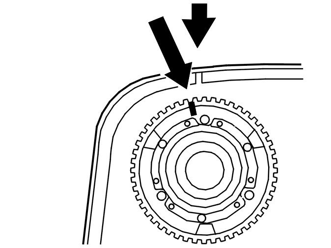

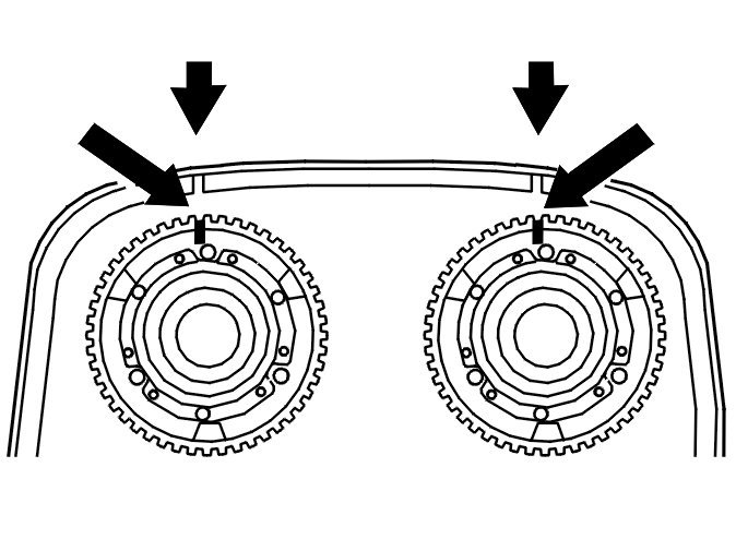

I'm pretty new to Volvo... worked on many others. Overhauling my first top-end on a the car listed above from head gasket and PCV/oil pan detox, timing belt and everything in-between.
I can't find any details as to where the cams should be positioned in the variable timing spectrum.
It makes sense to turn them clockwise and stop the cam mark with out passing the cam cover mark- thus having the variable play move towards 11:00.
But it also makes sense to move past the cover mark until the play stops at the cam mark- putting the play at the 1:00 side... on the advance side of the stroke.
I wonder why all the info I found doesn't cover this... it seems like a big deal since the lobes move a good 10 degrees with the play set from one position to the next.
Either way, in my experience; what may seem to makes sense probably hasn't been looked into enough..
Anyone have any input on this?
PS. both my cams have variable hubs.
Thanks!

Installing the timing gear pulley for the camshafts
Note! The purpose of the "Installing the timing gear pulley" section described here is to ensure that the VVT unit is correctly positioned and to reset the camshaft timing gear pulley to the correct position using the markings made at the factory. This is to ensure that the conditions are correct for any later fault-tracing.
pic 1
Note! Do not turn counter clockwise during this procedure.
Slacken off, but do not remove, the screws which secure the timing gear pulley to the variable valve timing unit.
Press the variable valve timing unit and timing gear pulley onto the camshaft.
Install the center screw which secures the variable valve timing unit to the camshaft. Tighten slightly. Turn the variable valve timing unit counter-clockwise as far as it will go. Remove the center screw.
Position the upper timing cover.
Turn the timing gear pulley clockwiseuntil the screws at the oval holes are in the limit position. Continue turning clockwise until the timing gear pulley marking is 1 cogs before the marking on the upper timing cover.
Check that the timing gear pulley is still in the limit position in the oval holes. Tighten the center screw in the variable valve timing unit. Tighten. See Tightening torque See: Engine > Mechanical > Tightening Torque.
Check that the variable valve timing unit does not rotate when tightening. Install and tighten the center plug. See Tightening torque See: Engine > Mechanical > Tightening Torque.
Turn the variable valve timing unit clockwise to the limit position.
Turn the timing gear pulley so that the markings correspond.

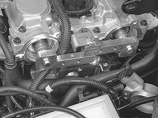

Installing the variable valve timing (VVT) unit on the intake camshaft
pic 2
Slacken off, but do not remove, the screws which secure the timing gear pulley to the variable valve timing unit. Press the variable valve timing unit and timing gear pulley onto the camshaft.
Turn the variable valve timing unit counter-clockwise as far as it will go. Remove the center screw. Position the upper timing cover.
Turn the timing gear pulley clockwise until the screws at the oval holes are in the limit position. Continue turning clockwise until the timing gear pulley marking is 1-1/2 cogs before the marking on the upper timing cover.
pic 3
Tighten the center screw in the VVT unit. See Tightening torque See: Engine > Mechanical > Tightening Torque.
Check that the variable valve timing unit does not rotate when tightening. Install the center plug. Tighten. See Tightening torque See: Engine > Mechanical > Tightening Torque.
Turn the variable valve timing unit clockwise to the limit position. Turn the timing gear pulley so that the markings correspond.

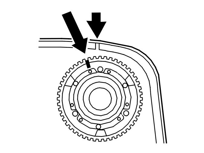

Installing the timing belt
pic 4
Install the belt in the following order:
- crankshaft
- the idler pulley
- intake camshaft
- exhaust camshaft
- coolant pump
- belt tensioner.
Note! The variable valve timing units do not have a return spring and are easily dislodged when reinstalling the timing belt. Check that the markings are correct.

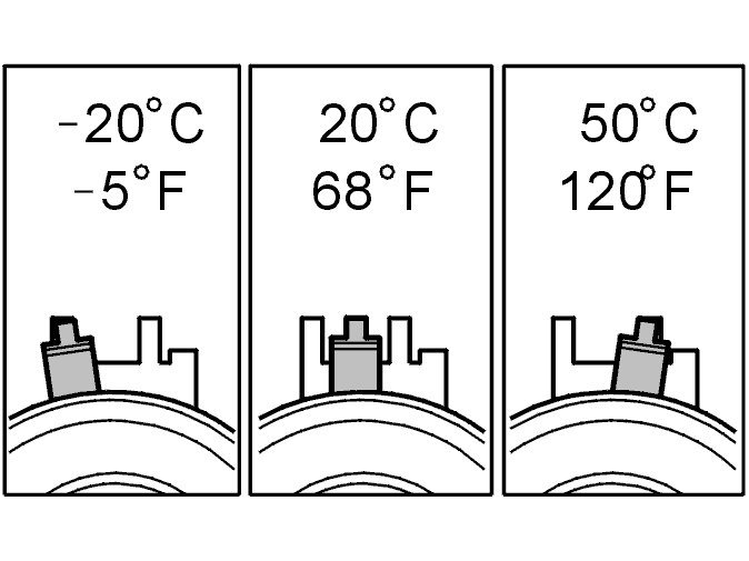

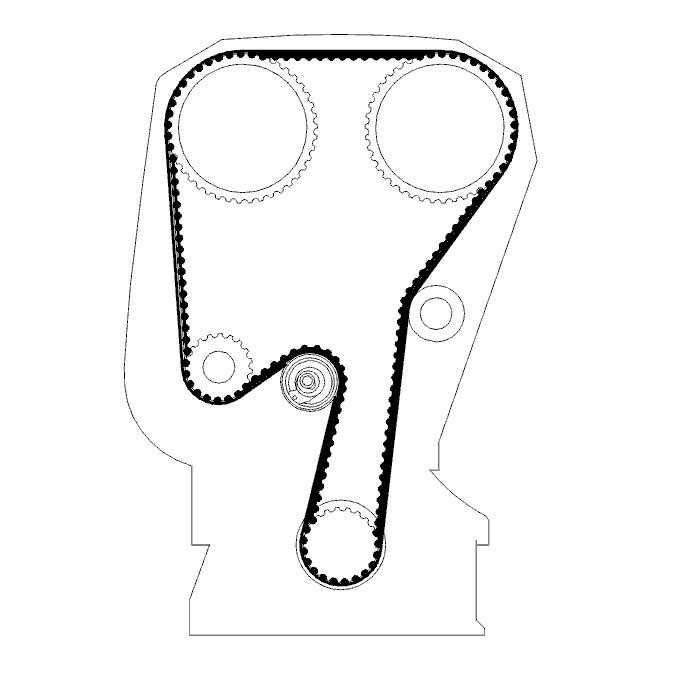

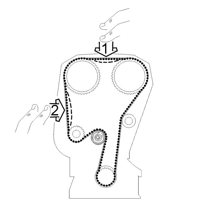

Adjusting the timing belt
pic 5
This adjustment is to be made with a cold engine. A suitable temperature is approximately 20°C/68°F.
At higher temperatures (with the engine at operating temperature or a high outside temperature for example) the indicator is further to the right.
The illustration shows the position of the indicator when aligning the timing belt tensioner at different temperatures.
Hold the center screw secure and turn the belt tensioner eccentric clockwise until the tensioner indicator passes the marked position and reaches the limit position.
Tighten the 3 screws on the exhaust camshaft timing gear pulley. Tighten. See Tightening torque See: Engine > Mechanical > Tightening Torque.
Tighten the 3 screws on the intake camshaft timing gear pulley. Tighten. See Tightening torque See: Engine > Mechanical > Tightening Torque.

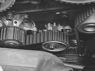

pic 6
Note! Check that the variable valve timing units are in the limit position.
Turn the eccentric back so that the indicator reaches the marked position in the center of the window.
Remember to hold the center screw secure at the same time.
Hold the eccentric secure. Tighten the center screw. Tighten. See Tightening torque See: Engine > Mechanical > Tightening Torque.
Check that the indicator is in the correct position.

- camshaft adjustment tools 999 5452 CAMSHAFT ADJUSTMENT TOOL See: Vehicle > Electrical / Mechanical Repair > 999 5452 Camshaft Adjustment Tool from the rear edge of the camshafts
- crankshaft stop 999 5451 ADJUSTMENT TOOL See: Vehicle > Electrical / Mechanical Repair > 999 5451 Adjustment Tool

Checking the markings and belt tension
pic 8
Press the timing belt to check that the indicator on the belt tensioner moves easily.
Turn the crankshaft 2 rotations and check that the markings on the crankshaft and camshaft pulleys correspond.
Check that the indicator on the belt tensioner is within the marked area.

I just wanted to jump in here really quick. Did you remove the hubs off the cams? If you did then you need a special tool to align the cams up. If it is not aligned then you will bend the valves. The VVT hub has no guide pin so cam and crank alignment is critical here.
