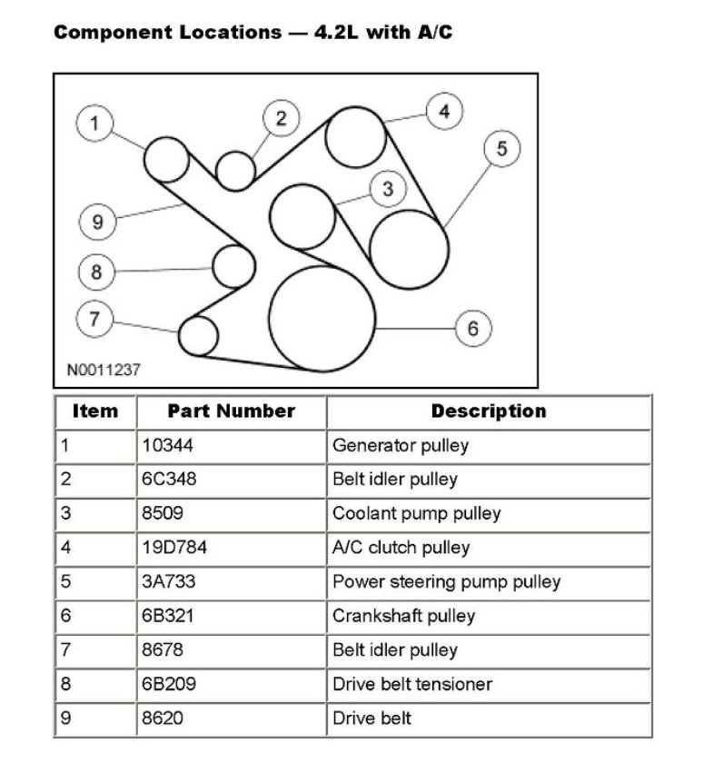

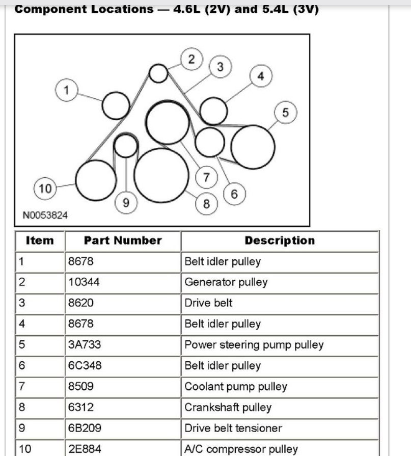

What size belt do I get if I bypass my A/C my truck?
Dec 22, 2018 at 11:20 AM
  • 110,241 POSTS
Because of the routing required, it isn't a good idea to bypass the compressor. Instead, I suggest getting an AC bypass pulley which is about the same price as a belt. Many companies make them. That way you can use the old belt and keep the same routing.
If you look up Dorman part number 34187, you will see a picture of one. I believe that is the one you need, but confirm engine size for your vehicle. Most any parts store can get these. All you do is remove the compressor and bolt on the bypass pulley assembly.
Here is a guide to help change the belt out with the serpentine belt routing diagrams below.

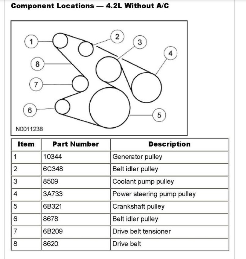

There is an automatic belt tensionier that rides on a shaft. Basically, you turn the tensionier away from the belt to loosten it. When you replace it, reroute the belt and then turn the tensionier to you can slip the belt onto the final pulley. If you need a routing diagram, got to the belt routing diagrams link on this page.

A 5.4 should be a relatively easy job. Toward the left side of the engine is your tensioner. There should be a cover over it. Remove the cover and turn the bolt so that it releases the tension on the belt. After that, pull the belt off and replace with the new one. Make a diagram of the belt's route if you can't remember it.

The tensioner is on the left of the motor about midway down, there is no cover on it though. The end of the tensioner where the pulley is will have a square female drive in it for a ratchet. Getting your hand between the shroud and the fan and working the ratchet into the drive is a little tricky though. When you get the retchet in push down to releive tension and remove the belt from any pulley SLOWLY let the tensioner come back up. There should be a belt routing diagram under the hood. Good luck.

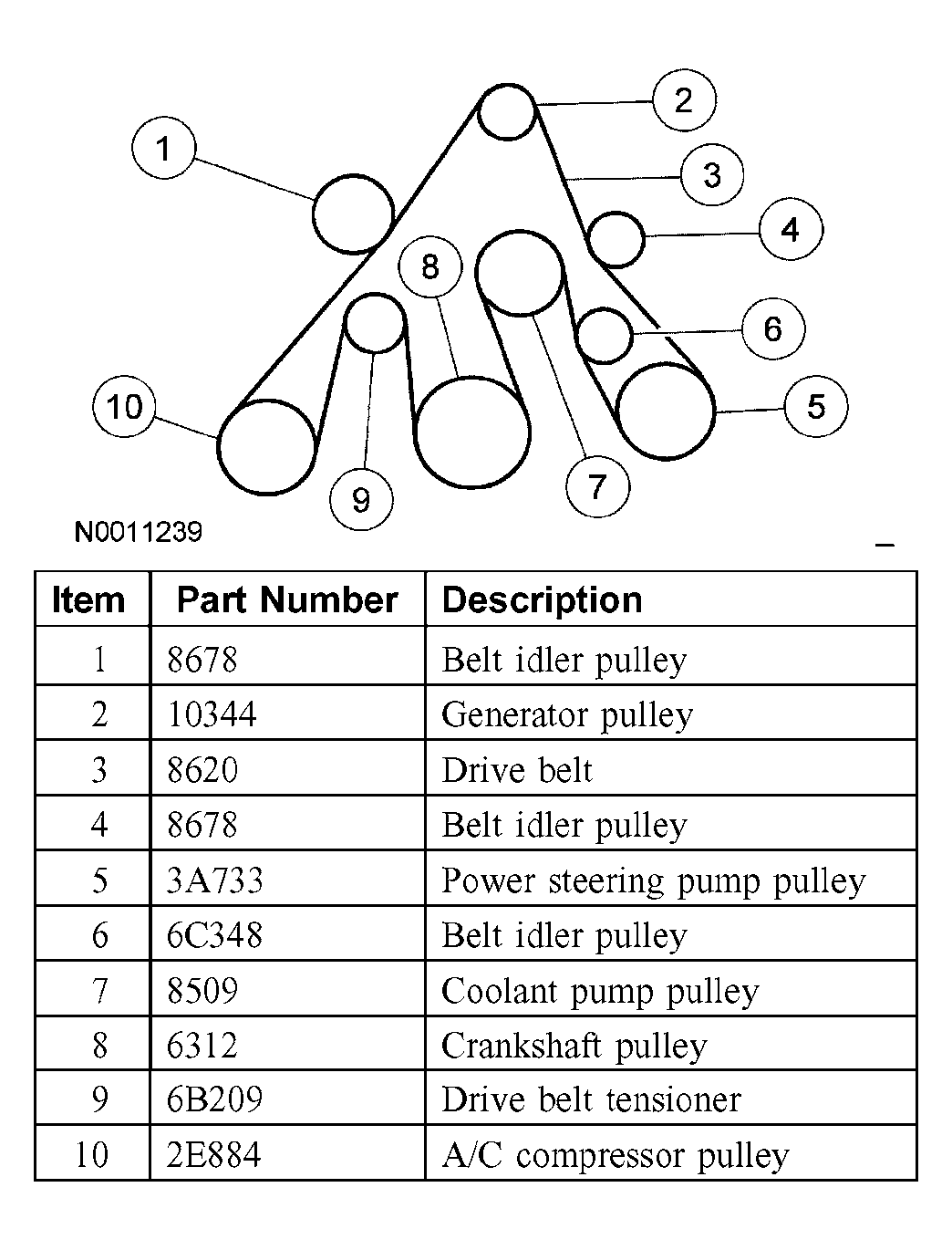

I need to know how to routing the belt for a 2005 5.4 engine.
Jul 16, 2020 at 4:28 AM (Merged)
  • 75,992 POSTS
Here is a guide and the diagrams below so you can see how the job is done:

Pick your engine, the diagrams show where you release tension on the belt for removal/installation.
https://www.2carpros.com/diagrams/ford/pickup/2003

Hi, Before Taking Off the Belt Look For a decal On The Hood ,Or On Radiator Support. If No Decal ,You Can Find A Belt Routeing Picture Here.To Remove Belt .You Need May Need A 3/8 Drive rachet And Small Extension Or A 1/2 Rachet And Extension,Find The Belt Tensioner Put Rachet In Slot ,And Pull,One way To Loosen,Pull other way To tighten.TheTensioner Is Spring loaded So Wear gloves ,Be careful not to Slip Off.And injure Your Hand.Now Remove Belt .Install New belt As Per Drawing .If No decal .I Draw Picture Of all pulleys And Belt Before removing belt.You May Need To Put a small Pipe On The End Of Your Rachet To Get More Leverage.Some Of those Tensioners Have A Powerful spring.
