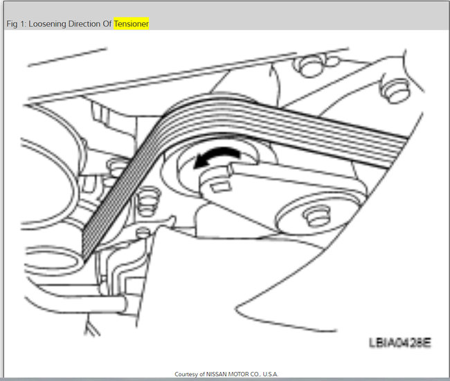

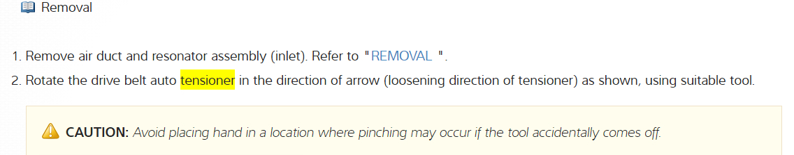

What happens with serpentine belt tensioners is over time they get bent or the spring inside of them gets weak. This allows the serpentine belt to come off due to misalignment. Here are a couple of helpful links:
https://www.2carpros.com/articles/how-a-serpentine-belt-tensioner-works
https://www.2carpros.com/articles/serpentine-belt-tensioner-replacement
I have included step by step instructions for your vehicle in the diagrams below. Installation is the reverse of removal.
