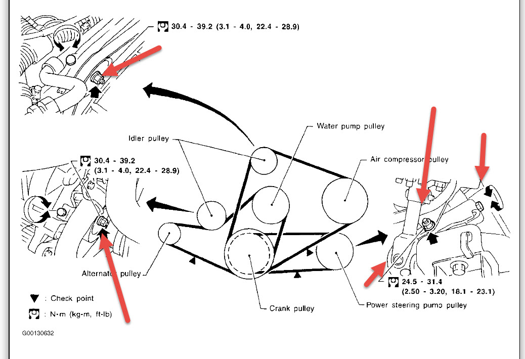

The belt broke. I how do I replace the serpentine belt?

picture shows where bolts are to loosen for each one. it depends which belt you are changing you need a belt tension gauge to set it. generator 189-208.

air conditioner 151-170 ft lbs all of them and ps 105-124. see picture for routing and which pulleys to loosen for each one.
