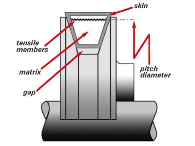

Two reasons a good belt brakes with proper tension generally are a pulley seizing or misalignment. Look for tell tale signs. Immediatly check the pullies it runs on after it brakes for a seized pulley. Temperature can allow a pulley return to a free state when it cools. Litle rubber dust particles may show on pulley area also. Alignment issues usually will show a glazing on the v-edges. Mis alignment is sometimes visable to the eye as the belt looks out of kilt when installed. Another form of mis alignment is within the belt to pulley fit. IF you take the belt and place it in the groove of the pulley it should fit properly. It should fit like this:
https://images.2carpros.com/forum/automotive_pictures/30961_mufp_0711_02_zengine_belt_fit_and_alignmentbelt_diagram_1.jpg
Nice and flush on the mating surfaces. Some aftermarket belts can be problems and the fix is a dealer belt.
