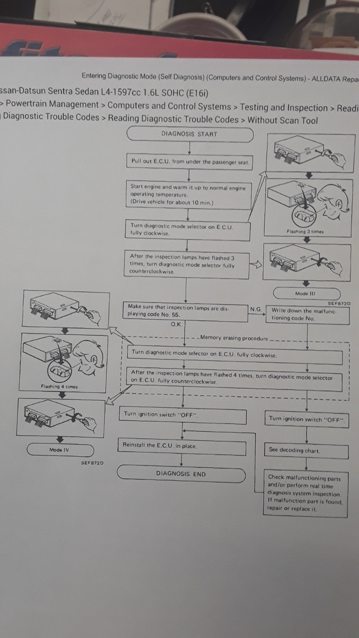

I tried this. After 4 blinks (which coincides with the Check motor light), I turned the screw all the way back counter clockwise. The description doesn't say which way to turn it (according to sources on the internet, it's clockwise first, get flashing lights, then back). Then it does nothing. No lights flash at all.

I had a guy send me a flow chart that says start car, let it warm up, go to mode 3, turn back counterclockwise get code 55 (which it does). After that, no other codes pop up. There's obviously something wrong with the car since 55 is no malfunction.

Code 55 means the computer considers the car to be okay. It sounds like the exhaust could be clogged here is a guide to help confirm the issue:

Just curious. Should the cars ECU be in mode 3 or 4, and should it be started or just have ignition on?

It should be in 3, 4 is for programming I believe. It sounds like the exhaust is leaking into the intake. Can you check the A.I.R. System to see if it is in good shape? Can you please shoot a quick video with your phone so we can see what's going on, that would be great. You can upload it here with your response.

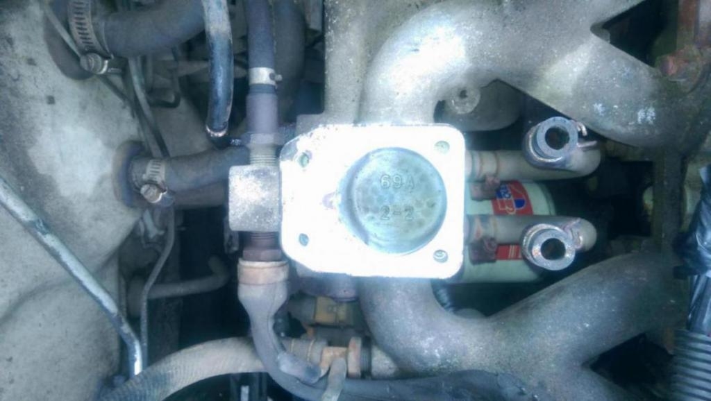

Ken,
I have a 3-4 minute video, but it's hard to tell with the cars going by in the background. Can't figure out how to upload it though (It says Filetype not allowed). I also found out that one of the small hoses (there are 2) from the throttle body to the intake/engine is leaking. Any idea what these hoses are or where I can find them? Been told they're heater hoses, coolant bypass hoses, throttle body hoses.
Thanks,
Chris

What kind of phone? Also for the hoses can you snap a pic and point to the hoses in question?

Ken, I got this picture from the internet of an e16i, 87 pulsar. These look just like the hoses I need. They're the ones just above the oil filter with the clamps on the ends. Those are the ends that connect with the throttle body. Thanks

Sounds good, let me know what happens.I don't know where to get those hoses. Will a regular hose work?

Possibly. I just don't know the i.D. Of the hose. The worry is that the curve will kink the hose. Nissan said it's formed but discontinued.

I was able to get the old hoses off(one was so bad you could tear it with your finger)and replace'em with regular small heater hose. It's slightly kinked but more than enough coolant is able to get through. I've noticed now when the radiator is full(50/50 mix), that the idle is pretty good, but as it warms up it drops down then gets a little rough. Still stalls some but not as much as before.

Good too hear, I would recheck for vacuum leaks and make sure the throttle bore is clean.
