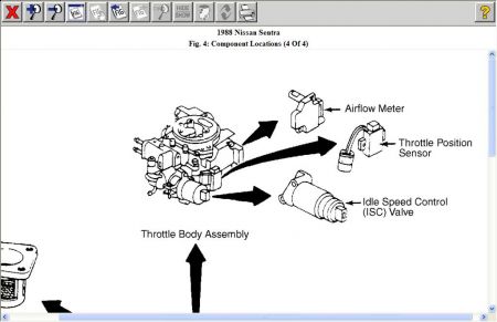

I have the same problem of the user in Rockport Texas. My sentra was put in the local Nissan dealership for the problems of stalling, hestations. At certain speeds it would stutter. Was told that the mass air flow sensor might be bad. Nissan doesn't make the part anymore. All of the systems on the car check out. I noticed that the owner in Rockport had theirs changed and no inmprovement. Checked for vacuum air leaks, fuel pump. Fuel induction cleaning was done by dealer as well as timing belt changed. Any help would be appreciated.

It sounds like the ignition coil is going out but to be sure lets run down this guide
https://www.2carpros.com/articles/engine-stalls
Check the fuel pressure, Test the airflow meter, idle speed control valve and throttle position sensor-
https://www.2carpros.com/forum/automotive_pictures/12900_sentra_88_1.jpg
