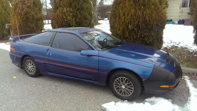

Seems like there is no spark.
DREINHA2
  • 1989 FORD PROBE
  • 2.2L
  • 4 CYL
  • FWD
  • MANUAL
  • 284,000 MILES
I had a ticking valve so I put some marvels in to see if it was just sludge or what not, I then drove it for about 3 miles when it lost power and died. Now it turns over but no spark, timing belt brand new. Th out it was a valve but they are fine. Distributor is good along with spark plugs and wires. Please help. Thank you

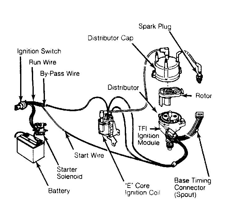

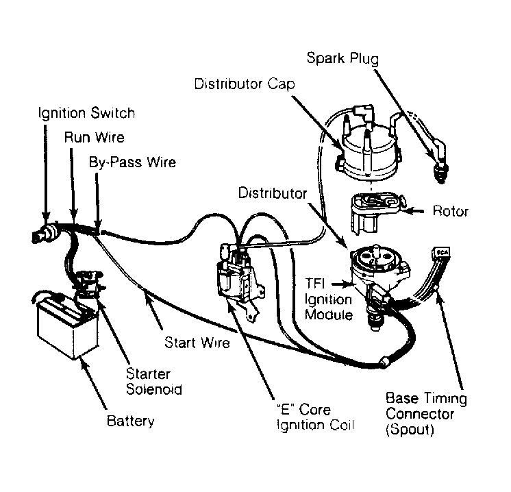

Vehicle Reference: IGNITION SYSTEM - TFI-IV
OPERATION
The TFI-IV distributor uses a Hall Effect switch mechanism to switch primary voltage and send a Profile Ignition Pickup (PIP) to the Electronic Control Assembly (ECA) and TFI module on 3.8L engines. On all models, the ECA uses PIP input signal to produce an output signal called SPOUT that is sent to the TFI ignition module to be used to trigger discharge of coil secondary voltage.
Secondary voltage is distributed through a conventional cap, rotor and spark plug wires.
Fig 1: TFI-IV "Closed Bowl" Ignition System (3.8L Engines)
-1

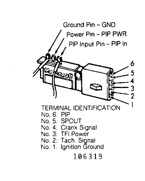

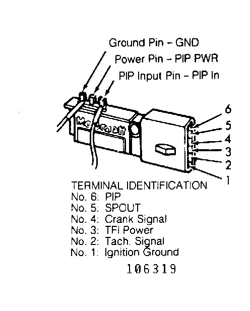

TESTING > TFI CONNECTOR VOLTAGE CHECK
Disconnect wiring harness connector from TFI module. Inspect connector for dirt, corrosion, or damage. Repair if necessary. Disconnect wire at "S" terminal of starter solenoid.
Attach negative voltmeter lead to distributor base. Measure voltage at battery. With negative lead of voltmeter still connected to distributor base, check voltages at TFI ignition module wiring harness terminals. See WIRING HARNESS TEST table. See Fig 1.
If all readings are at least 90% of battery voltage, replace TFI module. If any reading is less than 90% of battery voltage, inspect wiring harness and connectors. Also check for a worn or damaged ignition switch. Repair or replace as necessary.
WIRING HARNESS TEST
Connector Terminal No. Wire (Circuit) Ignition Switch Test Position
3 Run "RUN" or "START"
4 Start "START"
Fig 1: TFI Wiring Harness Connector

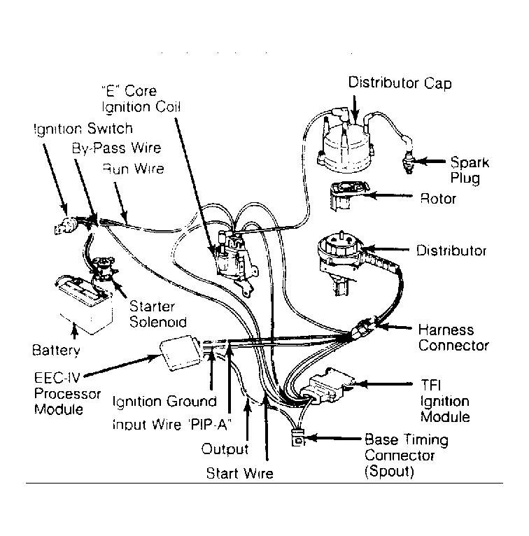

TESTING > IGNITION COIL & SECONDARY COIL WIRE
Substitute coil and coil wire with known good parts. Install Spark Tester (D81P-6666-A) between ignition coil wire and engine ground. Crank engine. Turn ignition off. If spark is present, determine if coil and/or secondary wire was cause of no spark,
replace part(s) as necessary.
TESTING > WIRING > All Others
Disconnect in-line connector near TFI module. Install Spark Tester (D81P-6666-A) between ignition coil wire and engine ground. Crank engine. Turn ignition off. If spark was present, check PIP and ignition ground wires for continuity. Service wiring as necessary. If wires are okay, see appropriate EEC-IV article in COMPUTERIZED ENGINE CONTROL section listed below. If spark was not present, go to IGNITION COIL SUPPLY VOLTAGE test.
