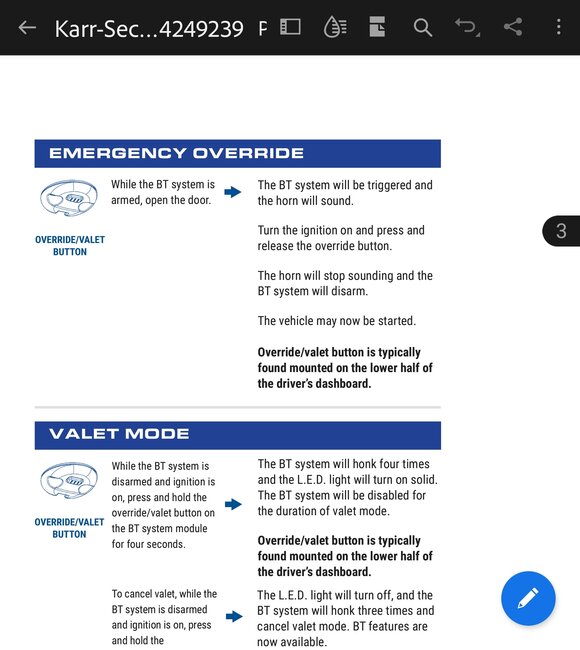

I replaced my battery and now my car won't start. I'm trying to reset the immobilizer or anti-theft features.

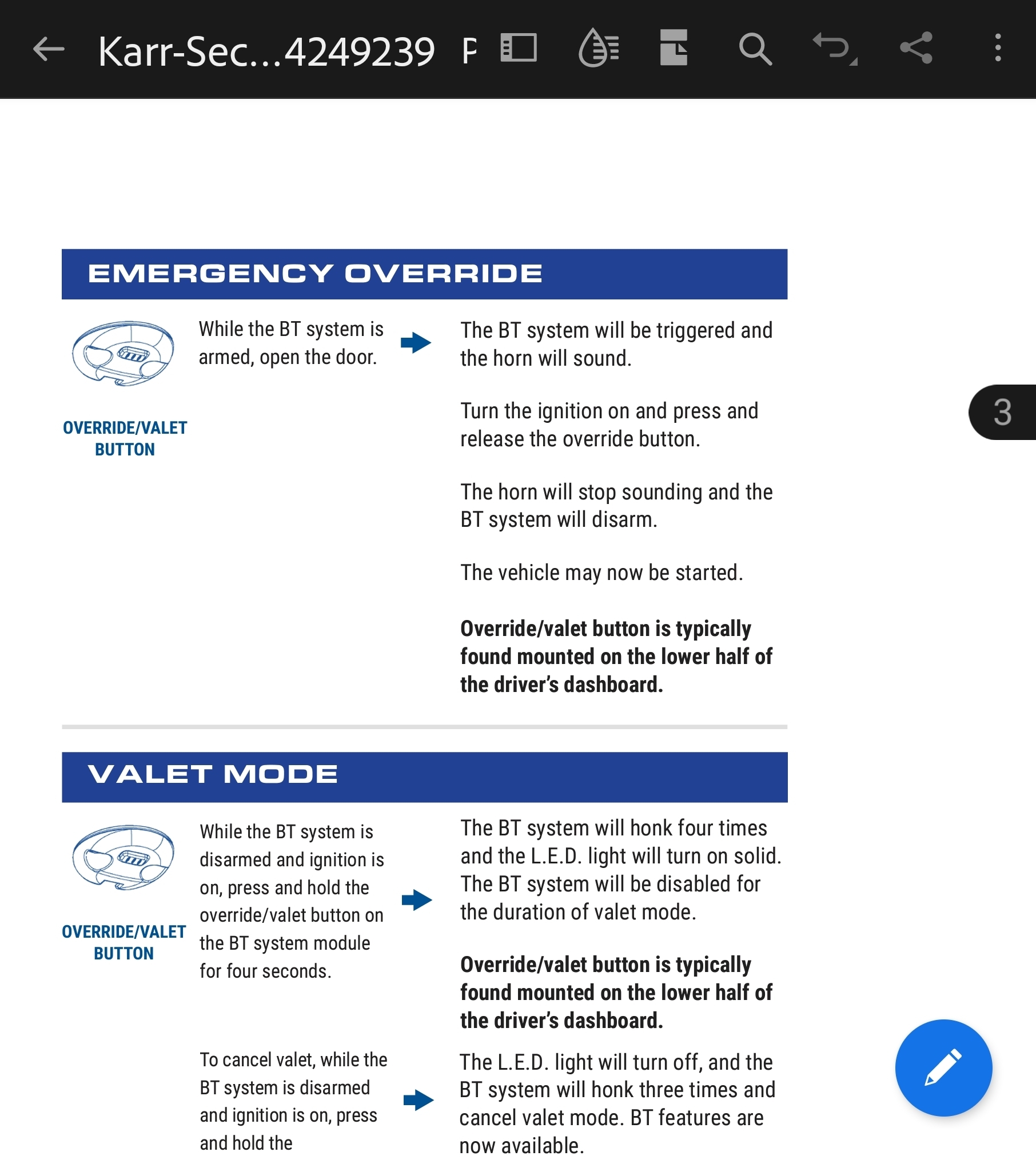

Hi, does your vehicle have the KARR alarm system? If it does, the override button is on the lower panel on the driver's side. See snapshot of instructions below. Hope this info helps. I had that issue with my wife's Honda Fit. I had to manually override with that button.
