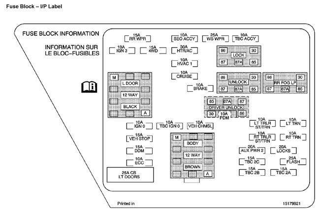

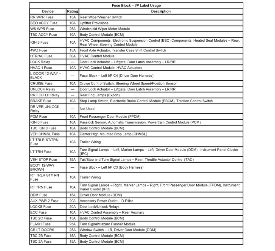

Both driver and passenger power seats stopped working. heated seats don't work either and I can't find the relay for the seats. I need some help.
Mar 23, 2021 at 5:22 AM
  • 55,433 POSTS

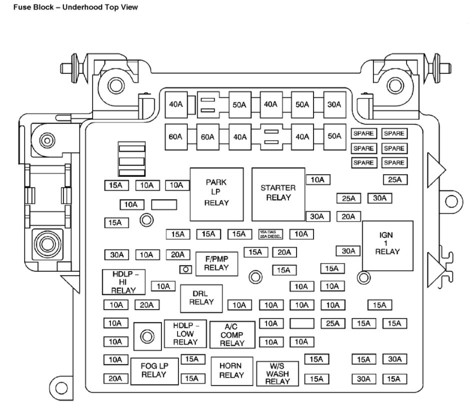

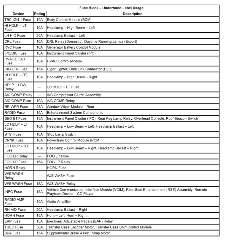

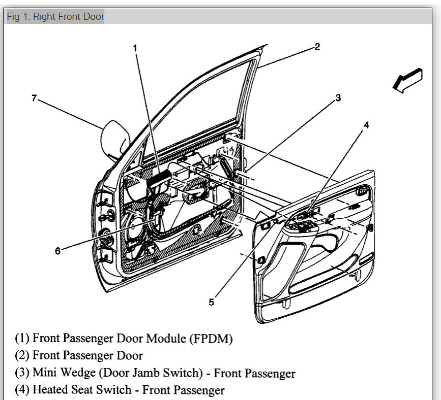

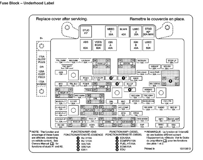

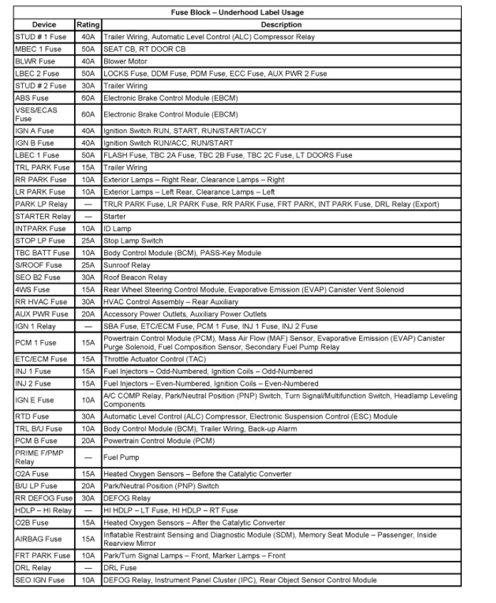

Lets start by checking all fuses. this guide will help with the fuse locations in the diagrams below. if all fuses are good chances are the passenger door module has gone out. I have included the instructions to replace it was well. Test the fuses with the key on.
After passenger door module (PDM)/switch assembly replacement, the following procedures must be performed in the order that they appear for the tire pressure monitor (TPM) System to function properly. The PDM also requires keyless entry transmitter programming after replacement. Refer to Transmitter Programming in Keyless Entry.
