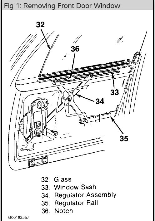

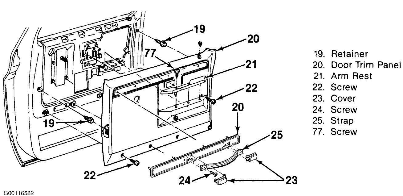

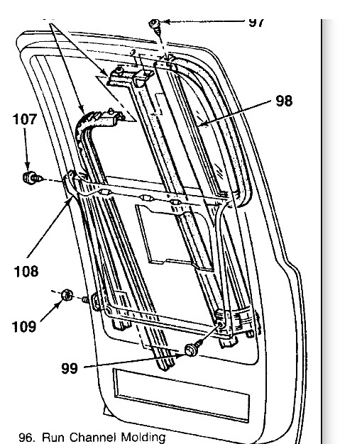

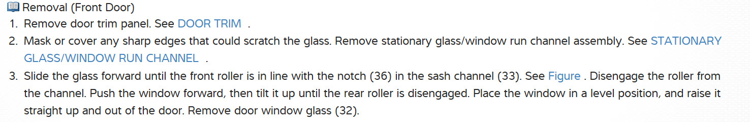

My driver's side passenger window got shattered. how do i replace it and with what other model cars are compatible?

see pictures for removal install is mostly reverse of removal. you can get one from a junkyard probably cheapest. if window has to be glued back into channel use rtv with window rolled up and leave for at least twenty four hours in that position.
