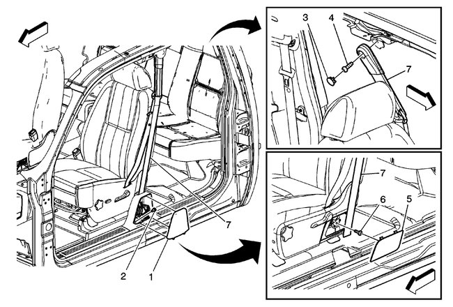

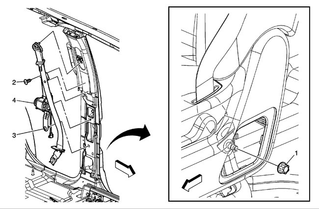

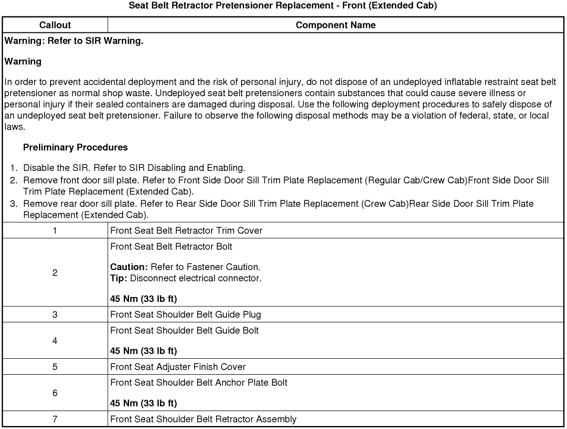

How do I remove the driver's side (front seat) side seat belt on the front seat?
May 17, 2018 at 2:48 AM
STEVE W.
  • 15,350 POSTS

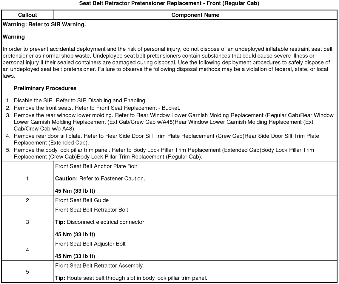

The first step in some states is to be sure you can get replacements. Because these use an explosive charge like an airbag on the pre-tensioners that hooks into the restraint system some places are a pain about letting the average person buy them, even from a GM dealer. Because of that the prices are ridiculous and it ends up actually being cheaper in many cases to have them replace them.
If the reason for replacement was an accident you will want to check the other belts as well to be sure they did not deploy.
The book warning - Some countries, states or localities may not allow service deployment of airbags without special permission or training. Local laws regarding deploying and scrapping of airbags/devices with pyrotechnics must be followed.
Also, once you can secure the replacements you need to dispose of the old ones properly. My usual method is to return the old ones to a dealer and let them deal with them.
Now if you are not in a nanny state the process starts by disarming the airbag system. This is simple, you remove the negative battery cable and place it so it cannot touch the post, then wait about five minutes before you start working on the belt.

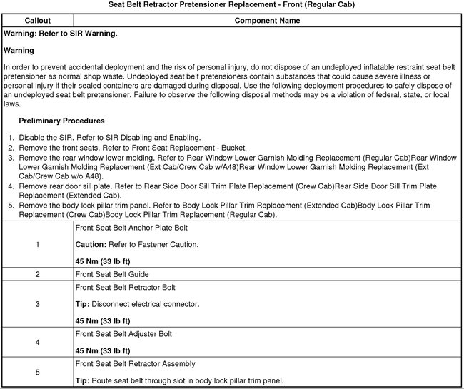

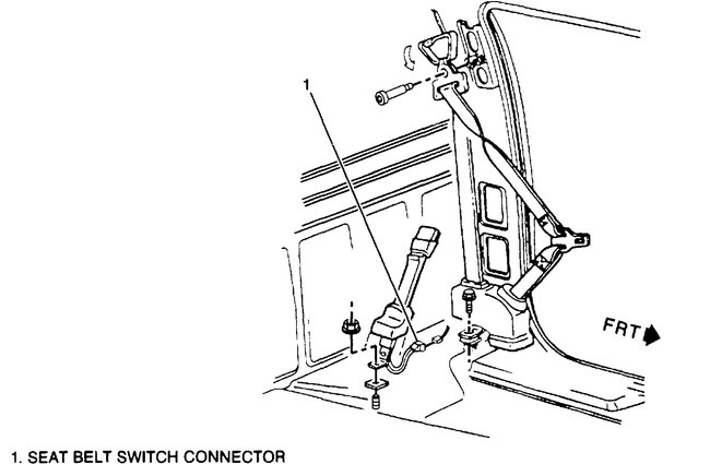

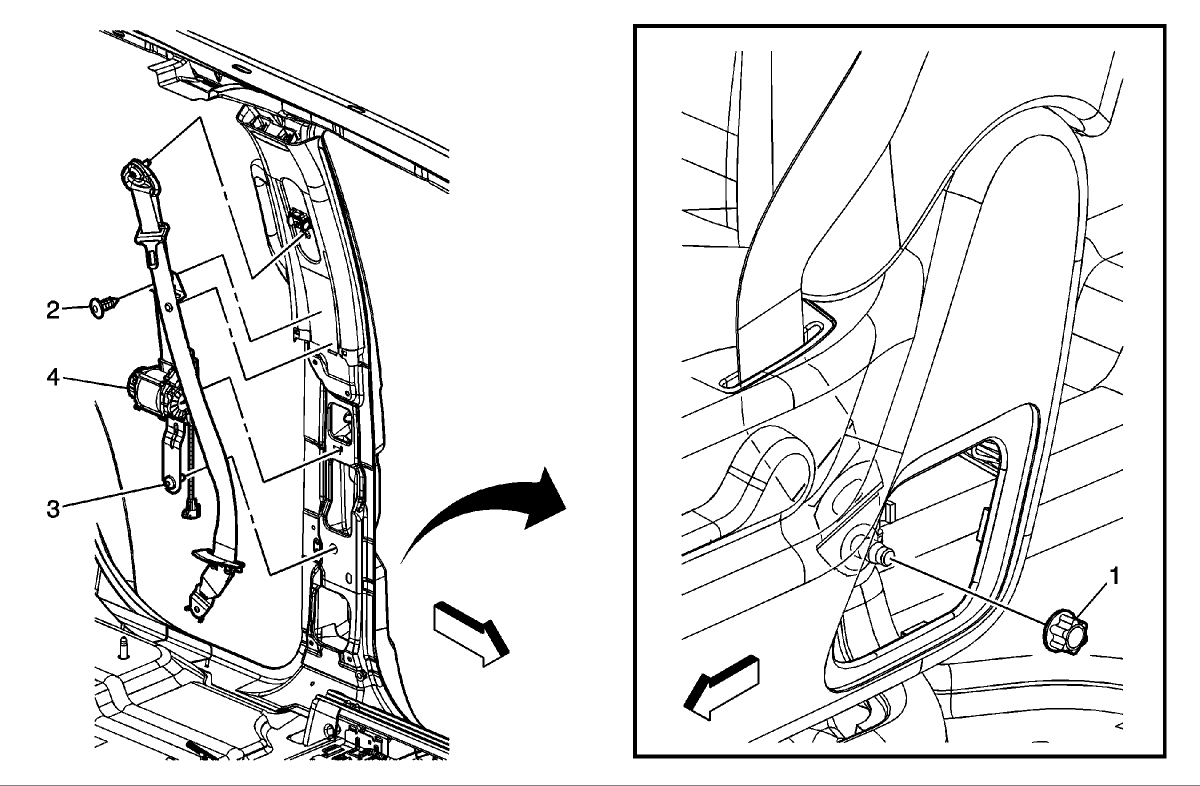

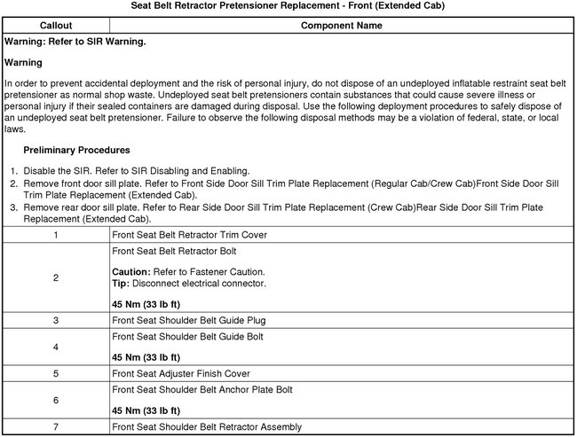

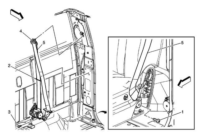

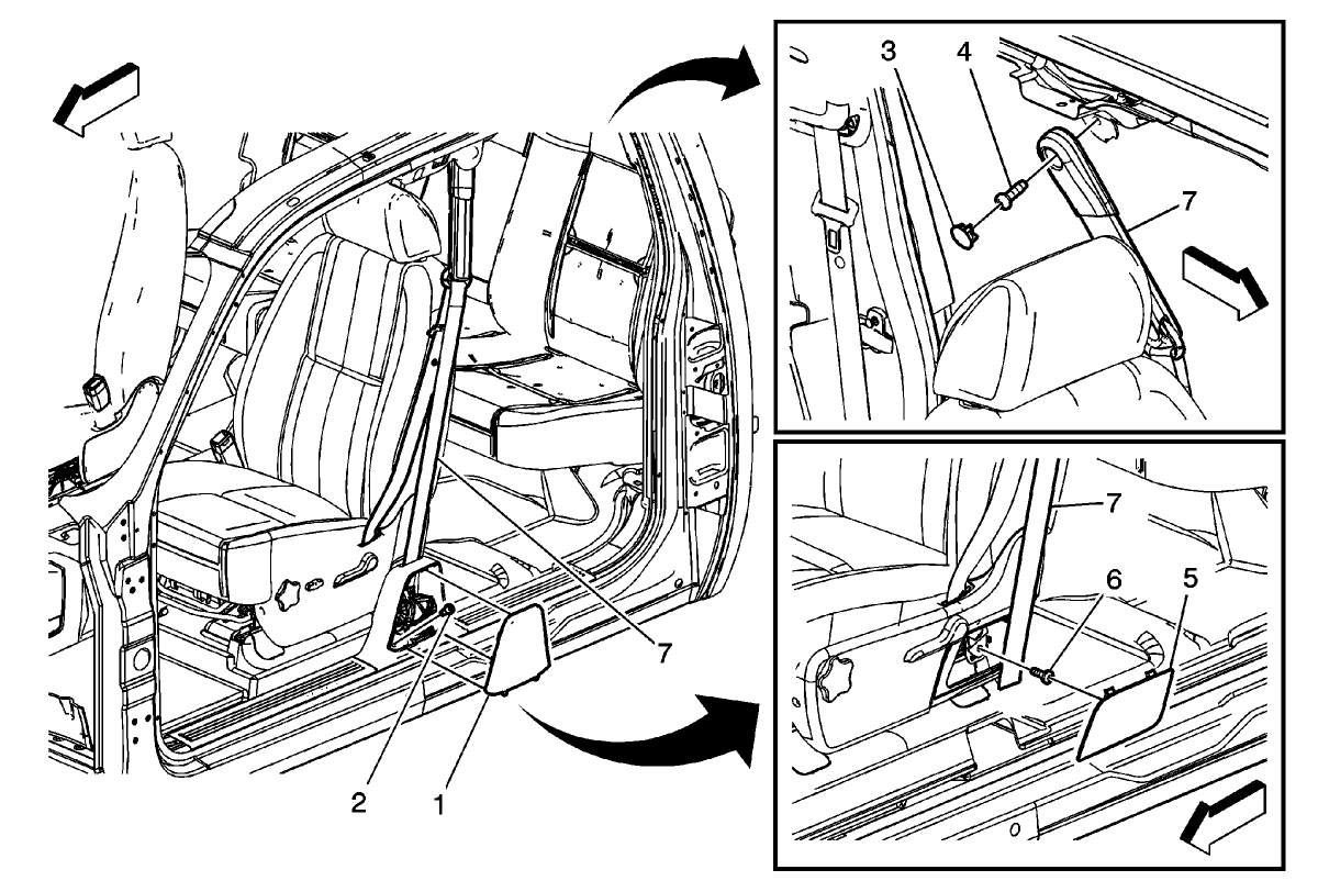

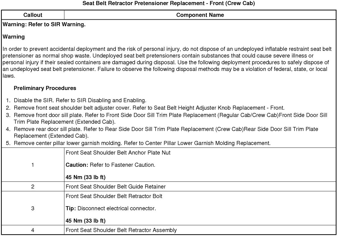

The next steps depend on which cab style you have. They are laid out in the attached images. The first two are regular cab, the next two are extended cap and the last two are the crew cab versions.
Most of the trim snaps in place but it usually has an order to remove it. So once you look things over post back and we can follow up with more detail if needed.
You will need a large Torx bit to remove the bolts that hold the belts in. You will also want to clean the exposed ends of the bolts that go through the floor like the seats and lower belt bolts, plus spray them with some lubricant. They tend to come out hard most times. I will do that a day or two before if possible.

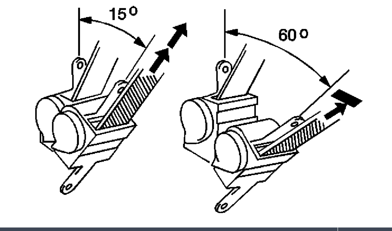

4.1. Remove the seat belt retractor assembly.
4.2. Tilt the seat belt retractor slowly.
4.3. Ensure that the seat belt webbing can be pulled from the retractor at an inclination of 15 degrees or less and cannot be pulled from the retractor at an inclination of 60 degrees or more.
4.4. If the seat belt retractor does not operate as described, replace the retractor assembly.

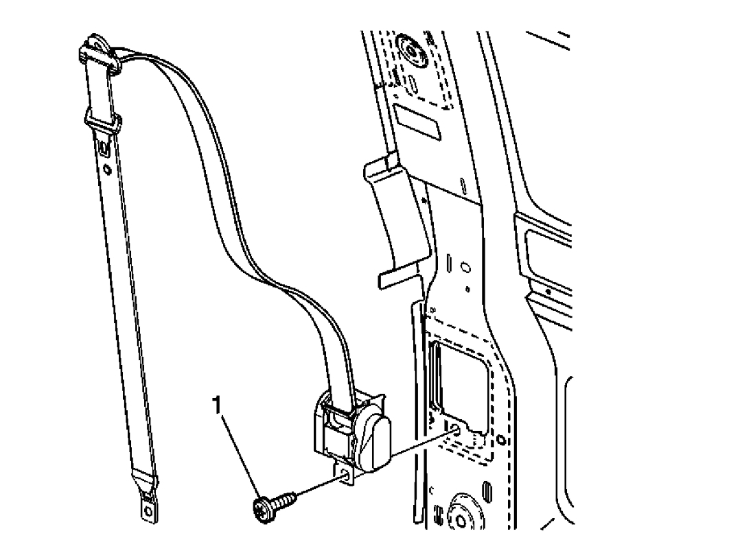

Removal Procedure
1. Remove the rear seat, if required.
2. Remove the rear quarter trim panel.
3. Remove the rear seat belt to body bolts.
4. Remove the rear seat belt retractor to body bolt (1).
5. Remove the retractor from the vehicle.
