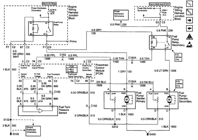

V8 two wheel drive automatic 60,000 miles.
I recently ran my truck into a ditch and when I pulled it out the fuel pump does not start. I took the bed off and when I got to the fuel pump there is no current going to it. Is there a manual reset for it?

Check and test the PCM B fuse 20 amp and the fuel pump relay. You do not have a reset button for the fuel system.

There is no reset button for the fuel pump.
Check the guides below on testing electrical, they will help
Attached below is the wiring diagram for your fuel pump

no, there is no inertia switch.
the system has a relay that has battery power and ignition power. it needs to be checked to verify powers. the oil pressure switch is a back up when the relay fails. it will have an extended crank time till oil pressure builds and will fire off the fuel pump. i think you need to check the pump for failure.
