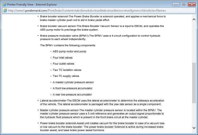

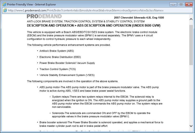

I posted how the abs etc operates I don't see a pedal position sensor on that system you can read the parts in the system in the info I posted.As far as the brake sensing there is a brake switch on the brake pedal.The best thing to do is to read the codes on the abs/traction control computers.Thats the first thing I would do if I had it in front of me the codes would give us a trouble tree and direction to go.Plus we could research the codes maybe your brake booster is leaking vacuum when you step on the brakes.I have seen that happen before.We really need those code numbers to help figure out the problem.Also how far does the brake pedal have to move before the brake lights come on?ALso there is a brake pressure sensor that shows how much pressure is coming from the master cylinder.Will all those lights come on and the traction control kick in under normal braking and not just lightly applying the brakes?Also cant tell if one of the speed sensors might be bad since we don't have the codes to see if were leading towards that direction.
