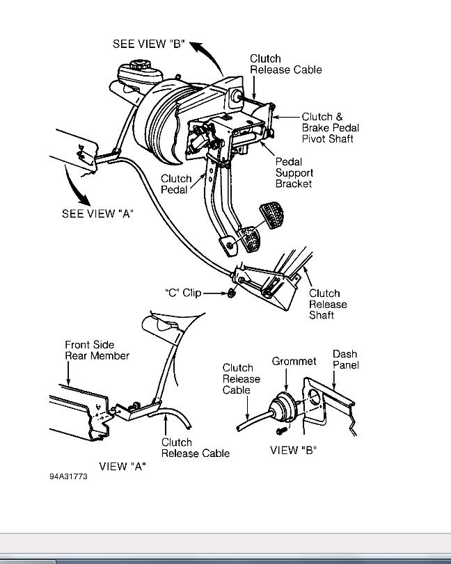

My husbands ford mustang needed a new clutch cable put on his car and he decided to install it his self, once he had installed it everything seemed to run and sound fine again until he decided to test drive it a little further down the road and into town. Once close to town it begin to make a screaming screeching noise and by the time he turned around in town and headed back he pulled back into the driveway the noise was 10X louder. Now when he starts the car and pushes on the clutch the noise is unbearable. It was not doing this until he install the new clutch cable. He has tried to adjust the clutch cable and the car continues to make this noise, what could this be and how can he his self fix this problem? He can't figure out why it is now acting like this. Is it the new clutch cable?
Feb 20, 2014 at 9:34 PM
HMAC300
  • 48,601 POSTS
could be the release bearing is shot due to the old cable being bad. there is no adjustment to the cable as the pedal is self adjusting so maybe the pedal assy is worn out. see pic on correct installation

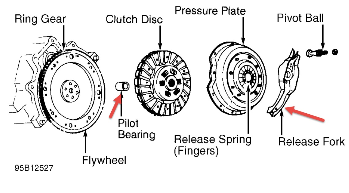

Thank you for your advice and the diagram although he did put a new pedal assy on. It has never made this noise before. When he pushes on the clutch and starts the engine the noise begins. He believes the noise is coming from the transmission. Could this mean he needs a new clutch,throw out bearing and pressure plate? Is there a diagram for that if that is even what the problem is?
Feb 20, 2014 at 11:49 PM
HMAC300
  • 48,601 POSTS
as I said in the first reply the release bearing (throw out bearing) is probably shot and this probably could use a new clutch as it was probably worn when the cable was wearing out. see pic where the arrow is pointing check fork for being bent/cracked as it cold be hitting clutch pressure plate. Also make sure the pilot bushing/bearing is lubed and not worn out. Also check input shaft of transmission for wear. see pic
