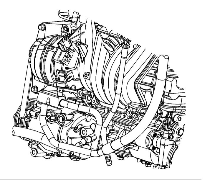

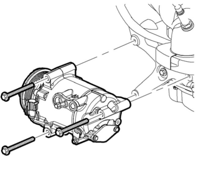

It sounds like you have a air conditioer compressor that is going out. When they go out the seal go bad which it sound like whats going on. Here is a guide to help you get the problem fixed by giving you an idea of what needs to happen.
https://www.2carpros.com/articles/replace-air-conditioner-compressor
and
Here is how to change the unit out in your car (below)
Please let us know what happens

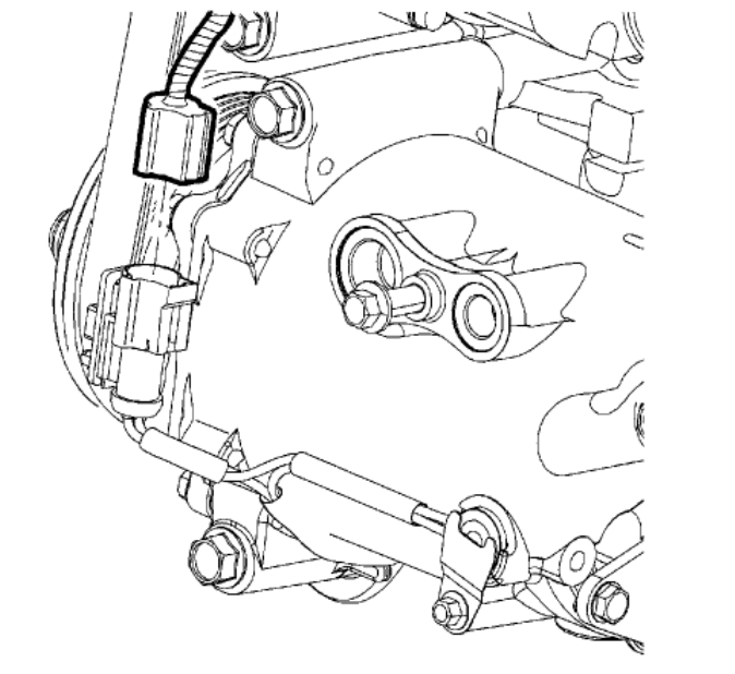

  • 55,432 POSTS
It does sound like the compressor is getting weak which is how they act when they are going out.

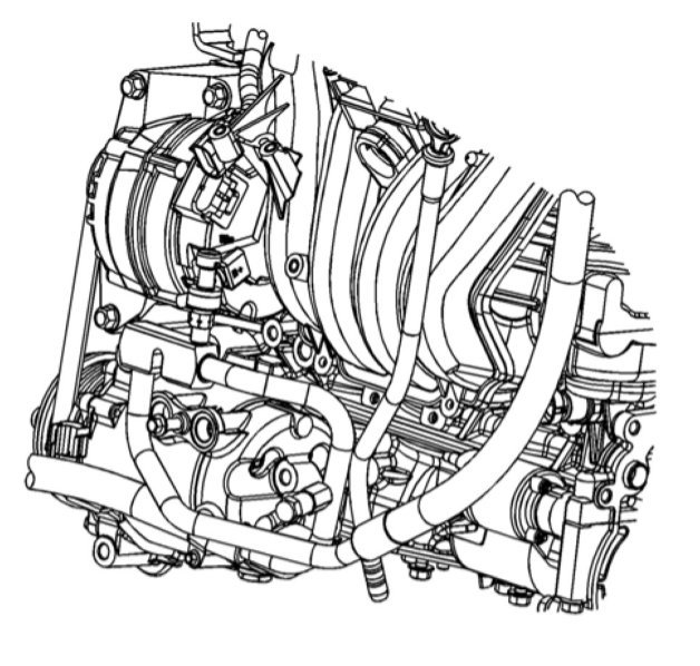

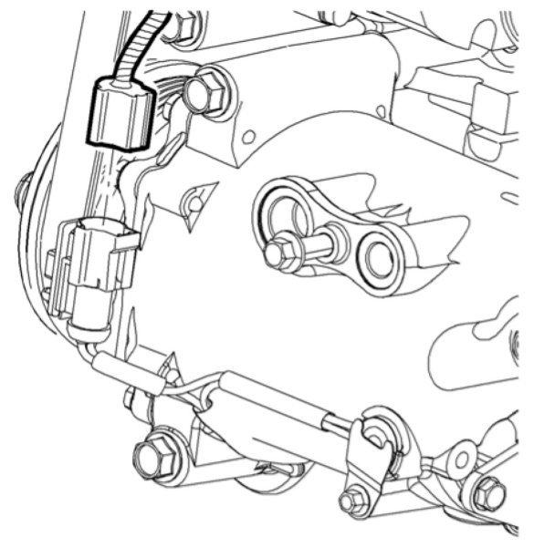

Here are a couple of guides that should help you get the job done and explain how the system works.
https://www.2carpros.com/articles/how-a-car-air-conditioner-works
and
and
Diagrams below:
Oct 14, 2017 at 4:37 AM (Merged)
