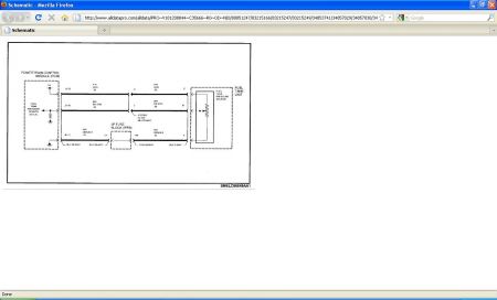

I have had this code since last winter when a chunk of pavement stretched my fuel line and snapped my evap line. I replaced the fuel line with High Pressure line and bridged the break in my evap line with another section of the same hose. it is sealed with silicone adhesive and hose clamps. I dropped the tank and all the connections there look and feel to be good. I just now replaced the EVAP solenoid. Initially I got an EGR error and the same P0452. After clearing the codes only the 0452 code came back. other than this code the car runs great. The only reason I am worried about it is that the car is up for inspection next month. Any suggestions that don't involve buying the $300 tubing bundle from Saturn to replace the repaired section?
Also, The Plugs, TPS and IAC have been recently replaced.
Sep 21, 2010 at 8:38 AM
SATURNTECH9
  • 30,869 POSTS

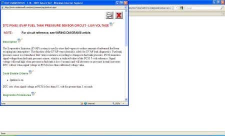

https://images.2carpros.com/forum/automotive_pictures/416332_2001_SL2_p0452_1.jpg
That code has nothing to do with a leak it say's that you have a reading of of less then .1 volt from the pressure sensor back to the pcm for greater then 3 second's.So i would be checking the connector and wiring to your pressure sensor.I also emailed you the info on that code.

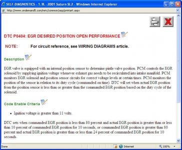

I am now also getting error P0405 and P0404 and a surging while I am driving. so in addition to the Evap system I probably have a bad O2 sensor or EGR problem. OH JOY!

https://images.2carpros.com/forum/automotive_pictures/416332_2001_SL2_code_P0404_1.jpg
That code P0452 is not caused by a leak it's caused by circuit issue,bad pressure sensor,or a bad pcm.Most likely it's a circuit issue.There are different code's you get for leak's so your barking up the wrong tree by looking for leak's.The P0404 is for most likely a sticking egr i would remove the egr valve and slowly push down the pintle till it bottom's out and then slowly take the screwdriver away from the pintle.See if the pintle closes all the way and doesn't stick.But from the surging and the code's it sound's like it's sticking.I also emailed you the info on the p0404.

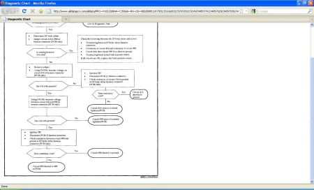

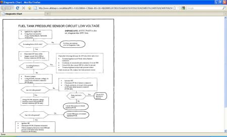

https://images.2carpros.com/forum/automotive_pictures/416332_2001_SL2_code_P0452_trouble_tree_part1_1.jpg
https://images.2carpros.com/forum/automotive_pictures/416332_2001_SL2_code_P0452_trouble_tree_part2_1.jpg
https://images.2carpros.com/forum/automotive_pictures/416332_2001_SL2_code_P0452_trouble_tree_part3_1.jpg
I posted the the trouble tree for your code P0452 and i emailed it to you also can you please show me where in the trouble tree they have you look for a leak?Let me know how you think a leak will cause the voltage reading to be so low on the fuel tank pressure sensor.I'm not trying to argue with you just trying to get you to understand what the code really mean's.Because there is a code for a large leak and a small leak if you had a leak you would have set one of those code's.

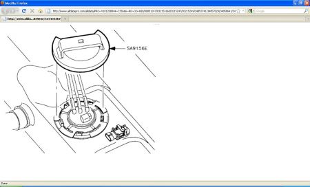

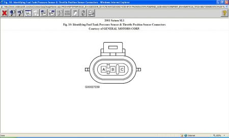

https://images.2carpros.com/forum/automotive_pictures/416332_2001_SL2_fuel_pressure_sensor_1.jpg
https://images.2carpros.com/forum/automotive_pictures/416332_2001_SL2_fuel_pressure_sensor_connector_1.jpg
It's not some sensor your looking for a problem with it's the the fuel pressure sensor and wire's your looking for a problem with.It's on top of the gas tank.You need to read the info i sent you it tells you that's what your looking for.I thought you were reading the stuff i sent you no wonder your looking for a leak.I posted a diagram that show's you the sensor location you can see it next to the fuel pump.I also posted the pressure sensor connector it show's which terminal letter is which.When you drop the tank down turn the key to the run position and your terminal c to the pressure sensor should have 5 volt's to it.When you get the tank down let me know and what you find also check terminal tightness.You will have more to check when the tank is down.

I checked and I have 4.98 v at both color coded terminals. I am assuming that the white wire (terminal A) is ground. from what you have told me this should not be the case. these wires must be contacting somewhere? One should be a signal from the computer at 5v to the sensor and the other should be the return signal from the sensor to the computer?

Turn the key off and see if those two wire's that have the 4.98 volt's have continuity between them use a multimeter on low ohm scale like 200 ohm scale.

Had continuity between terminal A & B with key off. also had continuity between A (orange and black)and body (makes sense, think that is the ground) and B (green) and body. Could not find a break in the harness but after moving the harness and testing at the junction block by the kick pannel I now do not have continuity and I do still have 4.98 on terminal C (grey). when contacting A & B or B & body I get a fluctuating #, not O.L for continuity. being I can not find a break and the orange & black does not go all the way forward I would think I could just abandon the existing wire, reground terminal A to the body and run a new green wire from the junction block. I will wait for a response before I burn out the computer or something.

All three of them shouldn't be connected to each other at all.Terminal A is grounded thru the computer and you shouldn't ground that to the body.Terminal B is your return wire for the pressure sensor circuit and terminal c is your 5 volt feed.It sound's like your terminal A and B where connected together some where and when you moved the wire's around they got discounted.That would explain the code setting.I would make sure those wire's aren't connected anymore and see if you can find where they were connected and go from there.

The orange and black wire goes from the sensor to the gray 68 way connector on the back side of the inside fuse box and come's out of the black 68 way to the computer.That's what i see in the wire diagram i have the wire color stay's the same color the way thru the circuit..I doubt the sensor was damaged from the wire's touching.That's up to you if you want to change it for good measure.If you do decide to change the sensor let me know and i will help you find a good price on one.

I traced all the wires and could not find a break anywhere. I disconnected the wires from the computer and jumpered the gound to the other two wires one after another (after ensuring I had a good ground with the computer disconnected) to verify that I was working with the correct wires by the fuse block. removed jumper, reconnected plugs to computer and ran a new green wire. checked voltage at Terminal C. 4.98, B nothing, A ground. Reinstalled the gas tank and started the car. Ran for about 30 seconds and the check engine light came on. I will get the reader this weekend and verify it is the same code but I am sure it is.

What you really need is to find is a scan tool that will read live engine data that read's the voltage of your fuel tank pressure sensor so we can see what is going on there.If the wire's are squared away the only thing left is the sensor or the computer.Let me know what code you have now.

Return voltage to computer (green wire) was 1.5 with about 2 gallons in the tank and was 1.48 after filling the tank then driving about 40 miles. ( the tank is still basically full.
voltage to grey wire maintained 4.98 regardless of time it was checked. orange/black is still a good ground signal.
Oct 2, 2010 at 8:13 AM
SATURNTECH9
  • 30,869 POSTS
The return voltage is what the computer read's with no pressure in the tank gas cap off it should read 1.2-1.5 volt's that is a normal reading.So far so good sounds like with those reading's.

The fuel level has no bearing on the pressure sensor reading.What effect's the reading is the vacuum level in the gas tank.If your going to throw a computer at it please don't spend all that money on a new one get a used one there a lot cheaper and already programed.You could probably find one for like 50 i would go for a used one if it was my car.The computer's hardly ever fail on those car's.
