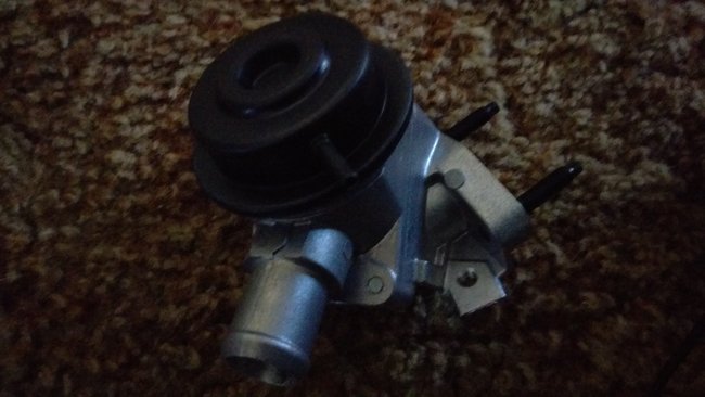

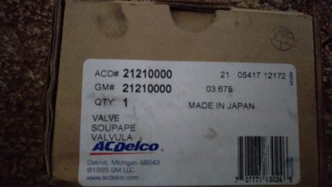

SATURNTECH9
  • 30,869 POSTS
There is a picture of the part is that the one that is bad?Also I took a picture of the part number if you type that into the part number box on rock auto dot com.Also try eBay use the part number in the search box.
Sep 23, 2016 at 5:37 PM
BLUEISMYCOLOR
  • 54 POSTS
That is the part. Had it tested again to make sure and it tested good. This is Jillian9 me ... I just have no clue.
Sep 23, 2016 at 8:02 PM
