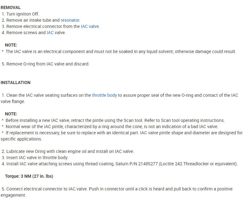

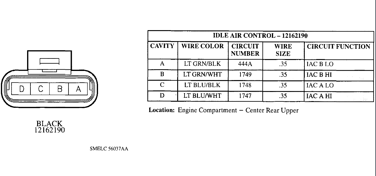

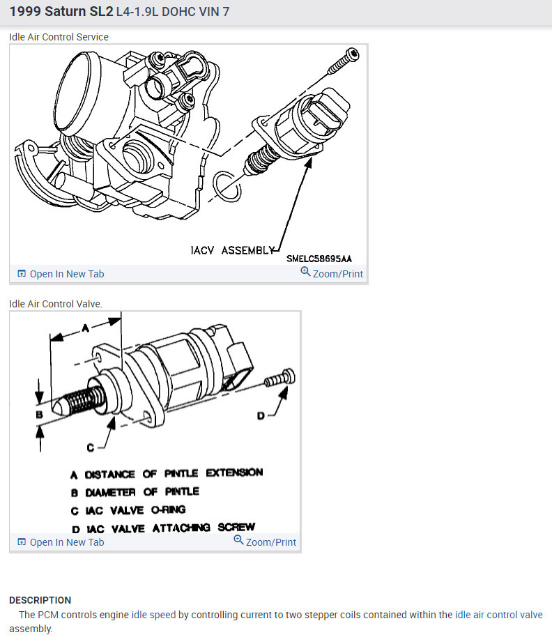

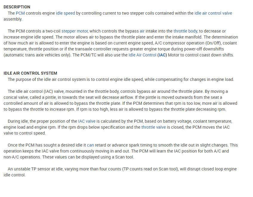

For the high idle, it sounds like you might have an issue with the Idle air control valve.
Many times if the IAC valve is dirty it can have an impact on the idle of the engine.
You can take the valve off and clean it. Usually that takes care of the issue.
Here are couple of helpful articles on how to clean the valve:
https://www.2carpros.com/articles/how-a-idle-air-control-valve-works
https://www.2carpros.com/articles/idle-air-control-valve-service
I have attached the diagrams for IAC valve.

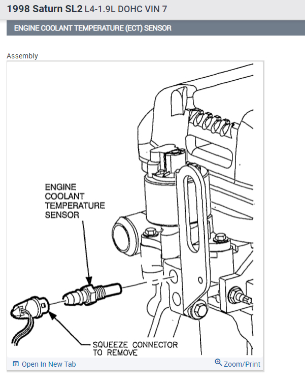

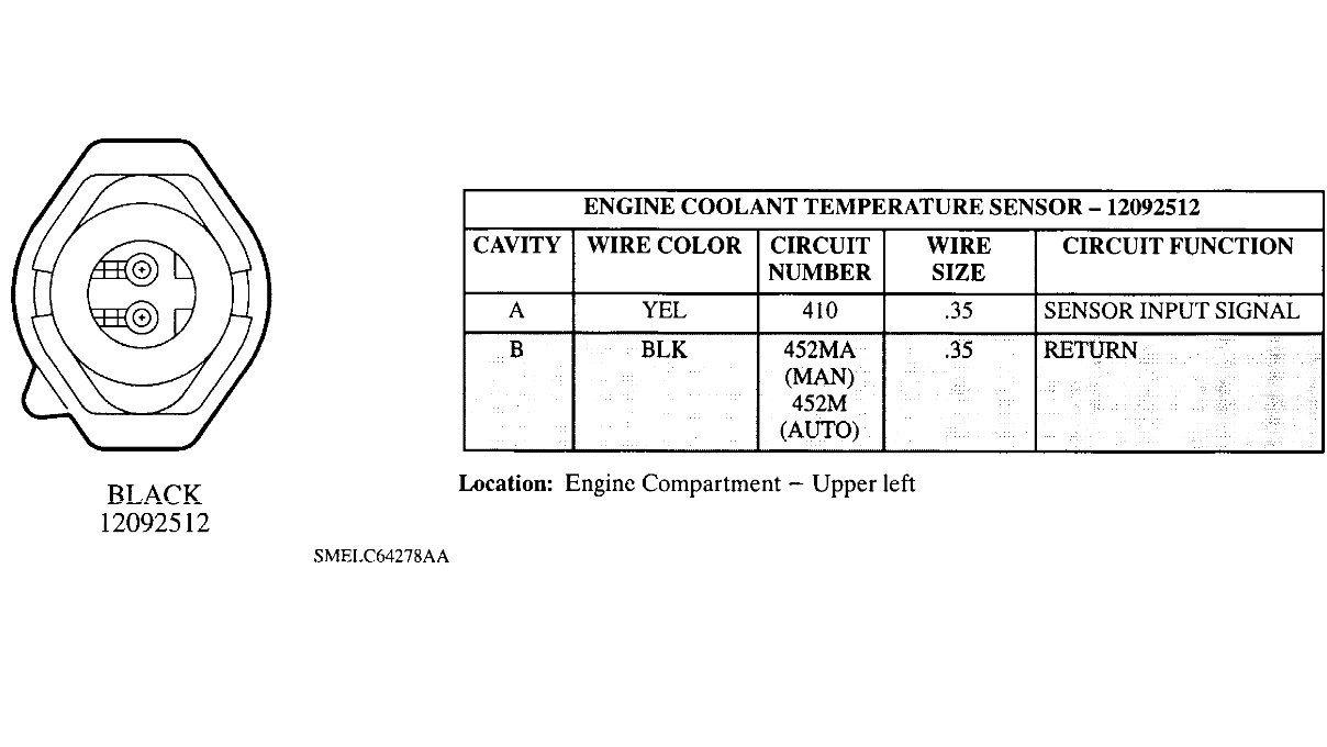

For the fan motor not coming on, so you have already checked the verified the fan is good as well as the relay is good?
You could have an issue with the coolant temperature sensor that signals the fan to turn on.
Look below for the diagrams.
